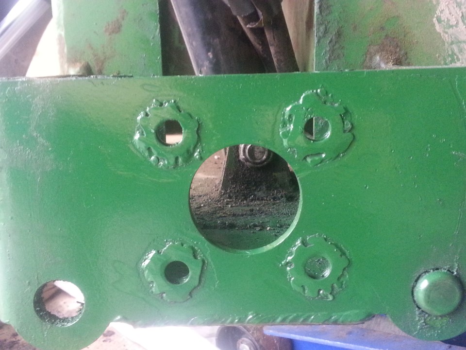

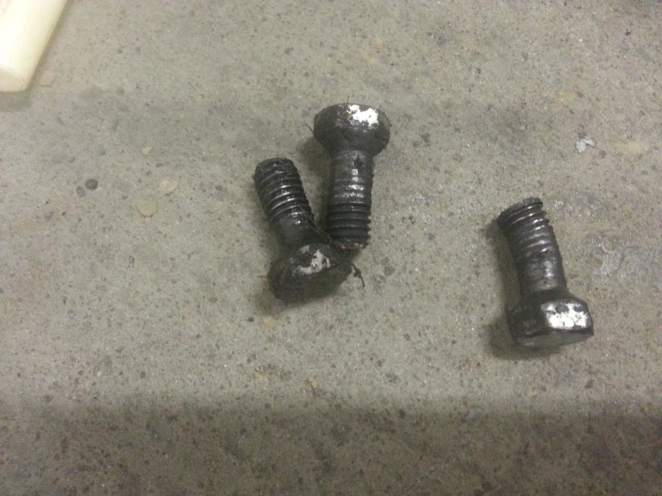

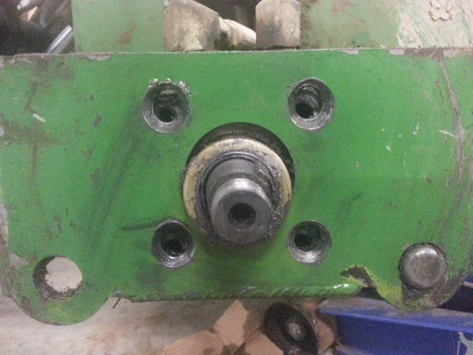

My '06 PT422's front driver side wheel motor has had a slight leak for a few years now. I ordered a rebuild kit (p/n 200222001B) on ebay, but hadn't installed it yet. I've been moving a lot of dirt/rocks over the last few weeks, and noticed the wheel wobbling when driving on Monday night. I pulled it off and found the motor mounting bolts had loosened and wallowed out the holes. Based on the damage to the hub and motor box, I believe the bolts have been slowly loosening over time and may have been the reason for the leak (more torquing on the motor shaft as it moves around inside the box). Otherwise, it is just a coincidence that the leaky motor is the same one that came loose.
I rebuilt the motor on Tues night. I filled the motor with oil prior to reassembly. To remove the hub, I heated it with a torch, placed a large crow bar behind it and hit the motor shaft from the front with a mallet. This worked well because the motor was able to move backwards due to being loose. Yesterday, I "ugly" welded on some washers to add support to the wallowed out holes. (Side note: I'd really like to get a new welder... my cheap HF has paid for itself a few time over, but I borrowed a friend's Lincoln for some exhaust work on my Jeep, and it was night and day difference!) I drove the PT around last night and the fix seems to be working fine (with no more leaks). Hopefully it holds up.
If you have a small leak in one of your motors, you might want to pull the wheel off and make sure the mounting bolts are snug to avoid further damage. Good luck!

Aren't those holes supposed to be tapered for the lug bolts? Does it really matter if they aren't anymore with the addition of the washers? Probably not. Just check em once in a while to make sure they stay tight.
   / Potential cause of your leaky wheel motor?
They may have been, but I'm using new "normal" grade 8 bolts now. I also used red loctite on the threads, and will be paranoid and constantly checking them from here on out.:reminder:
   / Potential cause of your leaky wheel motor? #6
Hmmm... Will you be able to ever get those bolts off if needed with red Loctite...? I would've been inclined to use blue Loctite...
Thanks for the posting,
Need to use heat with red loctite, which should be fine in this case (won't hurt the motor).
