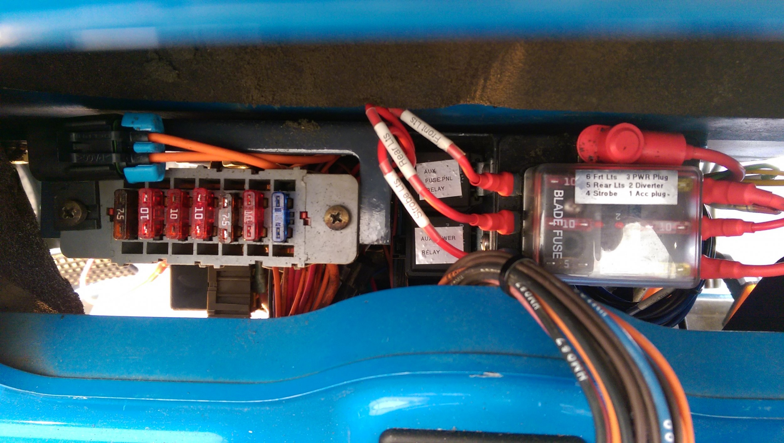

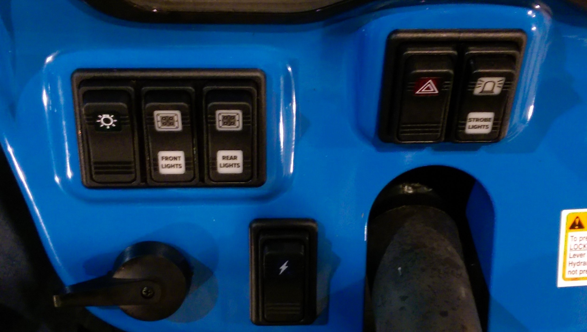

I checked & on our TC40D the Lamp / Headlight Switch is switch "ON & OFF" with the ignition key (double check on yours). That is an easy circuit to test... flip the switch with the tractor off... lol.. but it is also a pretty easy circuit yo get to... so you could use that one to activate your new relay. Depending on the build date it should be either fuse #3 or #4 on the TC40D so you can easily check it.
Oh, the Delay Timer I mentioned was added to the Auxiliary Fuse Box circuit. I installed it so that the circuits in that Fuse Box Circuits stay energized for 20mins after the tractor is turned off. The time starts counting down when the tractor is keyed off, at the end of the timer the entire Aux Fuse Block is disconnected from power. It is totally overkill but work really well... especially for the LED work lights; in the dark, it allows us to shutdown the tractor with the LED lights on, put key in pocket, fold the seat up, hit the starter kill circuit, etc, etc, then grab the flashlight for the walk back to the house.... then turn off the LED's... Again, Totally overkill...
Hope this helps... couple pics of my new Fuse location but might not work for you based on how your Cab wire was run...
