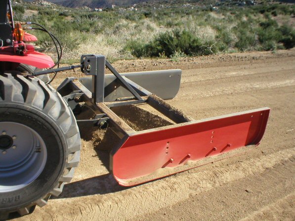

If you have much road or driveway that gets graded, I highly recommend a land plane grader blade as another very useful implement. A good size for the 4035 would be a nice 6 footer that weighs 800-1000lbs. It is almost unbelievable how well this type of implement works.
Do you know if you are going to mount new spool valves somewhere, or would you consider the diverter valve setup using the single OEM valve as the control valve? Just to let you know, I am now selling both the spool valves and diverter valves. Decide what type you want and let me quote you on them.

Brian, dunno which setup to use, mainly 'cause I really don't know enough about hydraulics (yet) to know which is best...the grader is cool, but I only have about 200 yards of drive...I will be looking for a Danuser post driver later on though...and want to fab a hydraulic chainsaw (long remote operated pole saw setup)...
