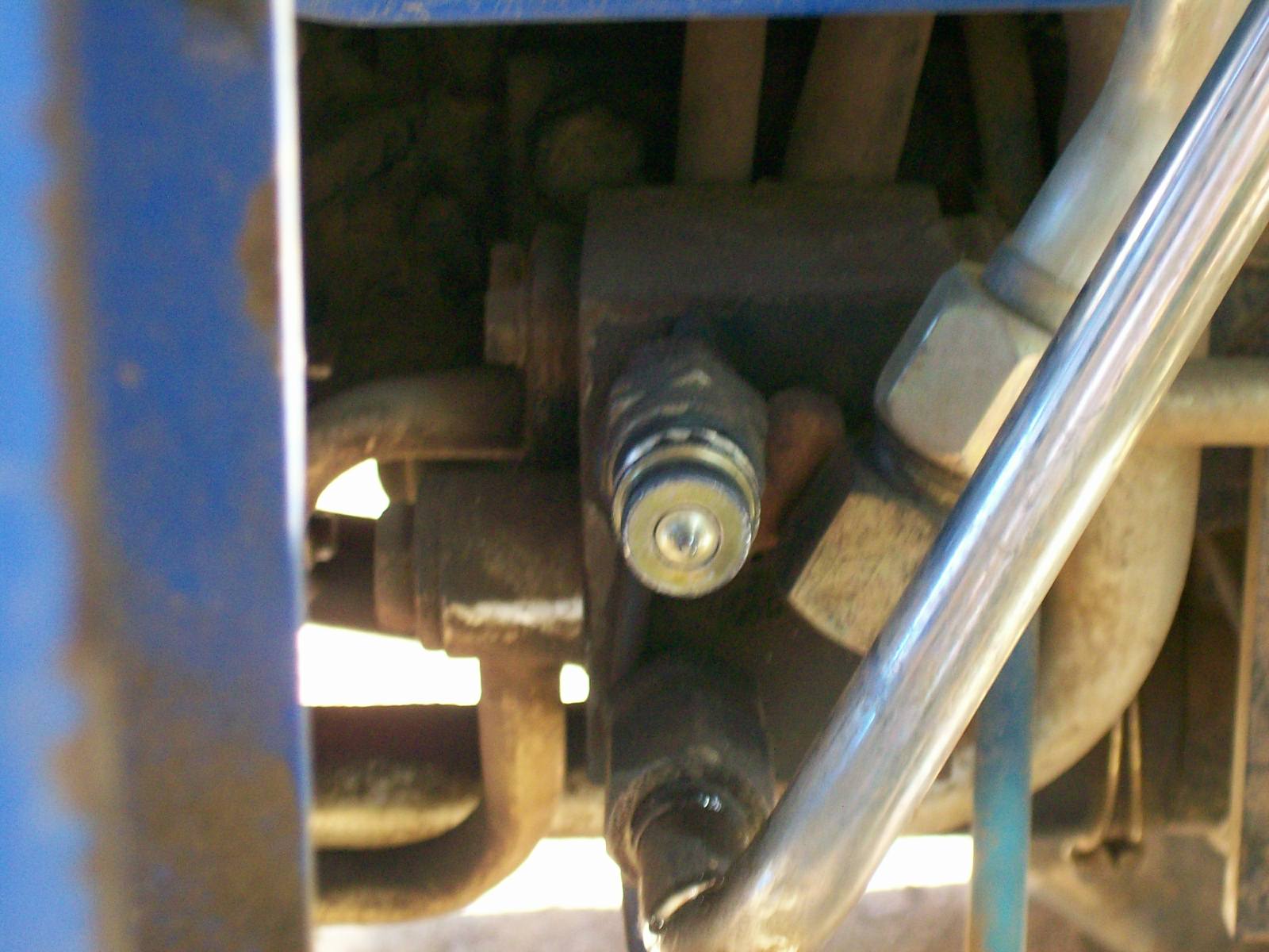

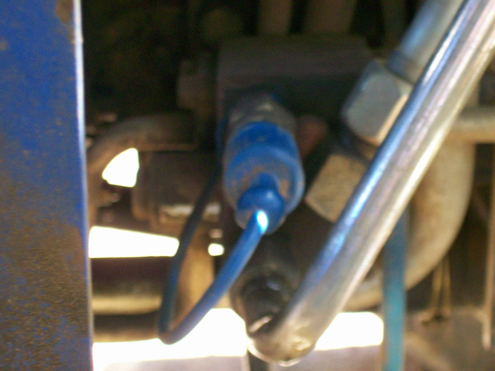

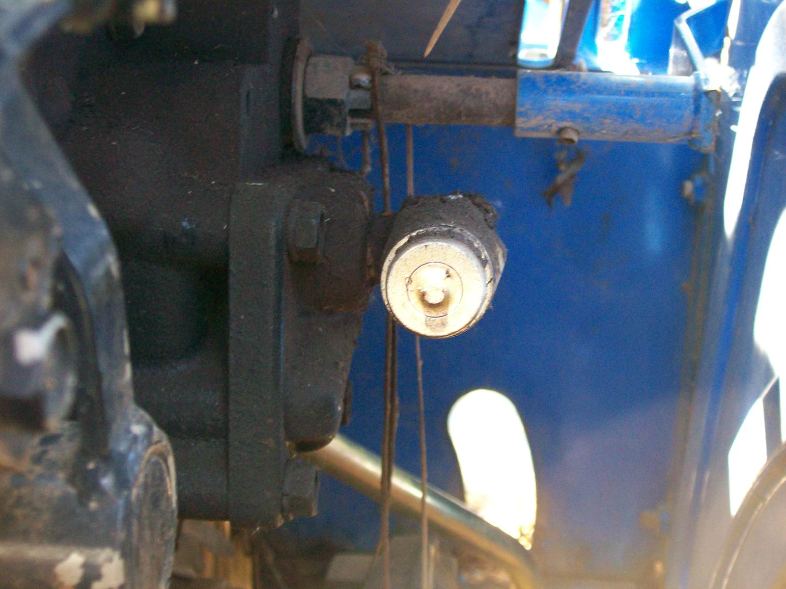

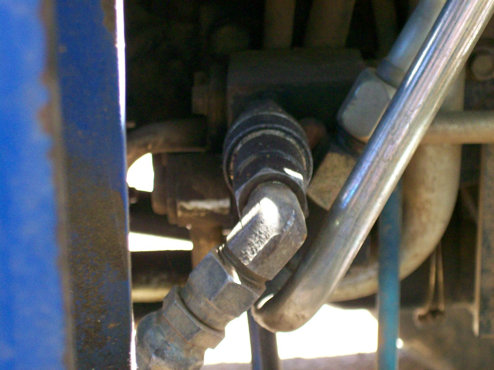

Same backhoe on a tc 30 . This is how NH installed mine . At Rear , under seat , were remotes would be located is just 1 fitting , A male Quick connect . Second hose from backhoe is long and goes up under tractor all the way to were hyd. lines come from engine and go up to F.E.L. . At that location is a short hose that comes back down from loader control block and just sort of loops around and connects to " Pump " or manifold ??? That line gets unplugged from " manifold / pump connection " ?? and connects to long hose from backhoe .
When I need to attach backhoe , with tractor not running , I connect female QC to plug in back , then long hose is connected to that line I unconnected from side of engine ( that line has a female QC on end thus male QC on long B.H. line plugs into it ) . When this is done it DISABLES 3 point system thus even if 3 point lever gets moved it does not damage B.H. or tractor as the lift arms don't move .
I am going out to take a couple of pictures .
Pic. 1 = Side of block were hose comes down from loader and connects to what ever that is you see there .
Pic. 2 = Same line disconnected from that block , that line would then be connected to long lie coming from Backhoe . and Pic. 3 shows Dust cap installed on that fitting on that " Manifold " .
Pic. 4 is Male QC were normally you would have remotes .
As I stated , This was done by N.H. Dealer at time of tractor purchase , So I imagine that it is a Far Cheaper route that buying remotes .
Fred H.

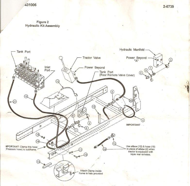

Here are the directions I received from my dealer when I installed my backhoe,
They cover the 757c Hoe. There was a kit to buy but is wasn't too expensive.
Good Luck, Bud
