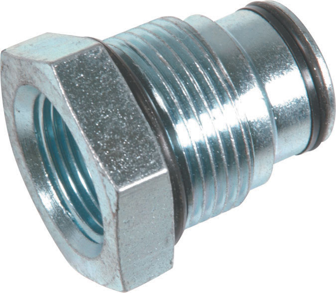

Can you show a picture of the valve.
PB port usually is in the center of the valve.
Your PB adapter will look something like this.
Either a PB adapter fitting, or a hex screw that is installed inside one of the ports.

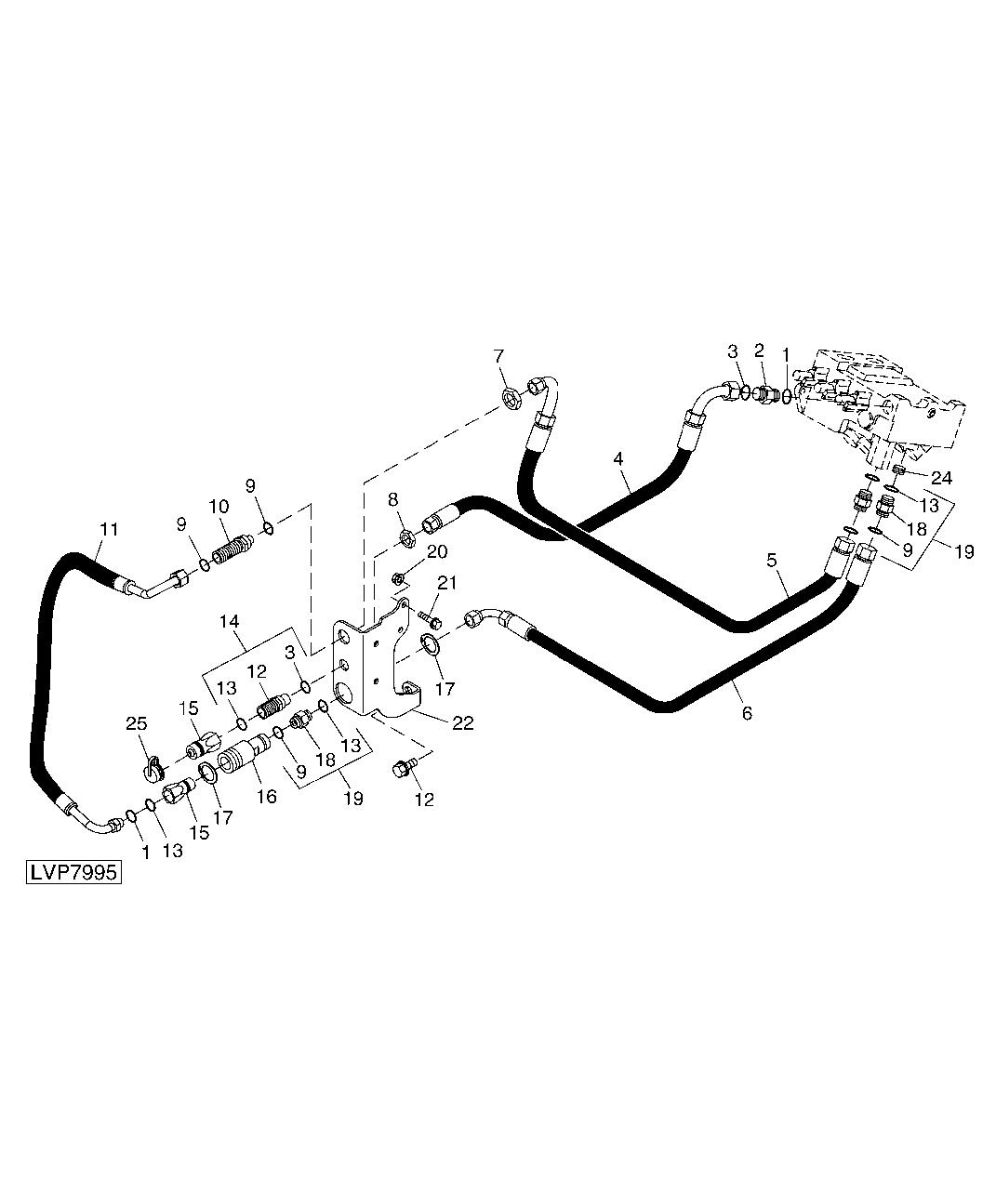

Drawing is PB for 5400. Maybe from the drawing JJ can tell which hose is which. Or JD dealer could print out the install instructions
   / Power Beyond on Dual SCV Valve #7
Item 24 looks like a hex screw for the PB, but not sure unless I looked at the parts list.
Can you look at the parts list for this valve or illustration and let us know.

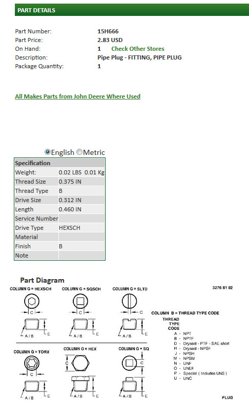

This is the spec's on parts key 24
   / Power Beyond on Dual SCV Valve #9
24 is called out as a pipe plug. Specs TxJim posted shows it to be hex socket w/pipe threads
   / Power Beyond on Dual SCV Valve #10
Thanks.
Since it is a pipe plug, then it would be the PB for the valve.
So hose #6 line is the PB supply for whatever is downstream.
