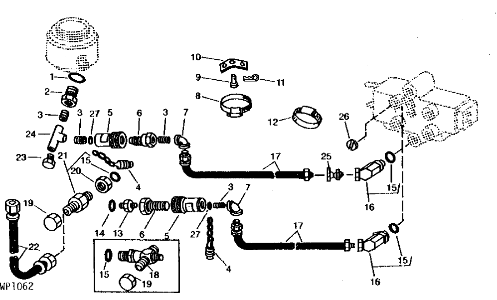

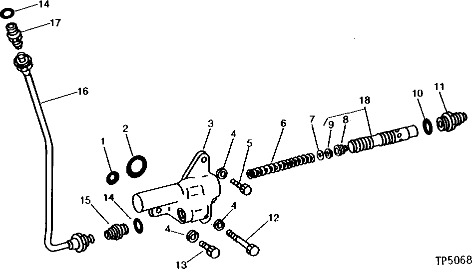

I agree with Kenny that your 1640 has closed-center hyd's therefore the log splitter valve needs to be closed-center. As far as I remember JD utility tractors of that vintage had no true power beyond block but you could plumb log splitter valve similar to frt end loader valve if you didn't want to utilize the scv's.

Jim, were the FEL valves separate to the tractor's main services? Some parts in your diagram I recognise, but not all. What am I looking at, the additional FEL plumbing? I shall have to look under the JD with this drg to hand.

The hyd schematics I [posted are for a JD 145 frt loader valve that would work on a tractor similar to yours. This type plumbing is as close to power beyond that's available on a JD utility tractor. This setup will effeminate the need to power log splitter from the SCV's(rear remotes). Simply remove fitting(parts key #15 2nd photo) and install fitting(parts key #21 1st photo) for pressure oil and route return oil to the ported filter cover. Trying to operate an open-center hyd valve on a closed-center system causes the frt pump to run out of supply oil and start cavitating.
   / Power Beyond to run a log splitter on JD 1640
Jim this is great info, many thanks. Are those parts diagrams from an online resource? I find parts manuals are often far better to study when trying to understand the workings of whatever you're looking at.
