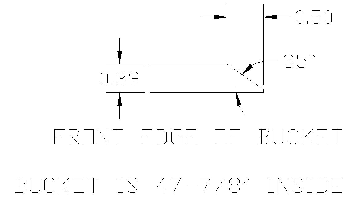

Hi all - I was wondering if anyone has a power bucket (not a slip scoop) laying around that could measure the interior dimension between the sidewalls near the front leading edge.
I haven't received my bucket yet but wanted to get one of the Piranha tooth bars ordered since they are a 4+ week lead time - BXpanded Piranha Toothbar

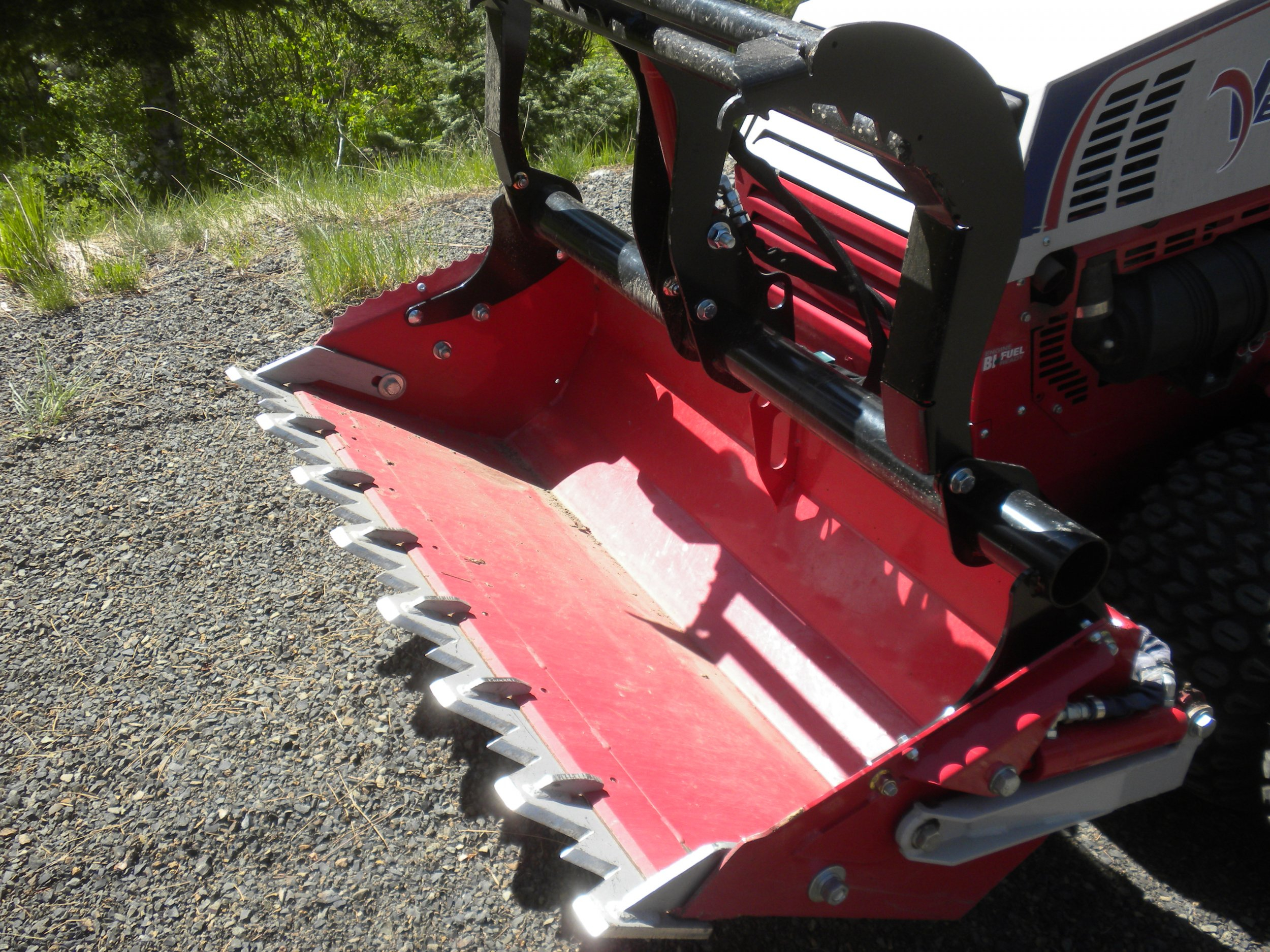

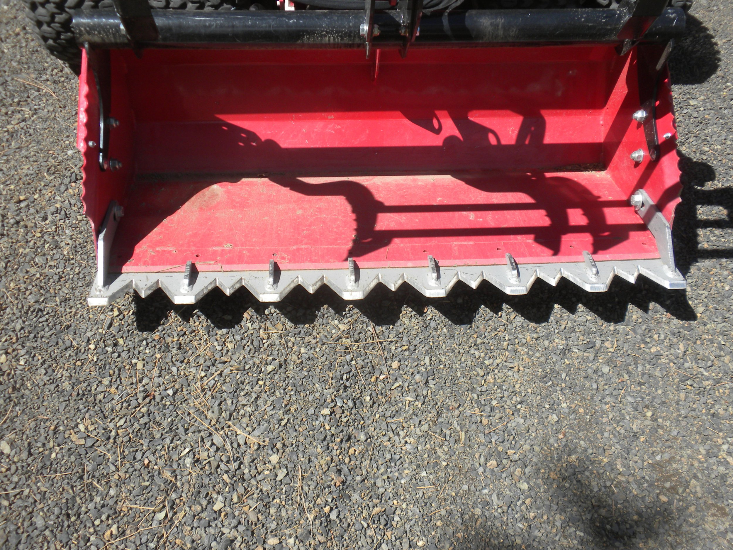

I have one installed. Here is the info I sent to BXpanded and a pic of mine installed.

Thank you for that - looks great too. I think the Piranha bar looks way more effective than the teeth available from Ventrac.

I built my Ventrac teeth up in the front with the meg welder and ground them to a sharp edge and they work good Remember the more you add to the front edge the less power you have ...Jim
   / Power Bucket - Dimensions #7
So the bottom is thinner than the sides? Mine is the same, a real cutting edge like the older buckets was flat..... Jim
