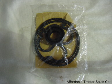

Tommy,
That good news, rebuild kits!

   / Power stearing pump leak
#9
Greg,
Tommy's tractors use the same pump, HLCB-D06/06. Kit arrived yesterday. Hope to get it back together today. I want to replace the fan belt too while it's easy!
