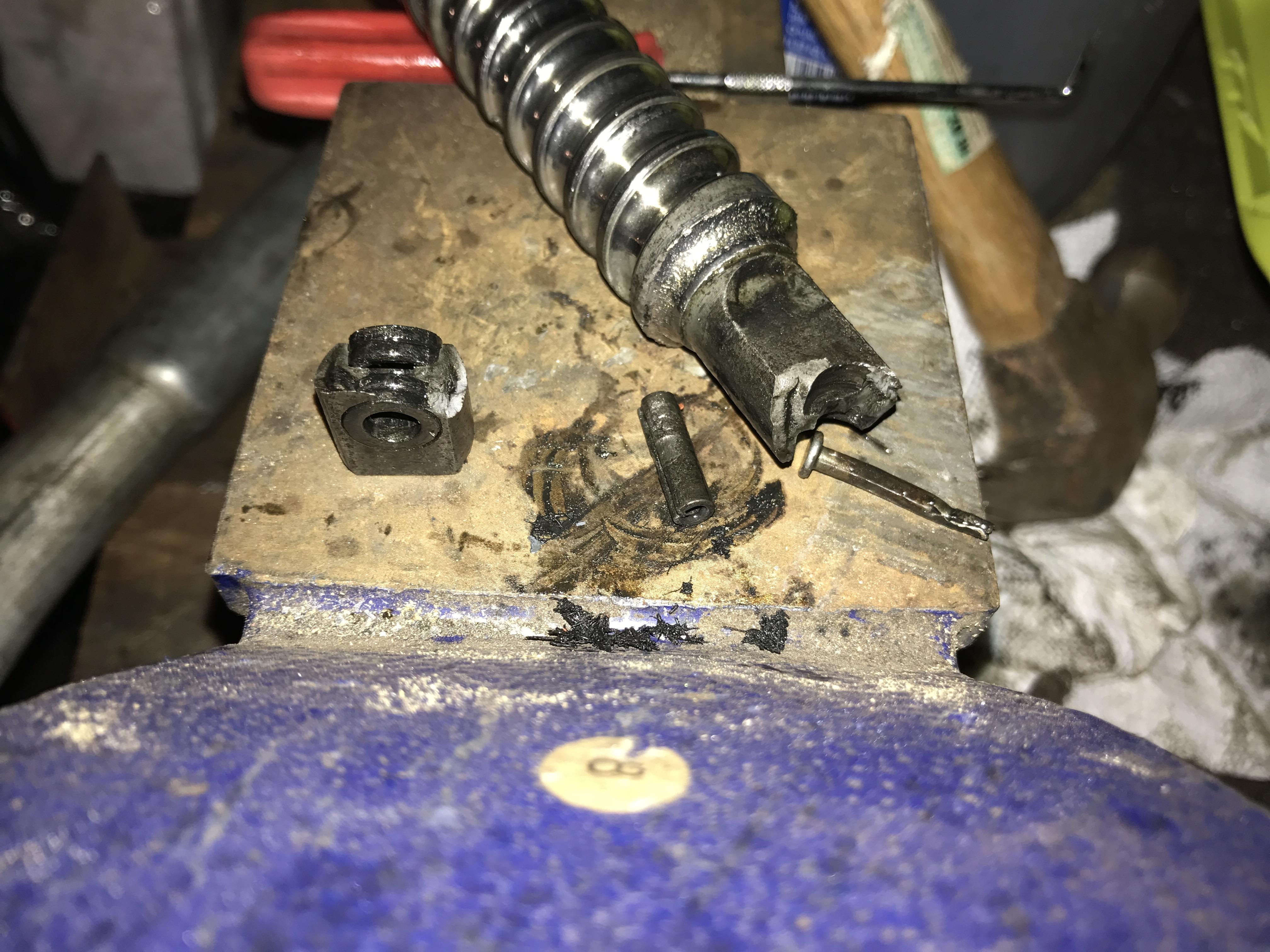

I finished my cab & snowblower on my b8200, pulled it out of the garage the night before our one and only snow storm, turned the wheels and snapped the steering column. It was tough to steer before, but with the blower up, the added weight was to much I guess.
I mended it, but not much of a long term solution. Steering was loose before as it was, I would have to end up replacing the entire thing with a new one, then still have hard steering. And that will cost me $600+. There's no universal kits anymore for this or anything similar that I could find. Basically not a lot of options.

   / Power steering conversion on my kubota B8200 #2
Water runs right down the steering column. Sits in the bottom and freezes. I armstronged mine and broke the spiral with the ball bearings. No one to blame butt myself. Parts were still available then. Fixed it back up and put silicon under the plastic steering wheel cap covering nut and shaft. Wrapped the top of the column very tightly with electrical tape,reversing the first layer so column would not be trapped. 25 yrs later living outdoors in Ohio the power steering is still working. L245DT.
That's what I thought happened but when I took it apart, the whole thing was filled with oil properly. I broke the part at the top of the spiral that the pin goes through, which tells me it just couldn't handle the force. When turning it was being pulled apart by the gear pulling down as the spiral spins. Moving the tractor without steering was a challenge.
