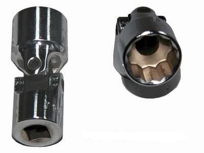

That said, my "just remove the bracket" recommendation originated from the fact that I got ahold of that particular bolt on my KM454 without much trouble at all. Opposite to your current issue, I found the bracket was loose a few years ago. I tightened it with a thin wall swivel socket on a short extension. Only problem with my cheap swivels though, is that they won't take much torque. I put on a new lock washer, but still eyeball it periodically to make sure it's not backing out again.
But anyway, either we have a 3 cyl versus a 4 cyl thing - or it's just a matter of having the right tool for the job.
//greg//
