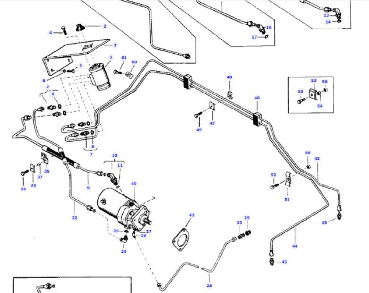

I have a Massey Fergusen 180 tractor (1968?) and we put a new power steering pump it after the old one could not be replaced as it was leaking internally.
The tractor will now steer some but turns very hard and hardly at all with a load on the front end loader.
one Power steering motor has a 'T' port on the bottom of the pump and the other has an 90 Degree 'L' port on the bottom of the pump. Neither one matches the set up I have exactly?? Cant find the exact matching flow diagram?
We have 400 psi in the system with the new pump. What should the pressure be in that system??
Thank you for any help. This has been a year long process.
