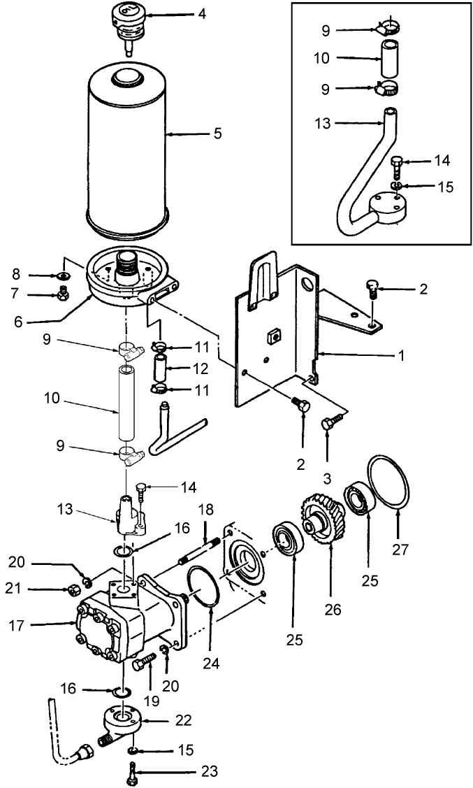

So now that the tractor is running againI have encountered another problem. It seems as though I have hydraulics for the three point and the bucket, just no power steering. I've found the hydraulic fill point on top of the rear differential, but where is the level check located?

The 1920 has a separate pump for the power steering. The reservoir is located on the engine.

to nswer the OP's question, the tractor hyd sump level check is accomplished by dipstick in the upper front right side of the op platform.
as said.. the ps has it's own sump under the hood on the right front side of the engine... fill with utf fluid.

Thanks guys. I suppose an owners manual would be a little helpful on this thing. It has been sitting for 5 or 6 years now so I'm trying to go through everything on it before putting it into service.
