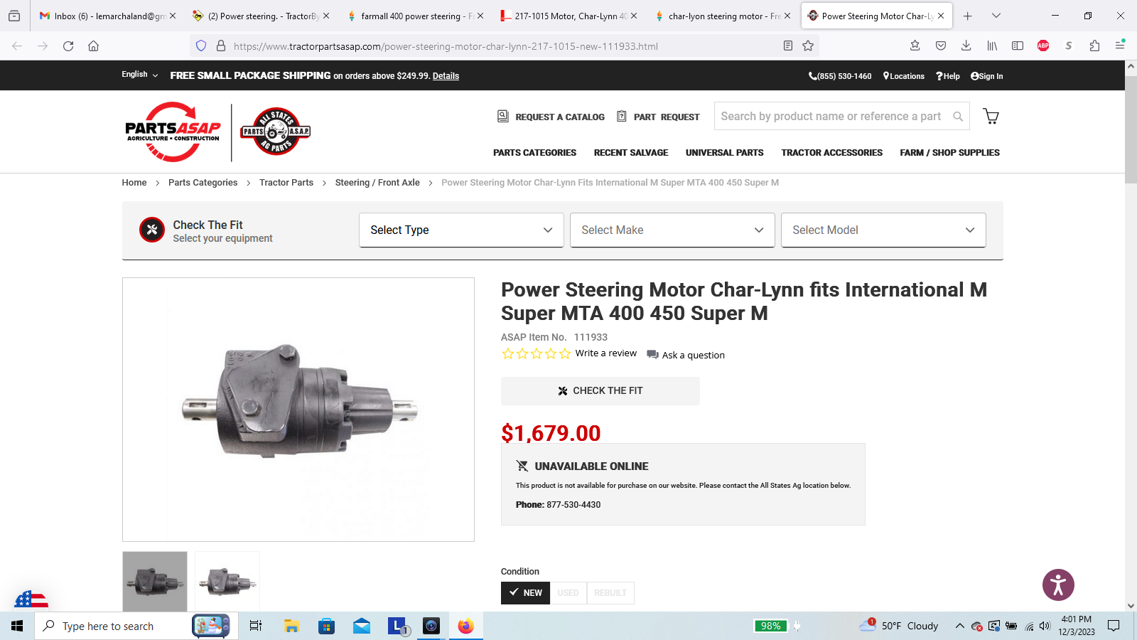

I would like to install power steering on my 53 Jubilee do they make a kit that I can installon my tractor?

they often utilized a Char-Lynn steering motor such as this one;
