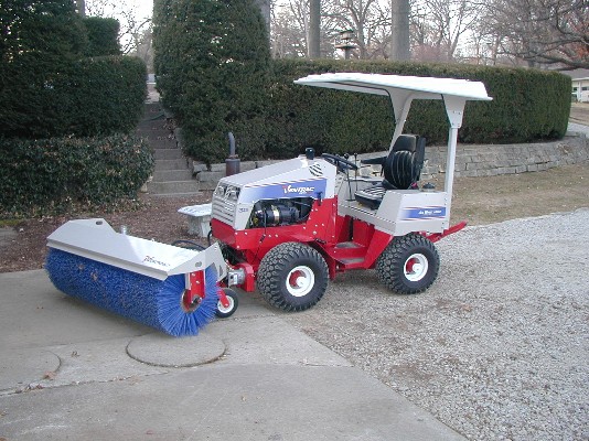

Just wanted to chime in to say that I too like to use the Power Broom for snow removal--just a different brand thats all. (See attached photo of my Ventrac tractor and broom.) Over the years I have used front and rear blades and scoops as well as a great front snowblower on a JD 955. Each type has strengths and weaknesses that have been discussed at length on this forum.
Here are the 2 things I like best about the broom. (1) It is totally forgiving of cracks and abrupt changes in level of concrete and asphalt drives and sidewalks. Scoops and blades seem to find every slight change in level causing abrupt decelerations and / or blade tripping. (2) The broom acts very much in snow like a power box rake acts in soil. This means it somewhat tosses the material but not so far as to be an endangerment to nearby people, cars, or buildings. When using a blower I found I had to be very careful not to let it sling the small gravel that seems to be on every paved roadway and driveway into something valuable. I think the front blower would be great if I had long open expanses of driveway to clear. However, for the close quarters I have to operate in, the broom is a nice compromise.
On the other hand, the broom is most effective if the snow is only 8 inches or less and really works best when it is around 4-6 inches. Therefore, you have to be able to start sweeping relatively soon after the snow begins or it might get ahead of you. If it does I can always fall back and use the front blade.
Although clearing snow with a power broom is not seen as often as with blades or blowers, there are certain commercial applications where they are preferred. The major one is clearing sidewalks around shopping malls and similar campus type layouts where there are often pedestrians present right where you need to clear the snow. I first learned of this from a dealer near Minneapolis-St. Paul who has sold hundreds of power brooms over the years for just this type of application.

Is that gravel I see the Ventrac sitting on and if so how well does the power broom work on that?
Thanks
Jack
   / Power Sweeper in Snow! #9
Yes, that is gravel, and the photo was taken during the summer. In the winter, I use the broom on this gravel when it is covered with snow by just slightly lifting it. In other words, I just try to sweep away all but an inch or so of the snow. On gravel that much residual snow doesn't make any difference.
The Ventrac has an adjustable weight transfer system that allows very little down force of the bristles and the gauge wheels on the ground. This allows the bristles to just "flick" the snow or whatever you are sweeping without putting much down pressure on the surface. As a result, if you are sweeping along the edge of a sidewalk or drive and get the broom out over the turf, it does not pull the turf up or damage it. It just gets "combed."
