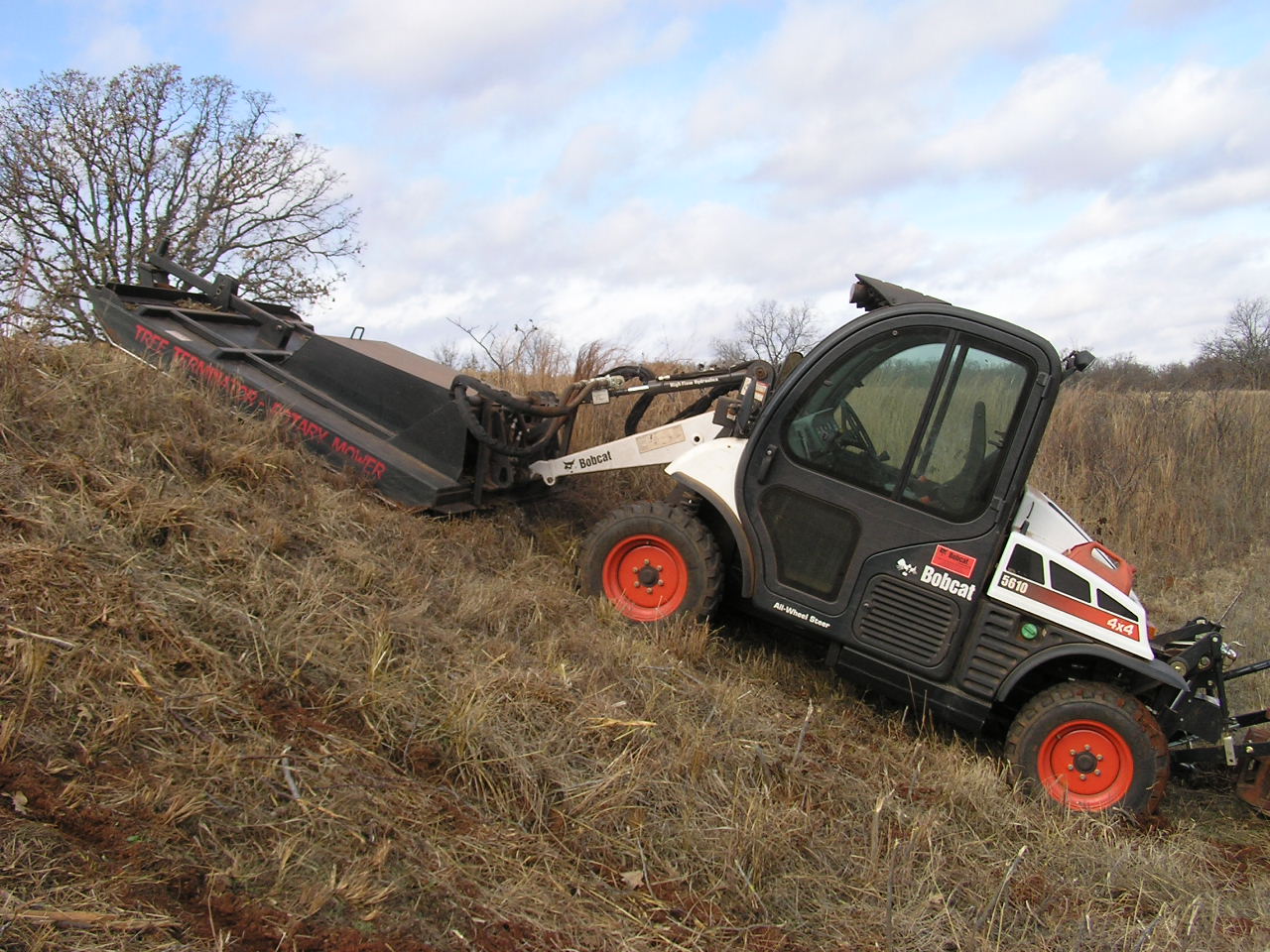

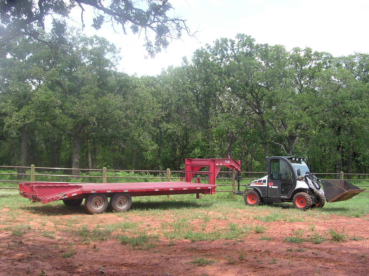

My 5610 easily moves this 5000 pound trailer on flat ground.

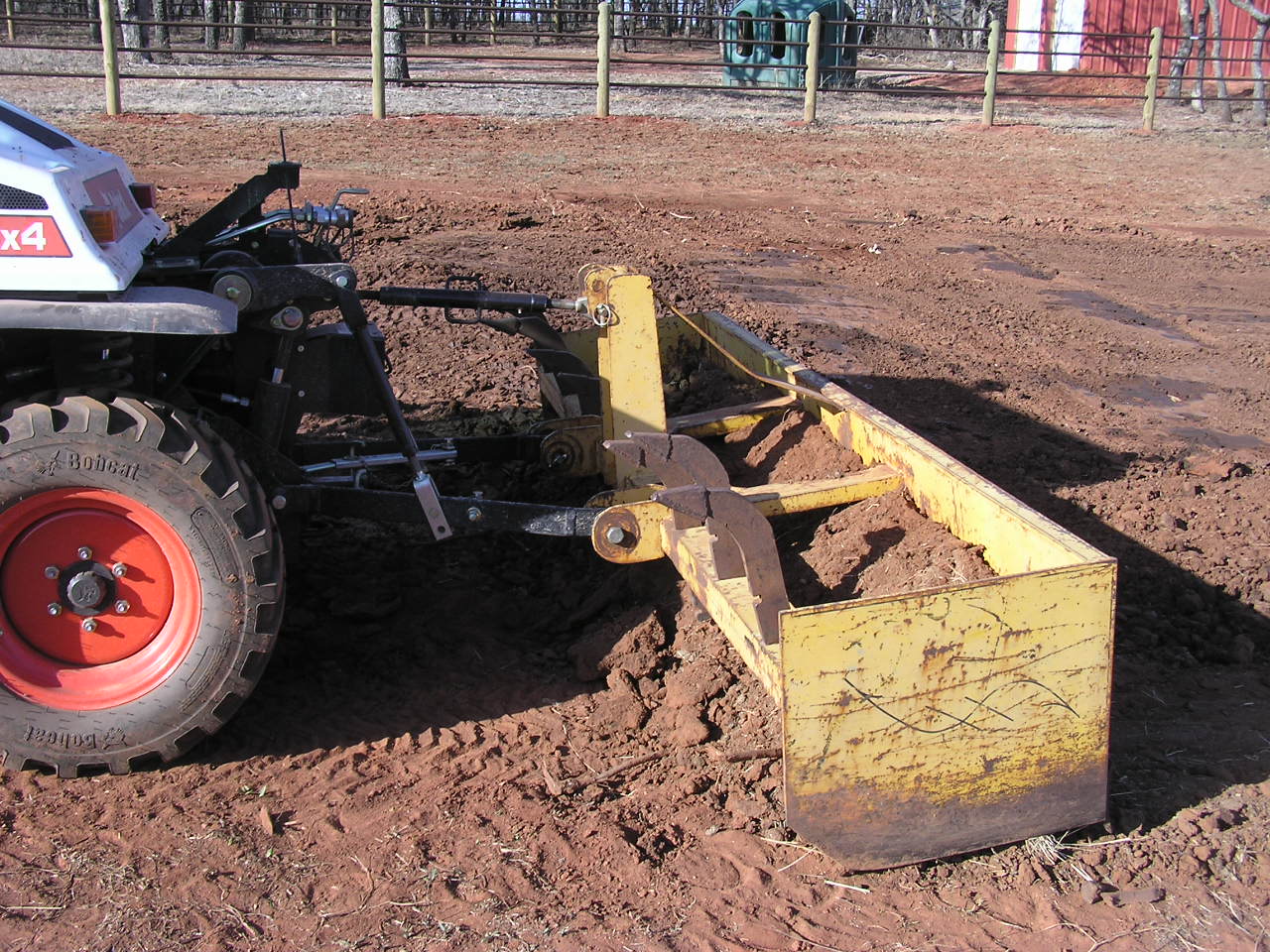

And pulls an 8' box blade.
The 1800 pound brush hog.

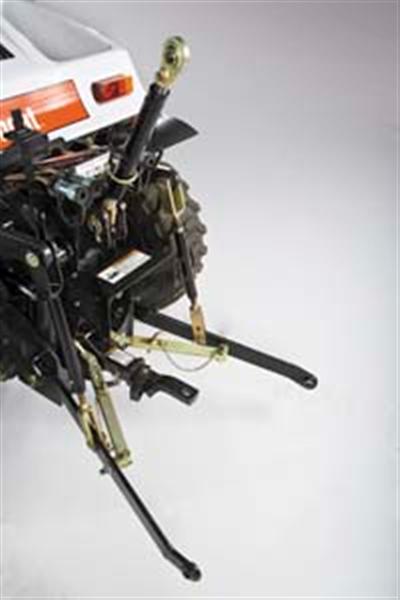

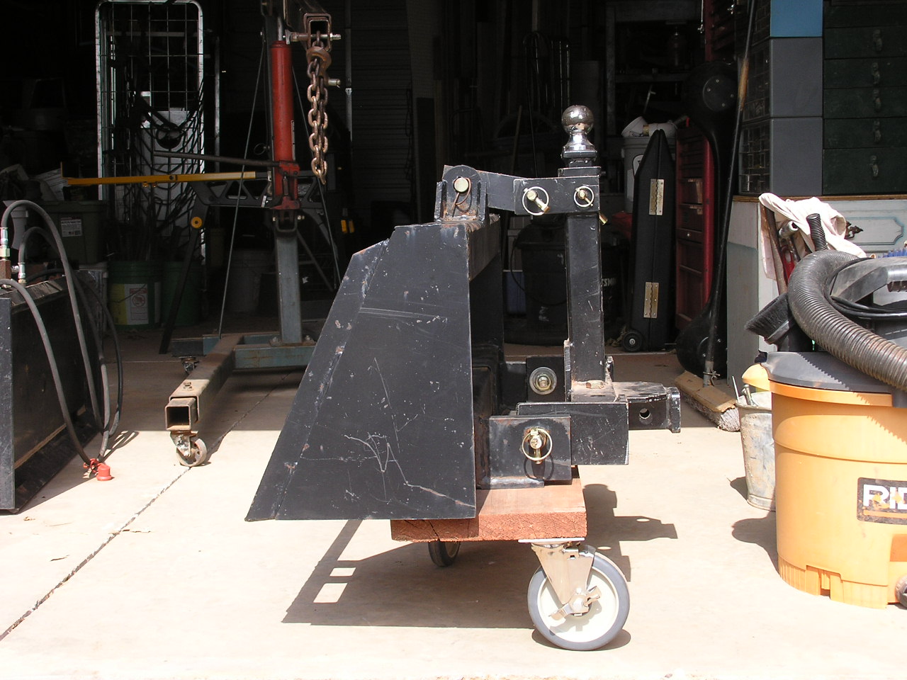

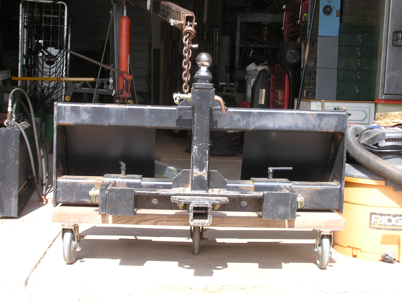

I would also recommend a front hitch, so much better for backing the trailer.
I use this three point hitch on a SSQA for the front.
View attachment 373645 View attachment 373646 View attachment 373647

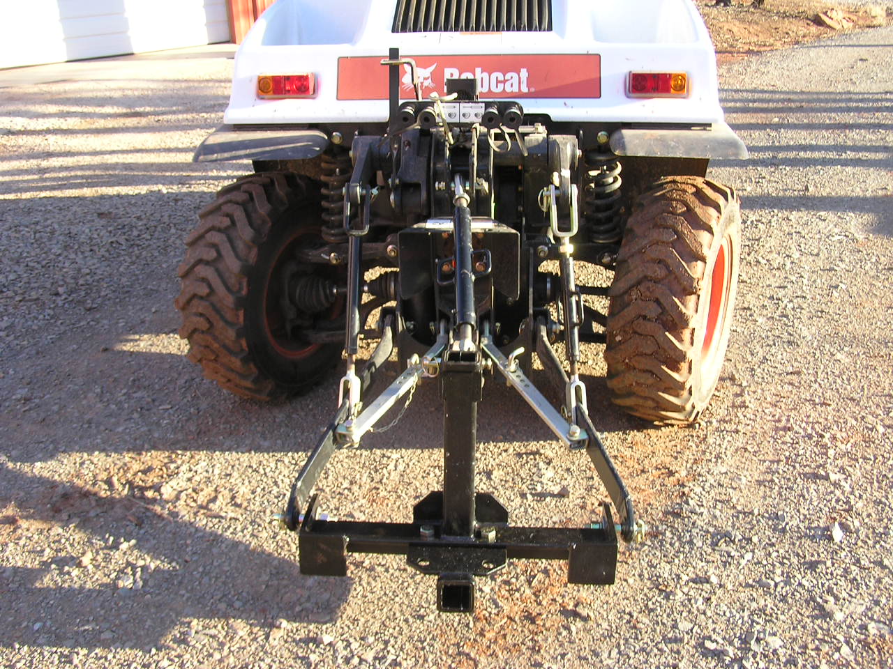

Since there is no DOWN force on a 3-pt wouldn't there be concern about tongue weight? Once the weight of the boat is behind the rear wheels of the trailer its going to want to have negative tongue weight and lift the 3-pt arms or possibly the back of the tractor? Obviously if the trailer is backed in the water far enough this shouldn't happen. This happens occasionally in my small single axle garden trailer if load it heavily in the rear.
   / power to pull a boat up a ramp #10
Yes that is a concern, that is why I use that assembly on the front for tongue trailers. But on a 3 point you can use a chain from the drawbar to the back of the toplink pin and limit the upward travel.

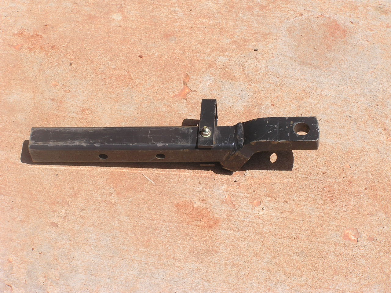

Toolcats come with a frame mounted receiver hitch and a long ballmount/drawbar, so no problem that way.
