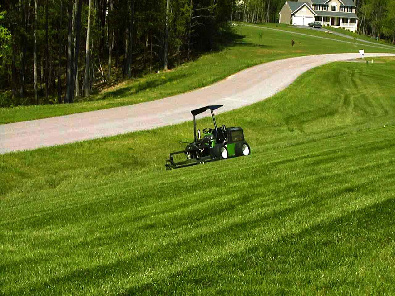

Here's a view of the front hill showing the tractor from our driveway. The camera should be level since it was sitting on the BG&E box out front and the tractor is stopped where i lost contact with the ground to the point where i had to stop. I raised the mower, which lowered the wheel ... put the joystick back in float and moved forward. Front end starts sliding downhill and the wheel comes back off the ground.
The direction that i'm mowing is reverse from my previous problems. So left to right or right to left is no different. Now i didn't try upside down but i'm gonna assume that has no effect either!
Next i made a couple passes in reverse .... no problems except for a stiff neck. Back to forward ... raising the deck just to the point where you release the downward pressure off of the deck but the front mower wheels are still on the ground seems to solve the problem. Now i can go across the hill in forward without the front wheel lift or the sliding downhill.
So the question is ... is this normal? No one else seems to be complaining about front wheel lift.
The loader arms seem to put too much downward pressure on the mower deck which causes the front end to lose traction and slide downhill and raise the tractors front wheel. It seems as if the two pivioting wheels on the mower deck also are trying to steer the tractor downhill as they are pointed in the down hill direction due to the tractor sliding in that direction??? I'm guessing here!
Driveway picture is too big. I can repost this later after i resize it. Here's a view from the sidewalk in front of the house
I've used a tool that measures degrees. It can be used to truss angles i believe. Anyway ... i mounted to the tractor and it read 20 degrees.
