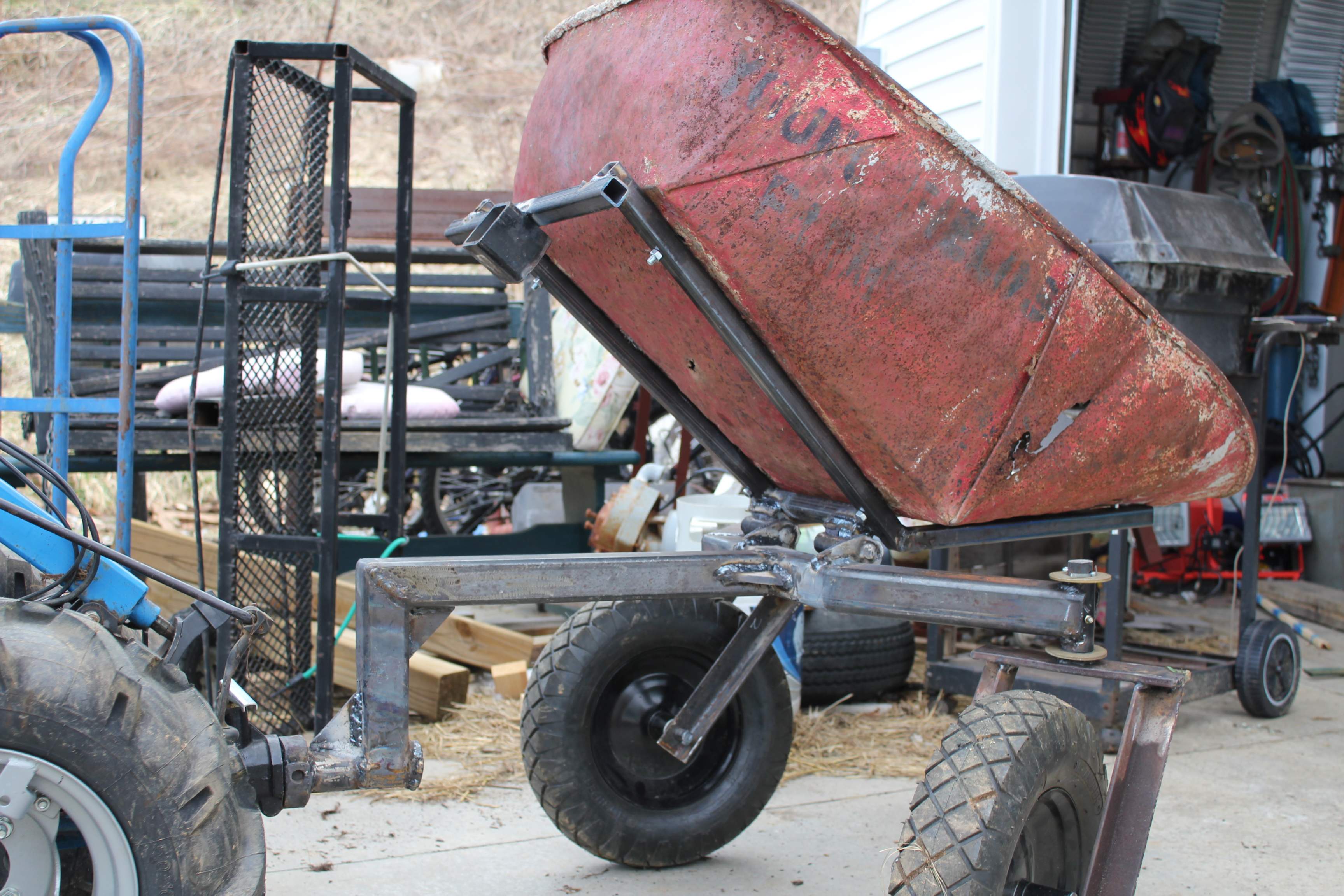

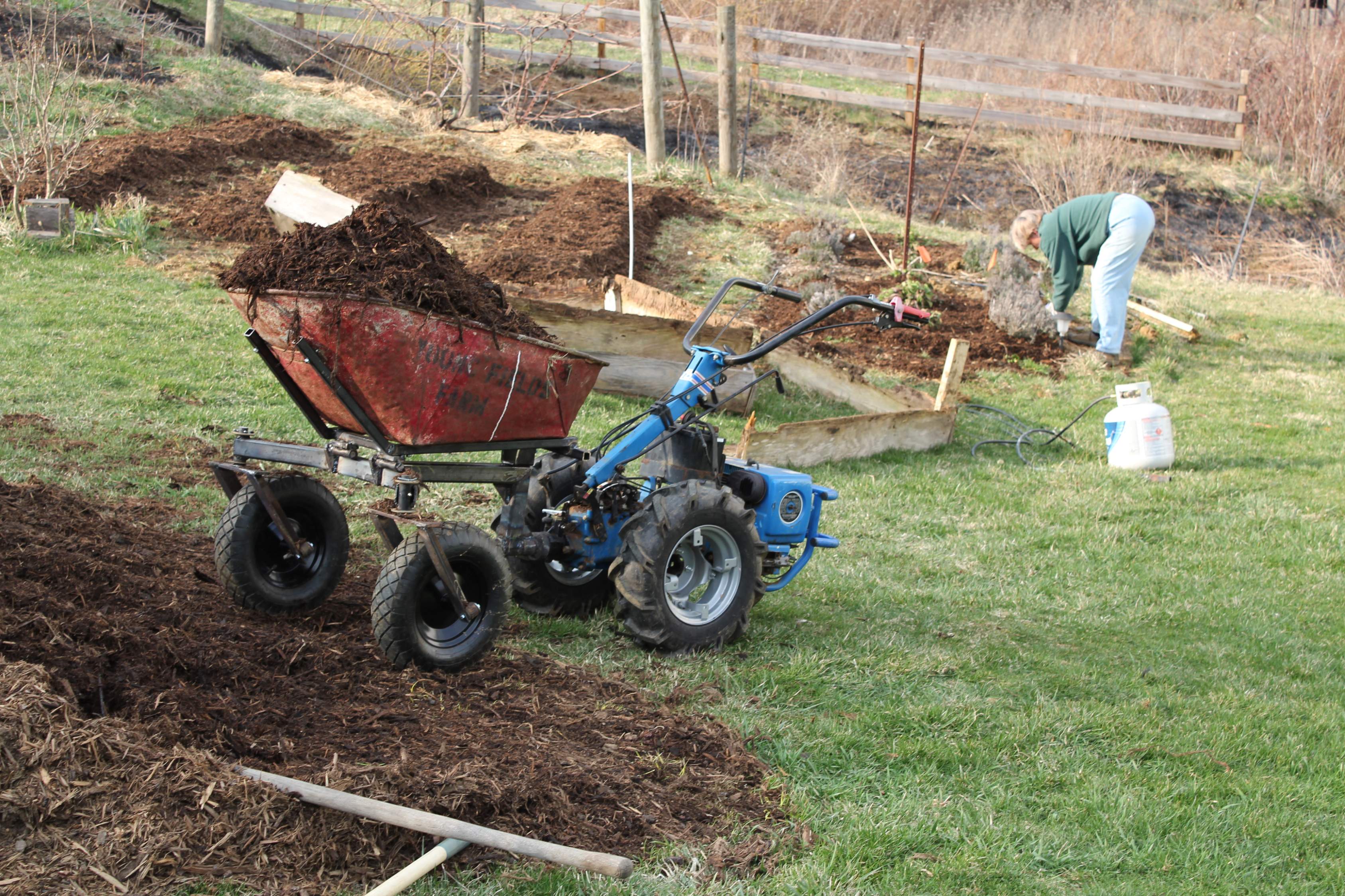

Just finished my version of Old Mech's power wheel barrow. his insights and ideas were priceless, big thanks. My tractor is a BCS 725 with 8 hp Kolher magnum. Used an old barrow tub, picked up about 20 years ago, been though at least two sets of handles and wheels, just couldn't let it go.:) Dump tub is removeable, will build a rack to haul wood later. the heavy frame is 2" square tubing, under the tub is 1" tubing. The axles and hinges for dump are old shock rods. King pins are 1", greaseable. Wheel camber is about 6". Turns good, very light frontend when empty. Moved a bunch of mulch today, worked great.

Look's great. Does it seem tippy on hills or is the stance wide enough to feel stable? It looks up kinda high but I see why, to allow the barrow the dump.
   / Power wheel barrow
RIght now the quick hitch allows too much rotation, so yes it will turn over, but just the tub. I will be welding on some "anti-tilt" stops today, and I think the weight of the tractor will keep it down. The barrow seems high, but I'm not smart enough to get everything to work and it be lower. You are right, it is that high to dump and for the wheels to swivel. I'l let you know how well it works on steep ground shortly. I've got plenty of that to try.

Hi! Congratulation! Very good job. You have make a fine frame. I use mine a lot last year. I think I move or haul more 30-40 tons of material. Empty go better in reverse. For hill I must go square front hill NOT with any angles . I Go or Dump on side one time . With no dommage! I learn! I can Go square Easy front hill with a full load (near 400lbs more than the tractor) on 30 degres step hill. Load transfert by engine torque is impressive! AT first begin with light load. Be careful . Good luck ! Oldmech
Fixed the hitch rotation. Old Mech is right, common sense says go straight up the hill. Straight down can be fun with a load. I think I will like it a lot, wife even thinks it's a good idea:) Just broght a load of firewood off the hill, about a 200ft vertical climb in 500 ft. (steep). No problem, but I think I might want brakes on the tractor.

The electric one look good, but you are right, a little pricey. Have to wonder if they can actually handle steep or rough ground. The reason I like mine is I'm headed out to move wood then I'll hook up the snowblower to get ready for the snow tonight, same power unit.
