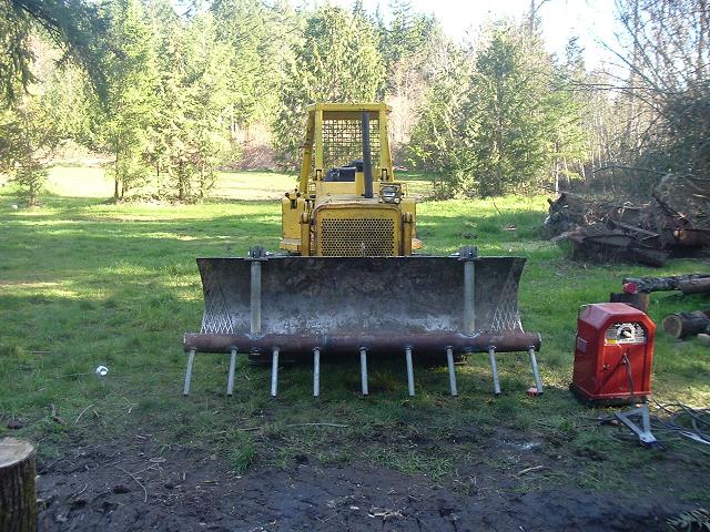

I weld with my Lincoln AC225 220 volt stickwelder (tombstone) and have power to run flood lights at the same time. The floods are either 500 watts each or 2-250 watt elements, I can't remember but way more than a light bulb and the pair is fed by a single 110 volt plug.
I spent many evenings one winter welding material onto the grousers of my old bulldozer in the pitch black except for the floodlights providing light. Those rows of 7018 weld material lasted way longer than anyone thought they would in my clay soils. I was using more than 125 amps of AC current since the rods were 1/8" and the cold grousers were 1/2" thick. Grousers are the little cleats that give dozers grip, as they wear out the tracks slip so you add material or replace the pads and since I am cheap and needed welding practice I welded mine up.
I popped the breaker on my generator a few times when I was in production mode which means it became pitch black but the breaker cooled and I reset it and went on with welding.
I still use that Coleman 5500 continuous/6850 surge generator with an 11 HP tecumseh engine that I purchased for 500$ a few years ago. It's loud and sucks gas but seems to pull through nicely. Welding with this generator is admittedly different than when using grid power since the generator barks and loses a few rpm when you strike a big arc. You will get good at maintaining the arc despite the surge effect after a little practice.
A bigger genset is always better and a pakaged welder/genny might be the perfect ticket for you but I suspect you have a desire to stay low cost since if you had money rolling out of your ears you would probably just run power to the shop.
