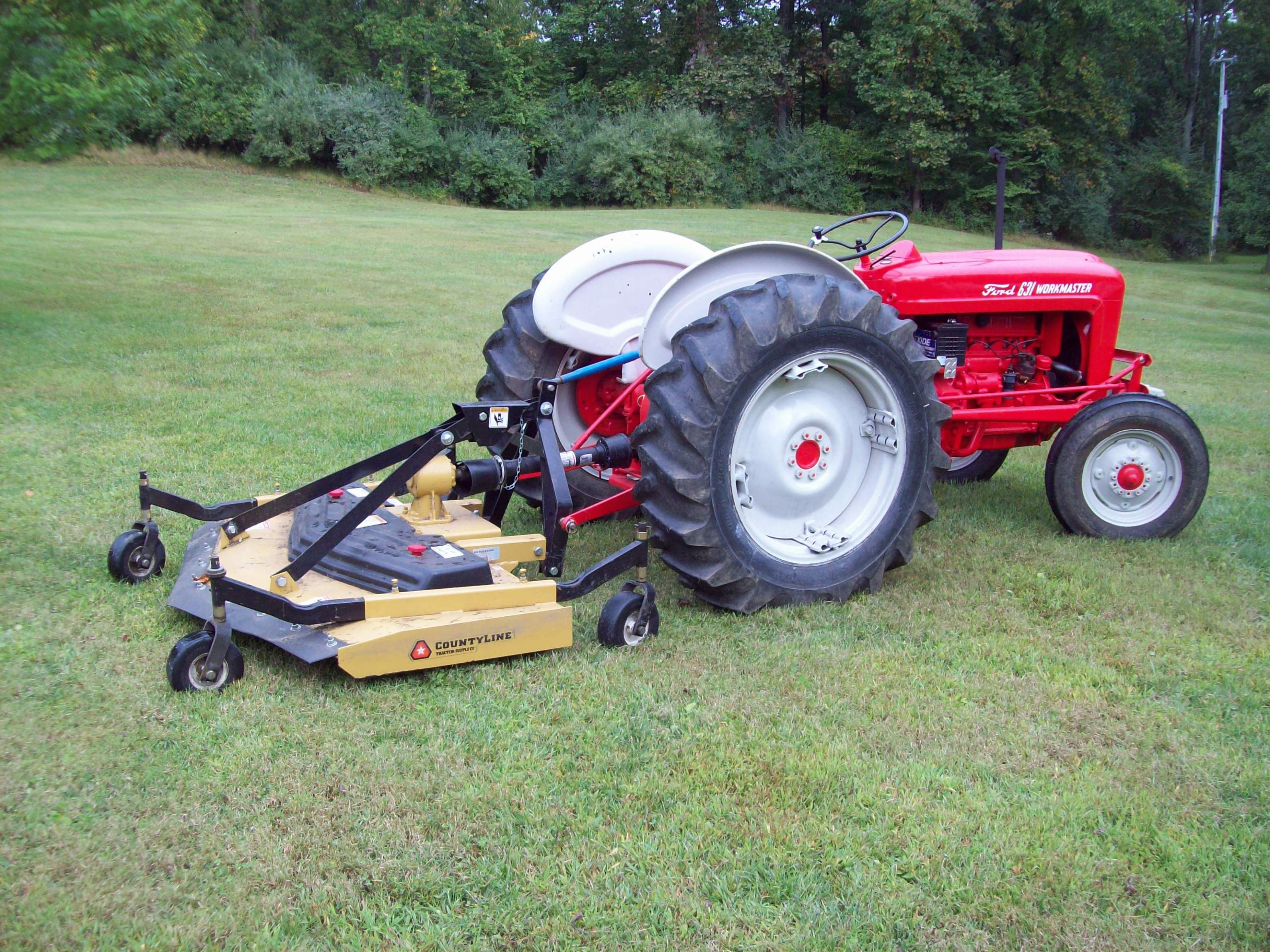

You can see the blank dash on my 631. The pto must have been added at the dealer. The tool box and optional rims I added.

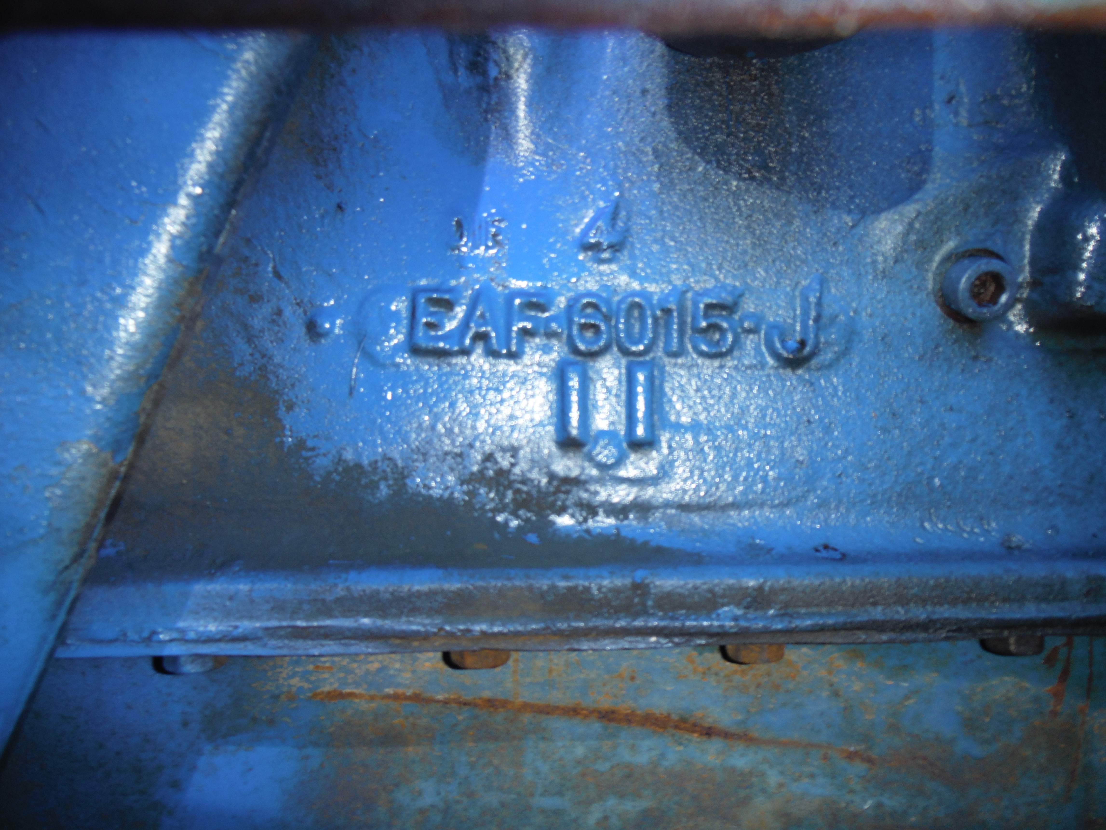

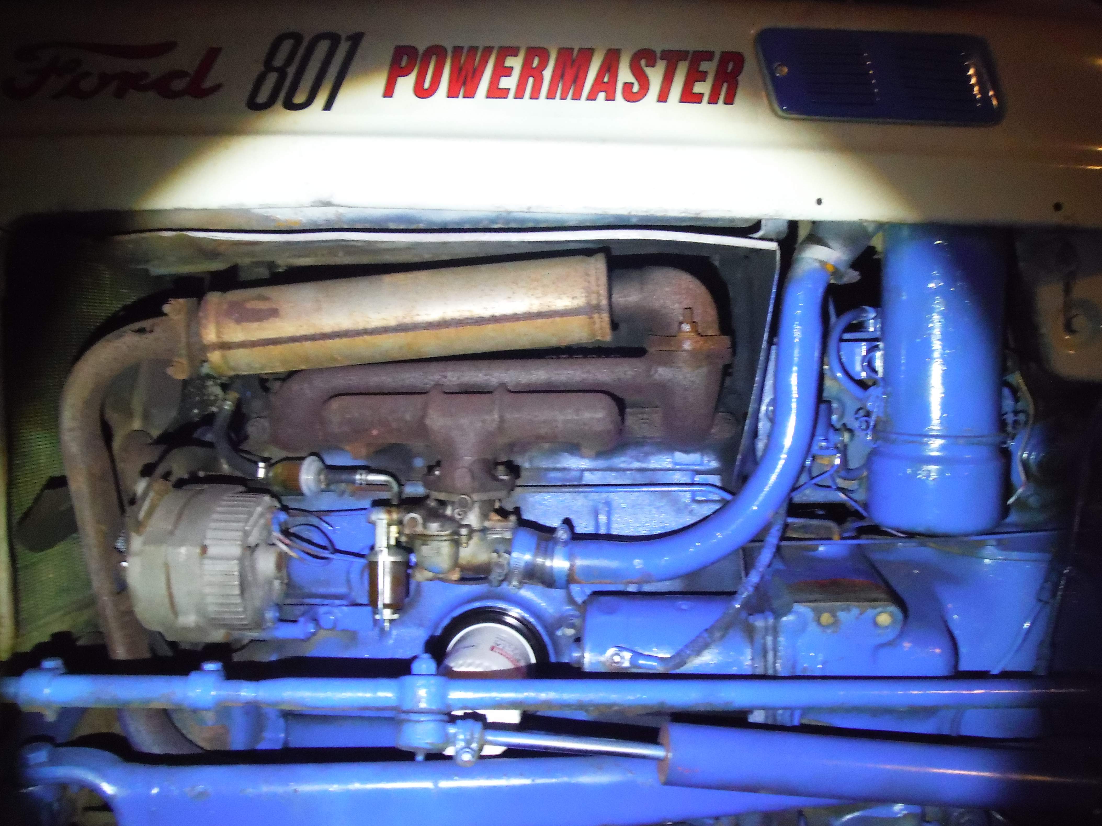

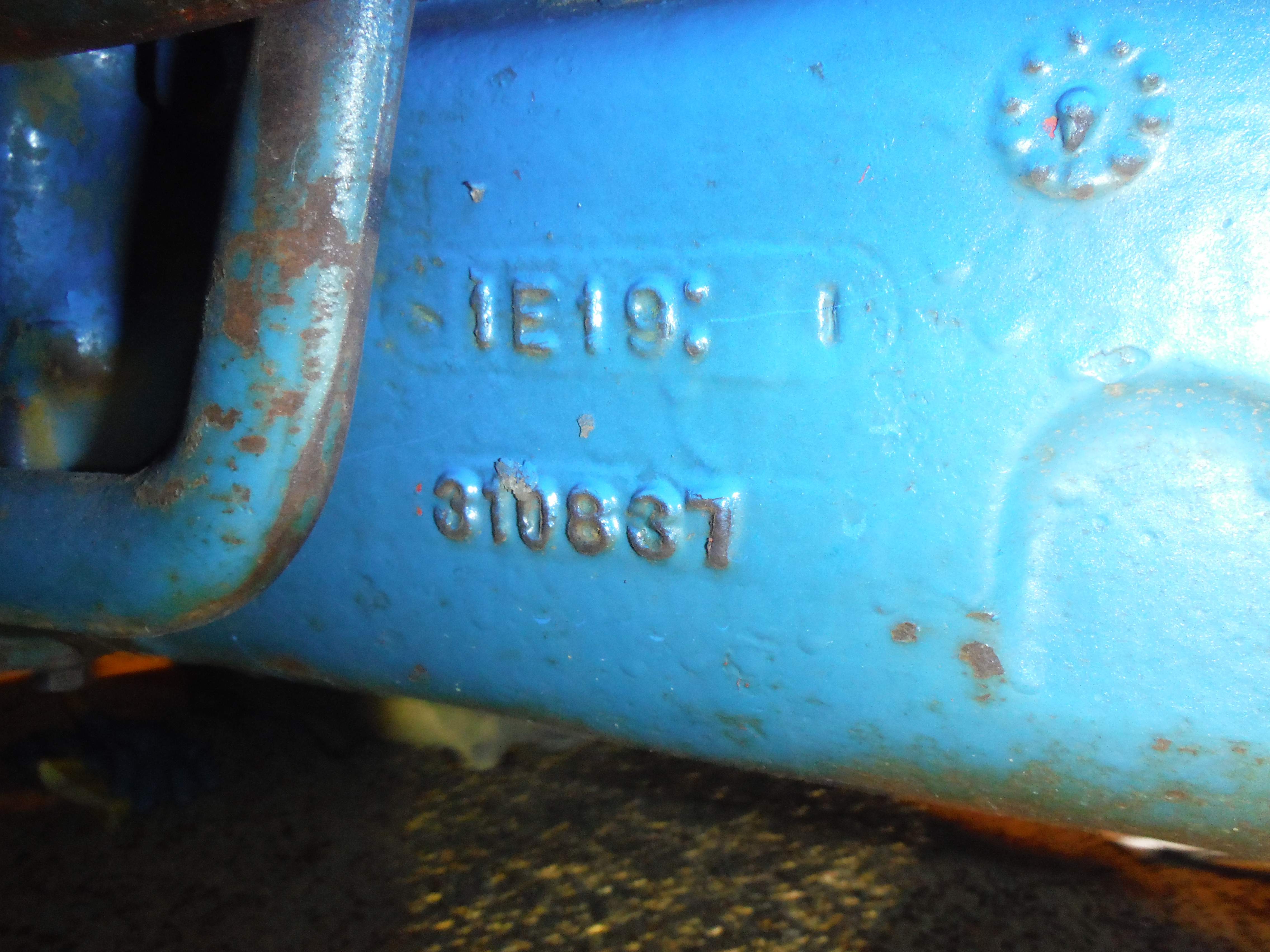

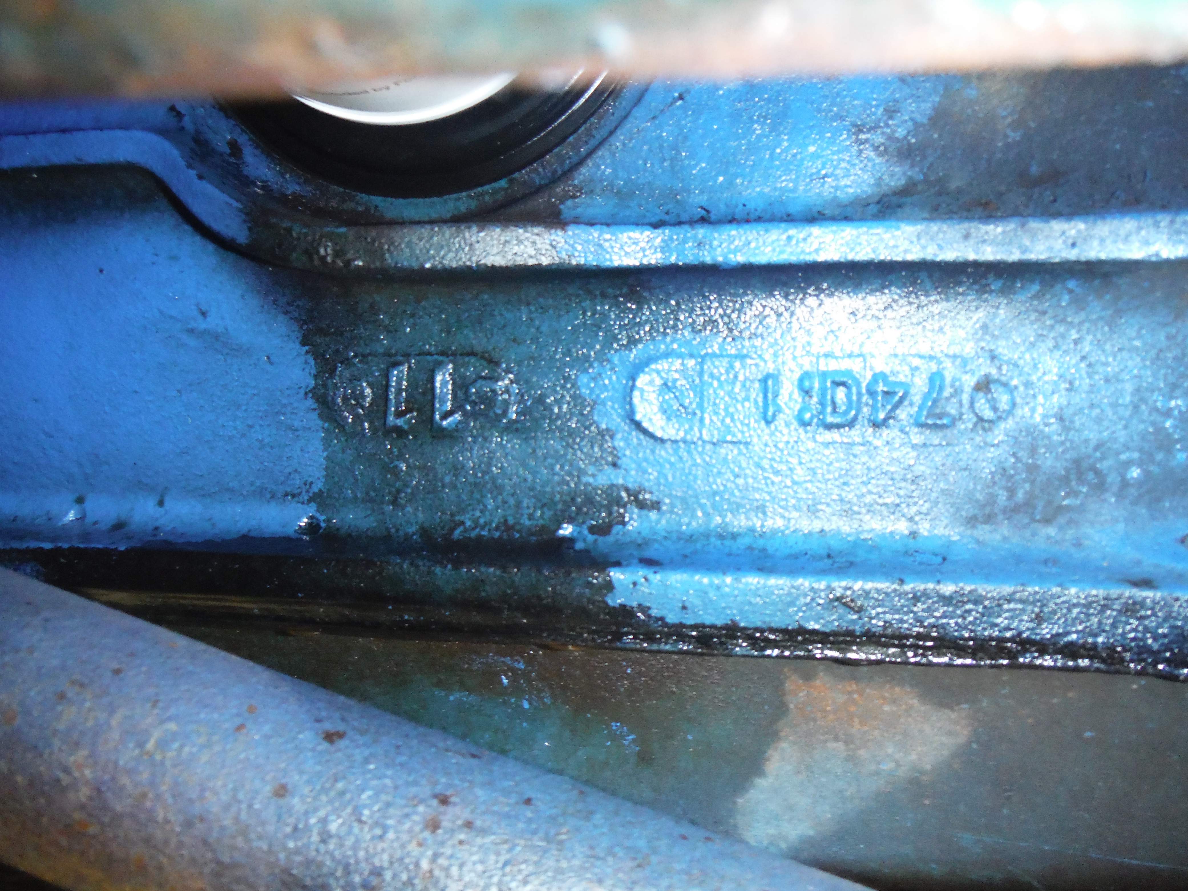

I'll try to get some better pictures, these were just shot in the dark holding a flashlight in one hand and the camera in the other. I'll post the pictures of the engine, including numbers from the left and right side of the block. Then a picture of the number on the right side of the transmission. I didn't see a casting number on the rear end, but I'll look a little harder when I have some daylight.
If I get this right the pictures will be 1) Left side engine block numbers. 2)Right side engine block numbers. 3&4) side view of engine. 5) Numbers on right side of transmission casting.

The eaf # would appear to put it in the 53-57 time, and make it a 172
