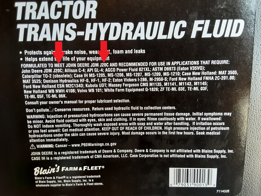

Hey guys:
I own a Yanmar Fx235, had a problem with engaging the 4x4, so I cut the tractor to repair the lever that move the 4x4 pinion, which was bent. But after reinstalling the transmission again, fill with oil, turn on the tractor, and engaging any gear, it will not move.what did I do wrong? Maybe change position of lever ( next to the 4x4 lever), that disengage the transmission?

Yamar tractors only use TF500A or Deere Hy-Gard J20C. So any product must state meets or exceeds and never compatible with.
example,
