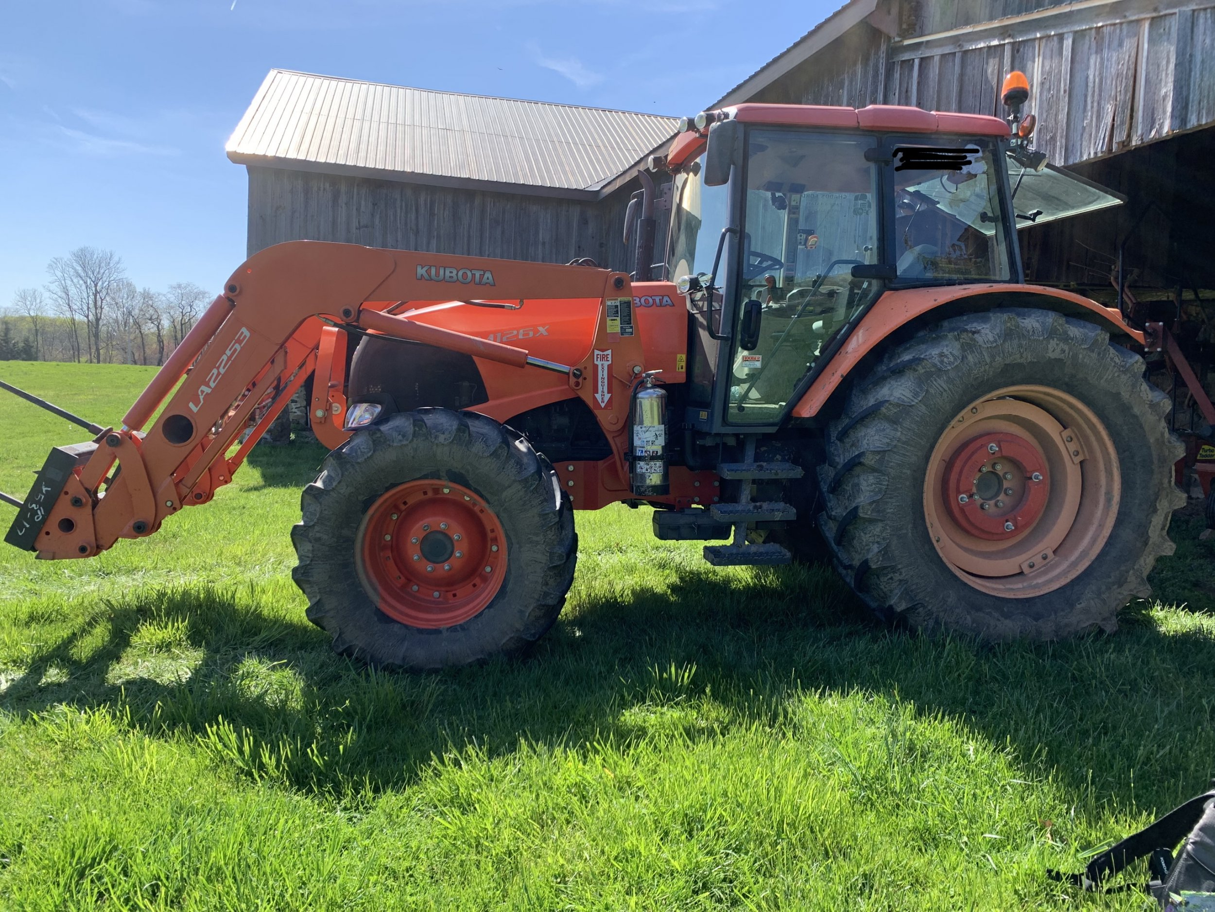

I have a Kubota M-126X that I used for 10+ years of round baling. Its a 12 year old tractor with many newer tractor features. No emissions. You can work on it. And its a good thing you can ;)
I’m in PA if you are interested. Its for sale. 3100 hours.
Parts availability is amazing. Kubota has a big network. Dealers across the state like Sheetz or Wawa convenience stores.

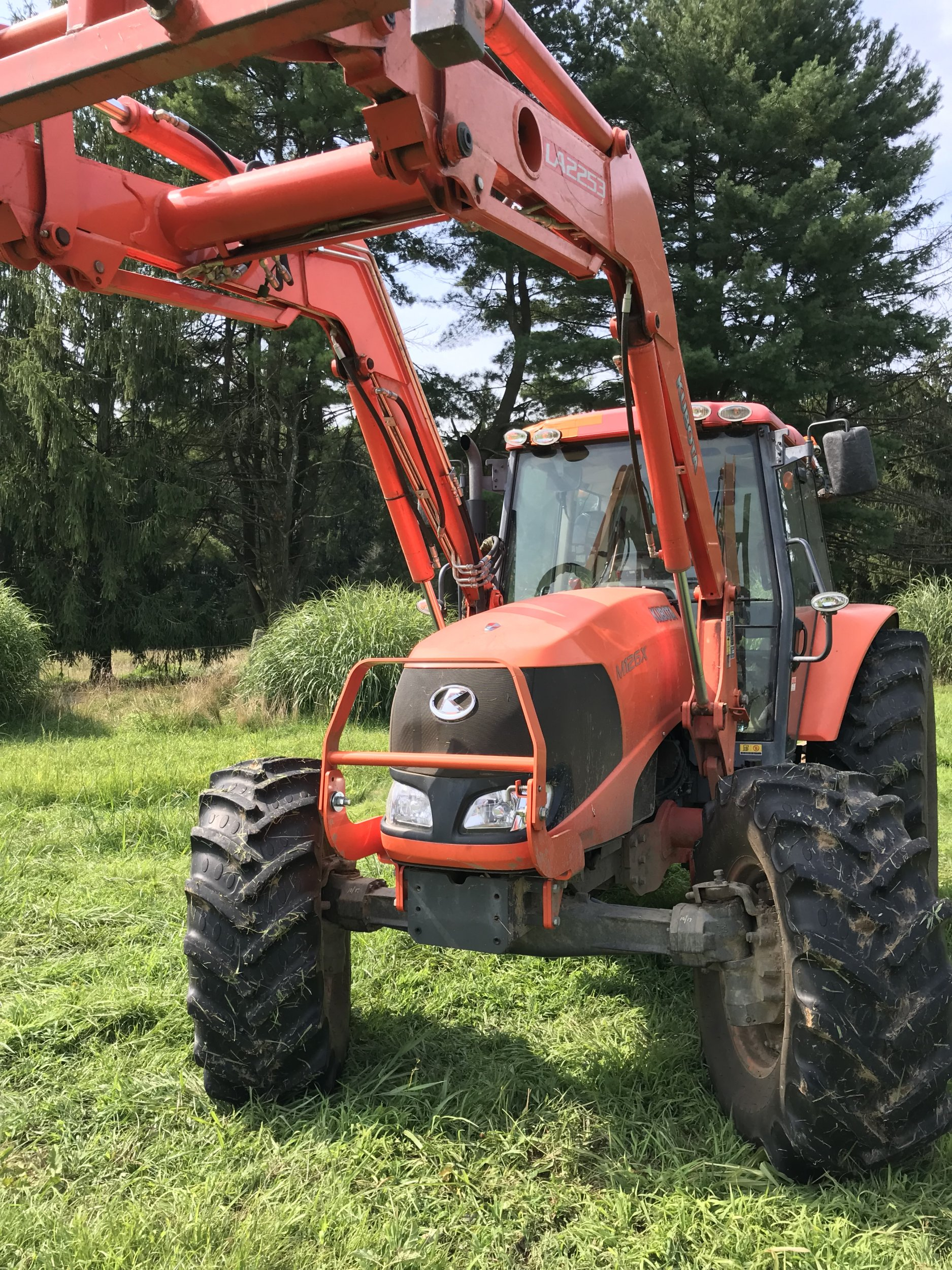

Looks like another one that needs new shoes.

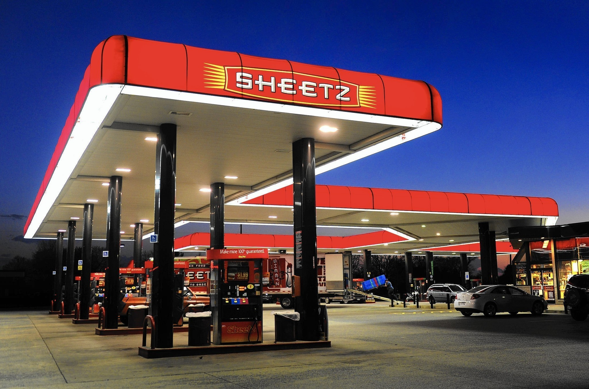

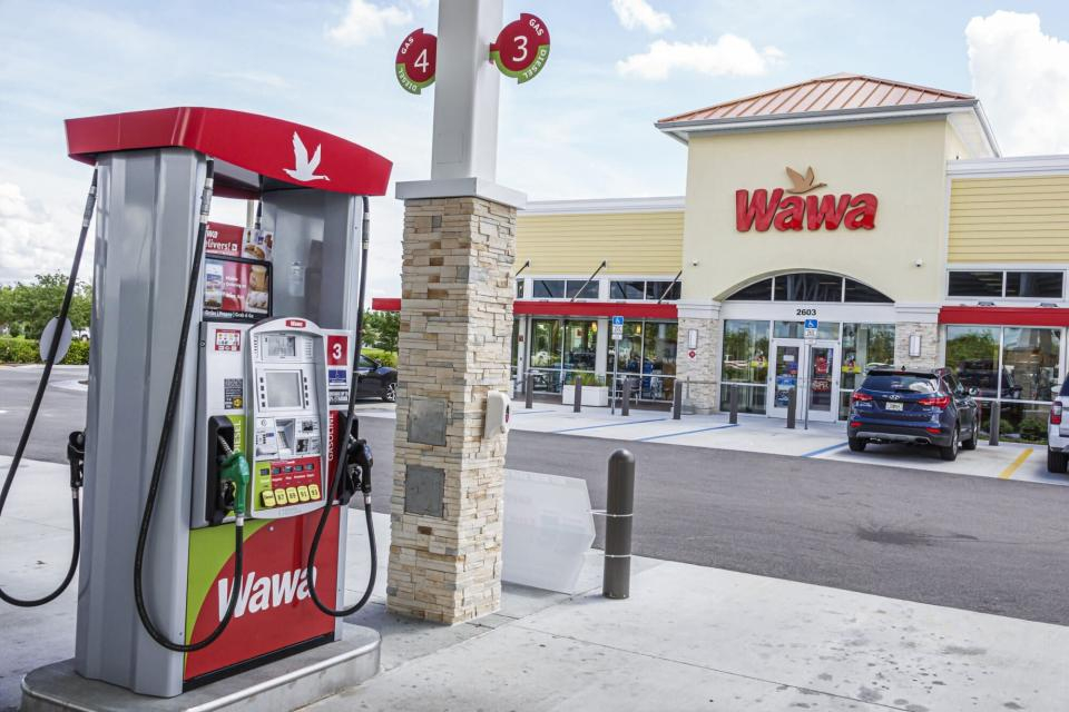

The Sheetz brothers re wrote the book for convenience stores.👍
Wish they covered the east coast.
   / Pre-Emissions 100 Hp #14
When I think of convenience stores and gas stations I think of '*** and Go'... Out west, not here either. Speedway is here.
   / Pre-Emissions 100 Hp #16
Far as economy of scale Hay Dudette, you may be a large tractor person on here but in the grand scheme of things, you are still small potatoes compared to row crop farmers around here not only in acres but in equipment size and scope.
   / Pre-Emissions 100 Hp #17
What book? It took them 17 years to open three stores. Never heard of them in the South. Down here, quick stores were called Icehouses. They dated from the 20's. You could buy snacks, pop, bread and their specialty--Ice. I remember them selling block ice into the late 60s. Bagged ice showed up, I think, in the mid-60s. It was about that time they started adding gas pumps and nearly every gas station added snacks. "Convenience Stores" were well on their way before Sheetz. Some folks in the South still call them an Icehouse.
