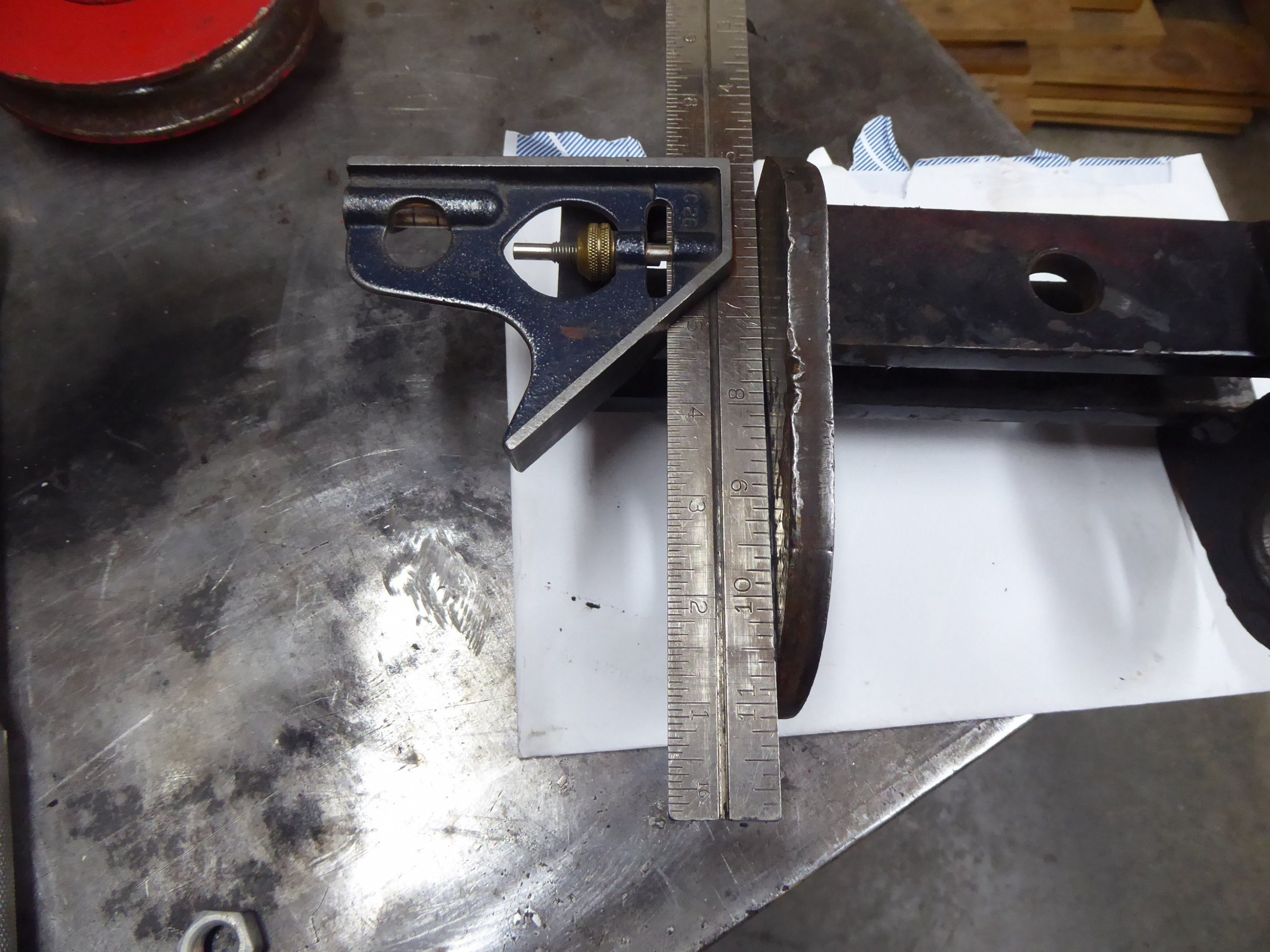

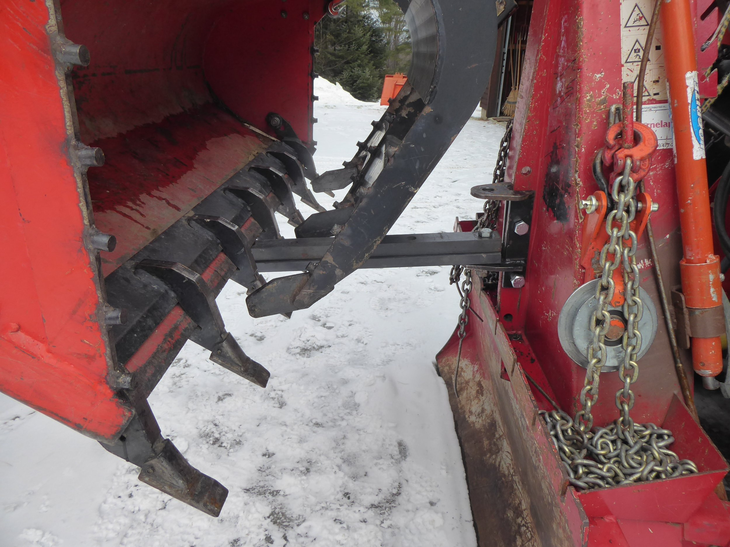

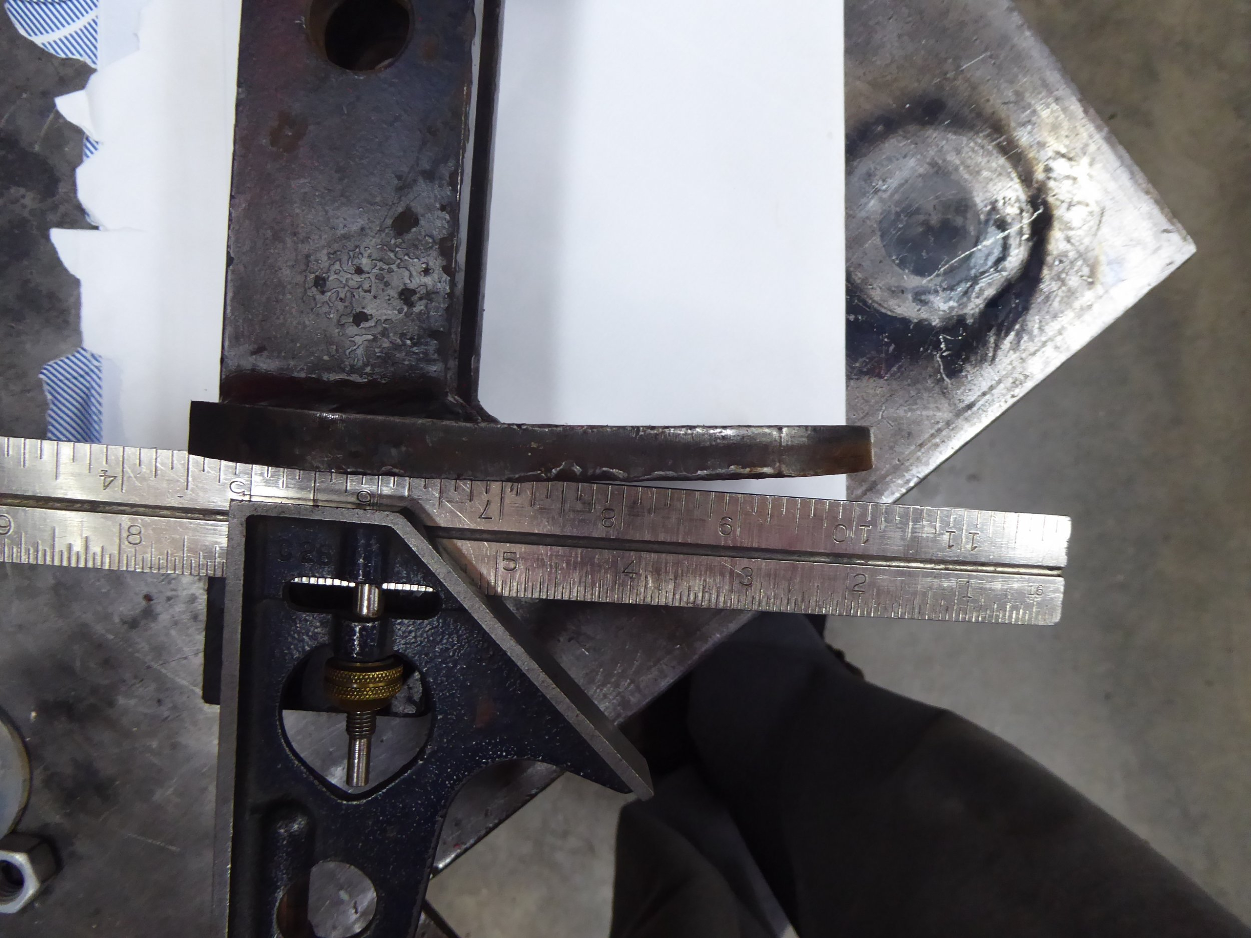

The bracket holding the lower snatch block on my winch got tweaked so there was a bind when the block was at 0* (straight)
I mounted the bracket on the winch and bolted a couple draw bars to it. Then applied just the right amount of pressure with the loader.
Good enough for government work now.
