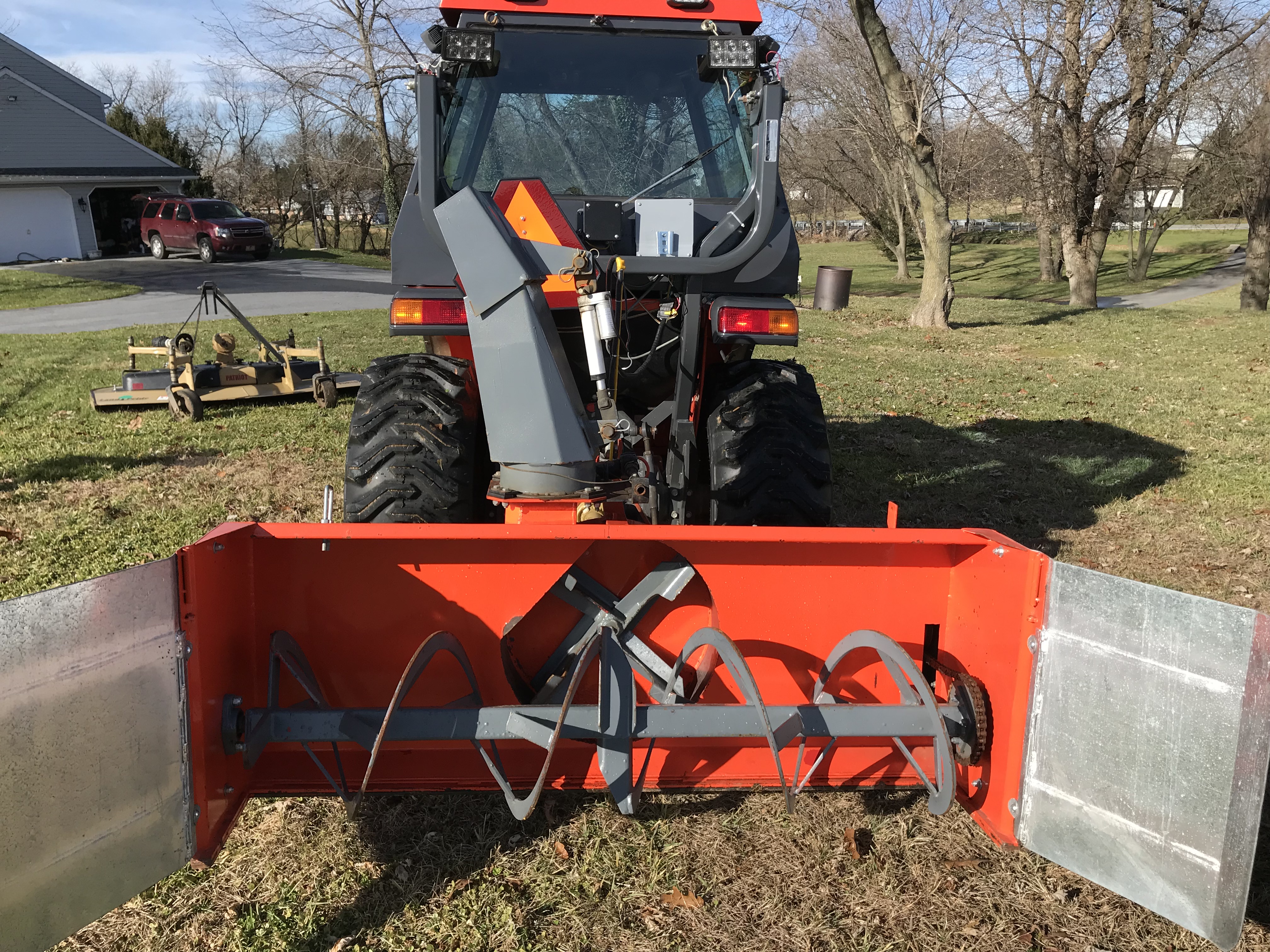

I've had great results with Pittsburgh AUE coatings. They're two-part and hold up well. The snowblower in the picture was refurbed and used 5 years before the picture was taken. Other than the scrubbing in the fan chamber, it was still looking real good. Sold the blower along with the L3200 about a year ago.
There are other two part paints from True Value and Rustoleum that I have tried for odds and ends as well. I think the important thing is to use a coating with a hardener.

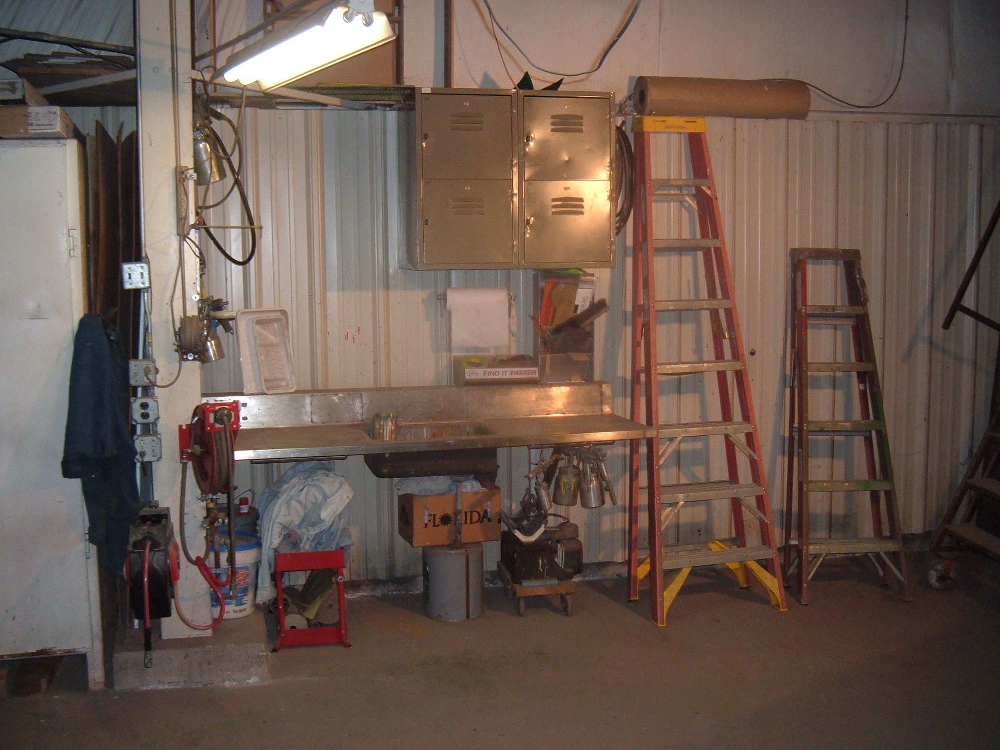

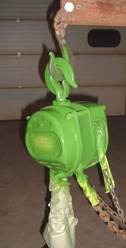

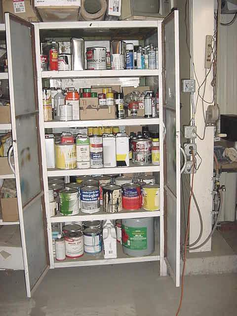

I bought that stuff at n auction with some other stuff and was dingy, clean, scuff mask and paint. A lot of equipment fluff up dont even bother with primer simply use 2 spray coats. Common paint is so much less hazardous than specialty stuff, both during spray and dry. My point being there is a lot to read about paint if you try hard enough but not such some simple how to.
Learning to be fast and adequate, the difference between a trailer and a new jet airplane is different. A deep secret to good sandblasting is to hit it with maroon Scotchbrite after to smooth it before prime and blow it off with air, good to go. I dont use any of that ****, treater, washer nada, nothing, scuff blow and shoot.
The shot in pic 3 was right after a revovation was about 20 yrs over do. The space where the ladders are was stacked with crap I hadnt used in for ever.

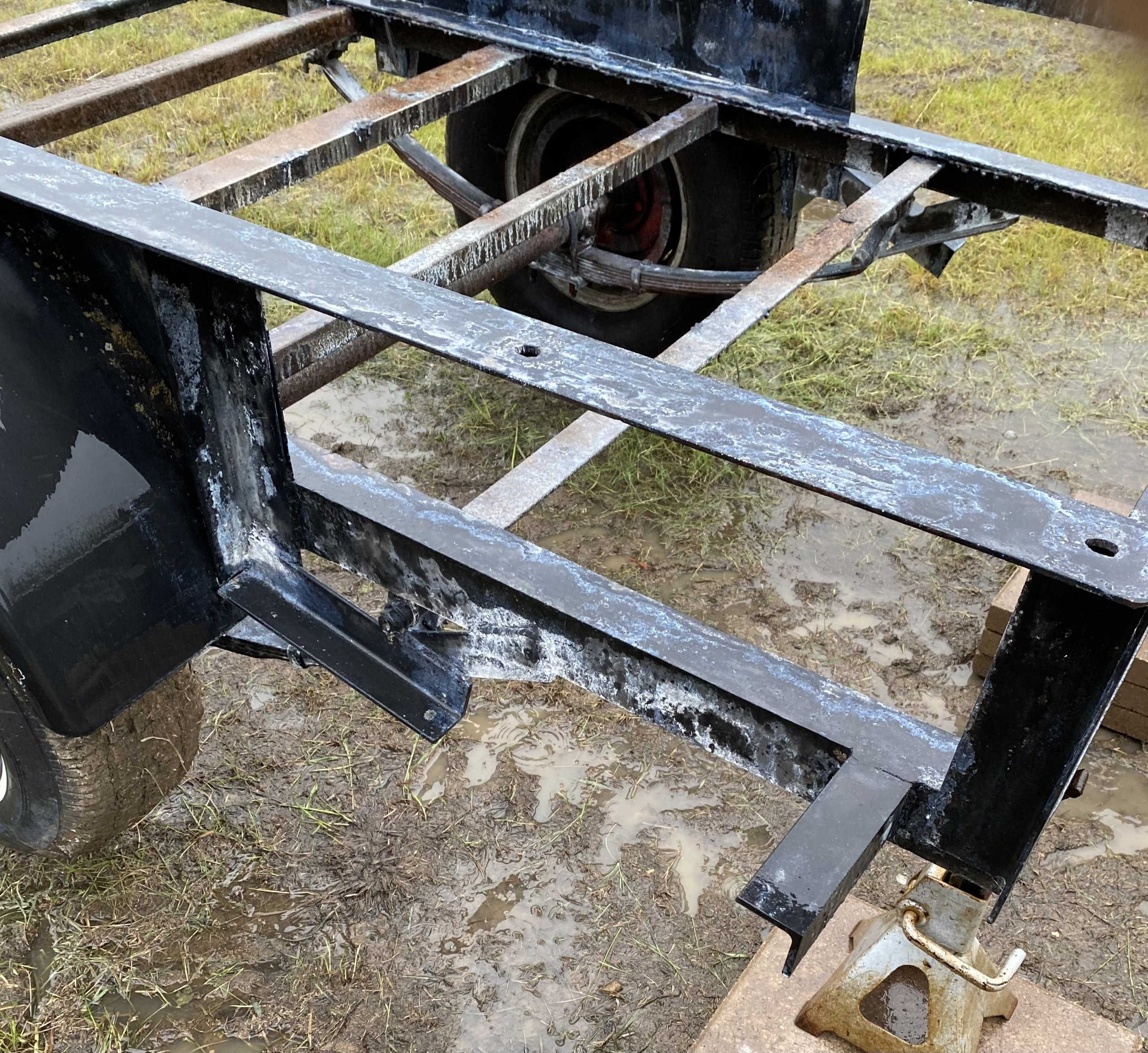

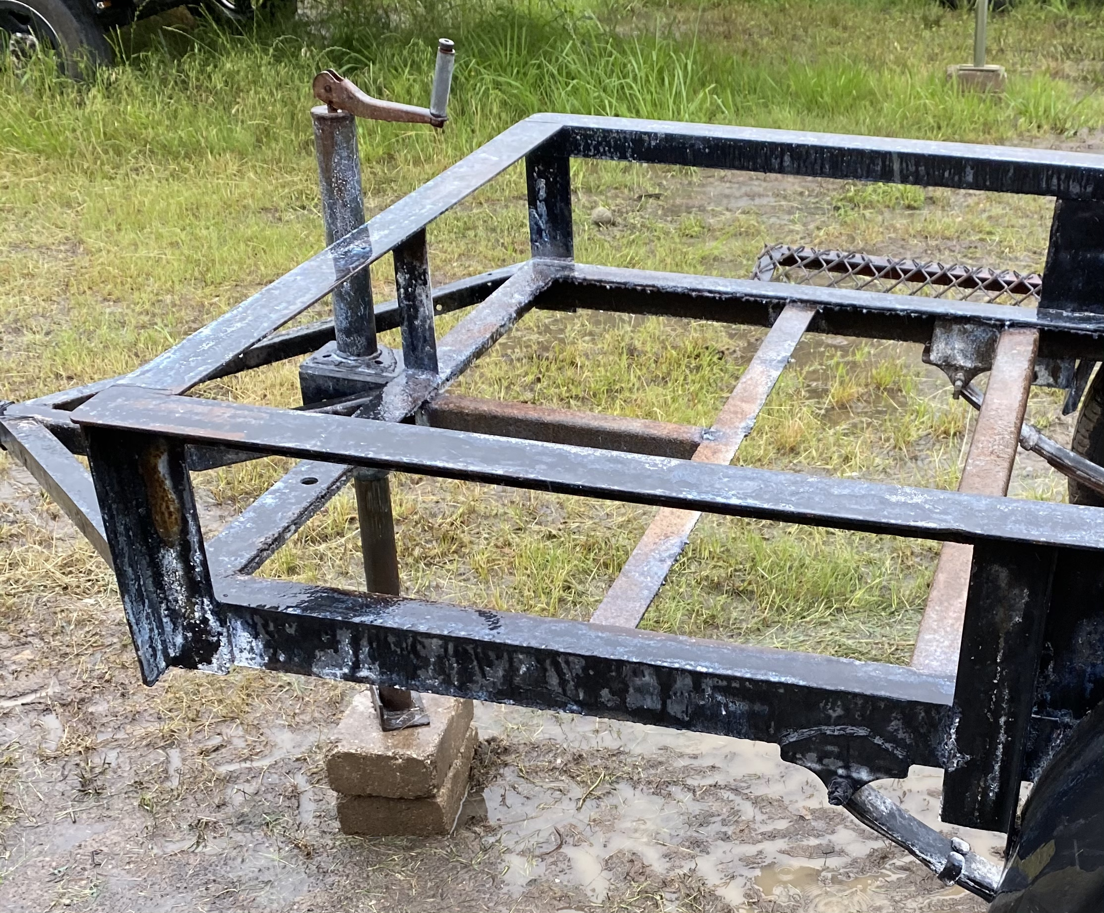

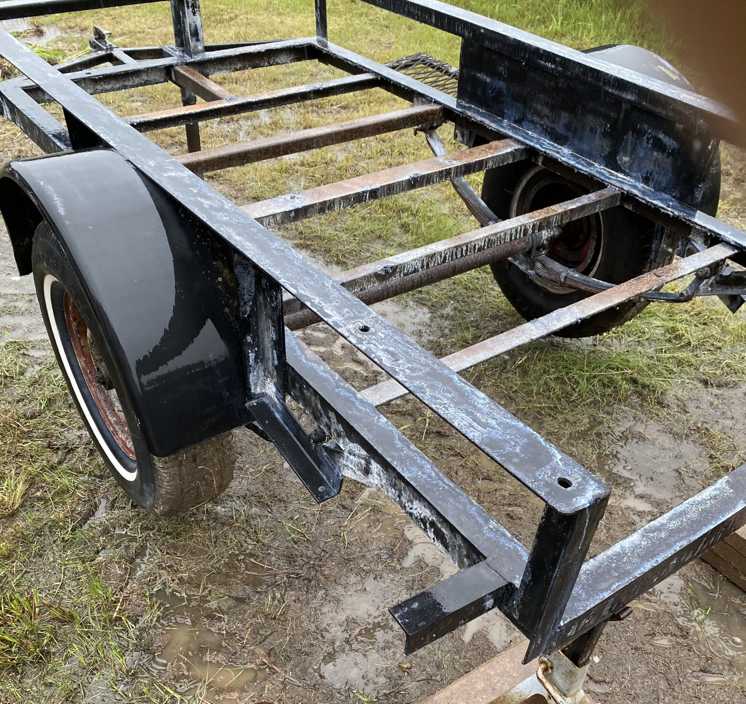

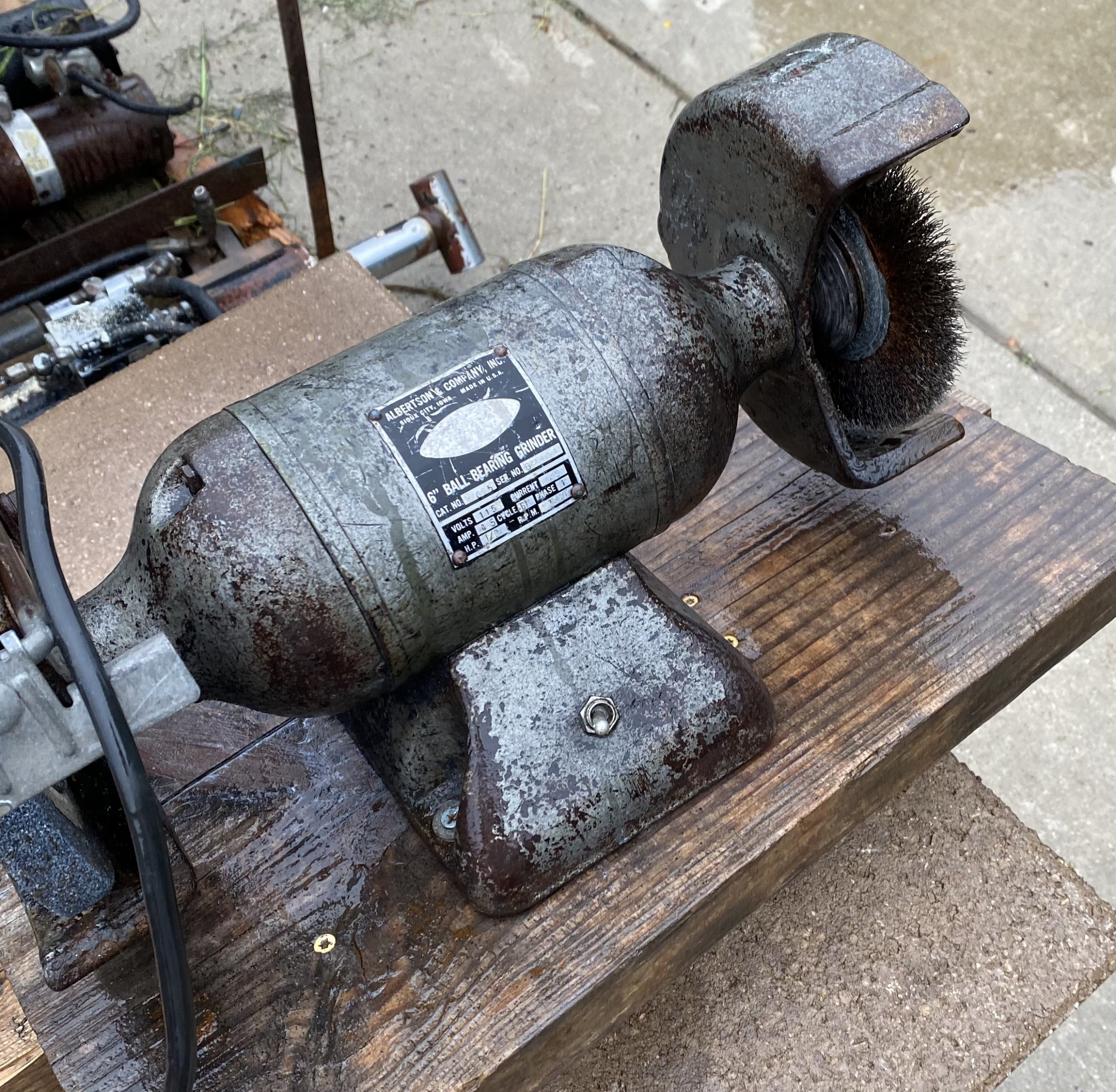

I found this on Amazon..... then went to their website... then found out a local dealer is ACE Hardware. Found our local had 2 gallons & was price comparable to Amazon. Got them Thursday. Tested it yesterday with a spray bottle(spritzer bottle) first on the old grinder then the trailer I’m preping to paint. Pretty cool stuff folks. I’m diggin’ it. Picks to follow later today.
/ Preferred paints #17

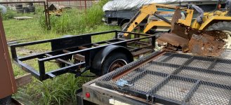

So, the picture with the cub cadet behind it was taken Saturday. It had received at least 3 16oz spritzer bottles of the green juice on Friday to look that way. The torched out metal floor was piled up on the gooseneck. Next to that pile is the tailgate I’ll be welding into the little trailer soon as the rain let’s me....
Saturday afternoon it got tipped up on its tail and the belly of the frame got its own 3 16oz bottles of spray which made this white stuff show up today from the rain...
checkout the petina look on the grinder now.
