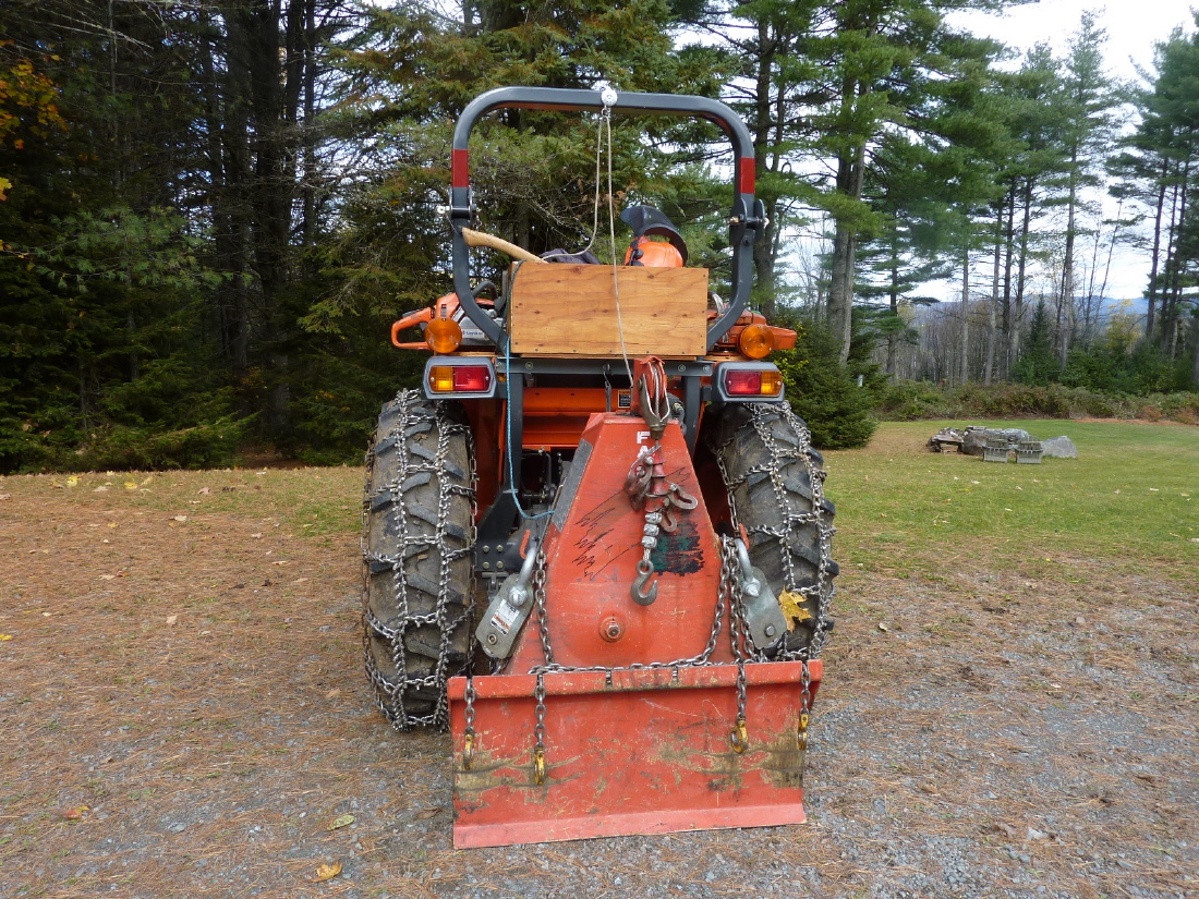

The price of these were $365 in 2005 they are 8mm chains on 12.4 X 24 R1's. So they are going on 8 years old. They last a long time. They say that inflation is low but everything I look at it seems the price has doubled or trippled.

   / Preferred Style Of Tire Chains?
Gordon, those are the type chains I'm interested in. Granted, my size being wider, they'd be a bit more money, but I'm seeing $900-$1000 range. That's why I'm still looking. Glad there's no inflation.
I called Labonvilles in Gorham, NH. I figured they'd have high quality chains, and they do, but $1700(!) was a little rich for my blood.
