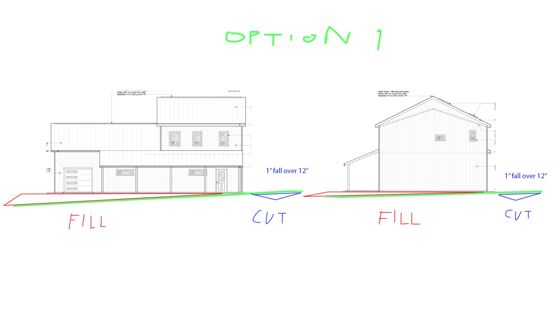

Hello All,
I'm building a house in NY and naturally the first step is to prep the building pad. It's my first time doing this so I'm feeling a bit nervous about the whole thing. I'm hoping kind, experienced folks can review my plan of action and give suggestions/insight. Much appreciated!
The building is a 32x56' pole barn with a 10' wide patio on the front of the building - 4' deep piers and 5" floating concrete slab - wire mesh and fiber mesh as spec-ed by engineer.

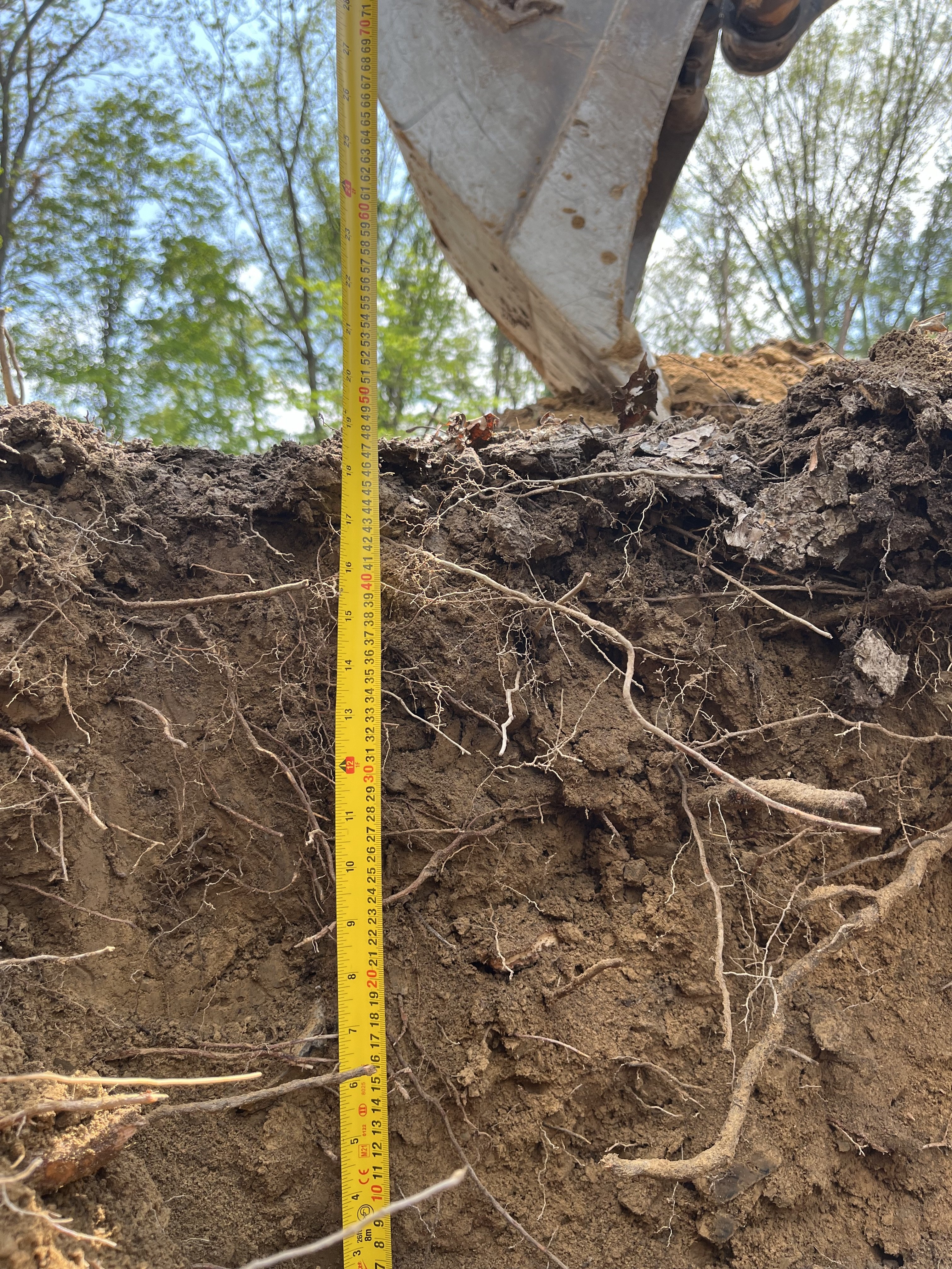

I dug a 24" deep test hole the other day...If I'm reading it right, the topsoil appears to be fairly shallow, about 4-6". It's not too obvious when looking at the layers, but the subsoil is quite a bit yellower.
So the plan is to:
1) Dig out 10-20 stumps under and around the building pad. These range from 12-36" diameter, thinking I'll rent a 30 ton machine for this.
-Is backfilling with subsoil or fill and compacting with excavator bucket enough? Or should I run a vibratory plate over these?
2) Scrape off the top 6" of a 52x66' area and put it in a pile for spreading later. Should be approx 73 CY with fluff
I'll do the same to connect the existing driveway to the new building as well.
- Not sure what the best machine is going to be for this - I can get a 75hp tracked skid steer or a 77hp Cat dozer locally. I've never run a dozer before so not sure how efficient I'll be with that. Would using the 30t stumping excavator for digging and skid steer for moving material be awkward/overkill? I feel pretty comfortable operating excavators but the biggest I've used is 12ton
3) Bring in fill and compact in 6" lifts. Back corner of building is high maybe 12".
-Do I have to bring the rest of the pad up to this grade, or can I make kind of a swale to push water either side? I'm in radon zone 1, so planning to install radon mitigation under slab. Engineer wants 6" gravel/crushed rock under the slab. Would it be worth doing 2" ROB and 4" clean gravel, or just use 4" clean for the whole thing? My wallet is hurting thinking about it.
4) Bring in crusher run to bring driveway up to grade
Thanks for reading!

I agree that it looks like I'd call top soil maybe 6", but it's not really a mater of the top soil, it's about removing organics, which includes any roots bigger than your thumb.
Backfilling a stump hole, the hole for a 36" stump, at the least, put somw.matwrial in (approx 6-12") and pack it with with the hoe, then add more, pack, add more and pack. Your never going to get to 95/98% density just packing with a bucket, unless we do it in lifts

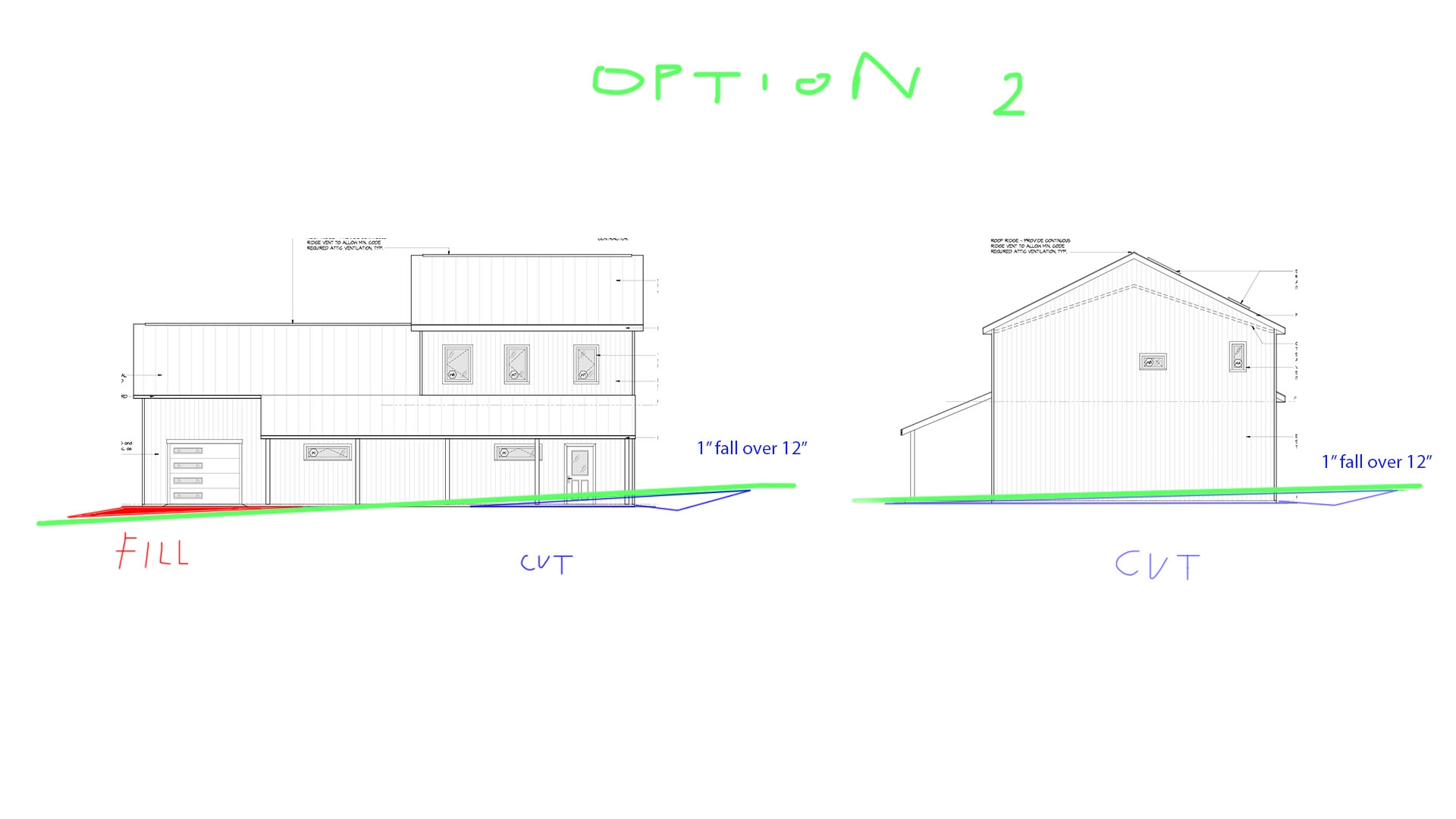

About the grading around the building, I wasn't too sure what I meant either but after thinking it through, I guess my question is can I do a combination of cut/fill (Option 2)? I think bringing more fill (Option 1) is probably the better way to go to keep water away from the building. It looks like I will have to cut a little swale either way to direct water away from the building, as I'm not at the highest part of the property. Am I thinking about this right? See attached pics below (blue is pole barn)
So my strategy will be to scrape off topsoil, spread and compact ROB up to 6" below highest side of grade (if needed, probably only on left side of building), and then spread and compact 6" crushed rock to match highest side of grade. Finished floor will be 8" above grade.
