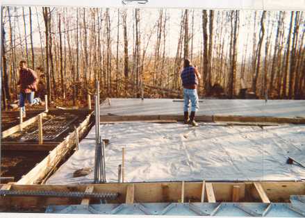

Good advice so far. It depends on alot of factors, you need a few people who know concrete. also, what the layout of the land is. Attached is a 25 x 40 barn foundation, fairly level and not that fussy. We had 5 guys ( all with alot of experience) hustling for several hours for pour and finish, along with setting the perimeter metal for the barn. I'm very happy with the results and would repeat it anytime, but there is a fair amount of prep work for leveling, stone drainage, forms, electric, etc. ( no plumbing in my case).

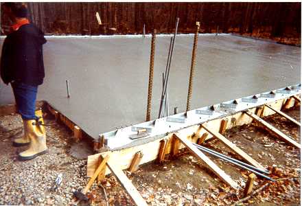

One more pic

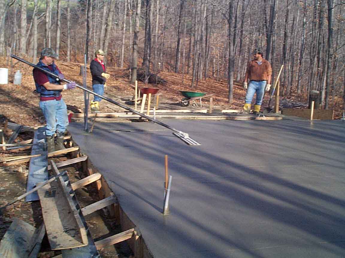

One final shot showing some bracing and some finishing.
