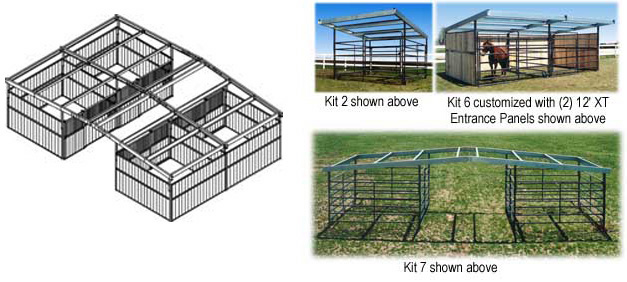

We have these portable horse stalls in one of our barns (by a company called "Behler") that are free standing & galvanized and super heavy duty. They use two inch boards that fit into slots in the metal framework. They have wide entrances and feeders too. I found out that the company makes a kit to roof 'em, so we are going to move six of 'em out into the south pasture for a try. They are a lot heavier than the sheds I have seen, and easy to setup. Also gives you seperate stalls 10X12 or 12X12 depending on the frame you use (we have a quantity of both). Should go up in a long day.....see attachment for their pictures, ours will be fully enclosed on three sides with half front on each stall (winter is COLD). In the summer we just pull some boards for venting.
I would love to see your pictures! I'll be building some other sheds soon, and always like to see how the other guy does it. That's how we improve!!
