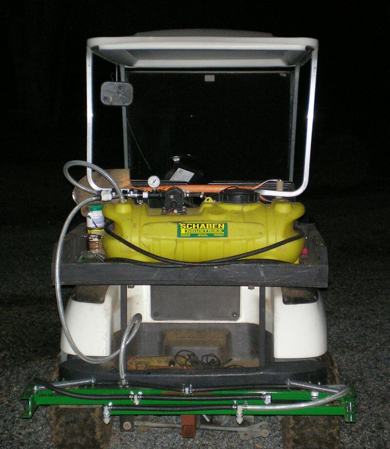

However, I did add a boom sprayer to my golf cart this "season" ... so maybe that qualifies as prepping. I've had the spot sprayer for a while. Bought the boom last year ... at the wrong time to make use of it. Fabbed up a mount that plugs into the receiver hitch on my cart and plumbed up the boom, bypass, etc. So far so good testing w/ just water. Had a bit of snow and rain the past few days so will give it a run this weekend :cool:
