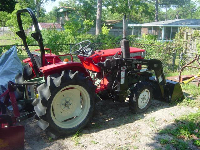

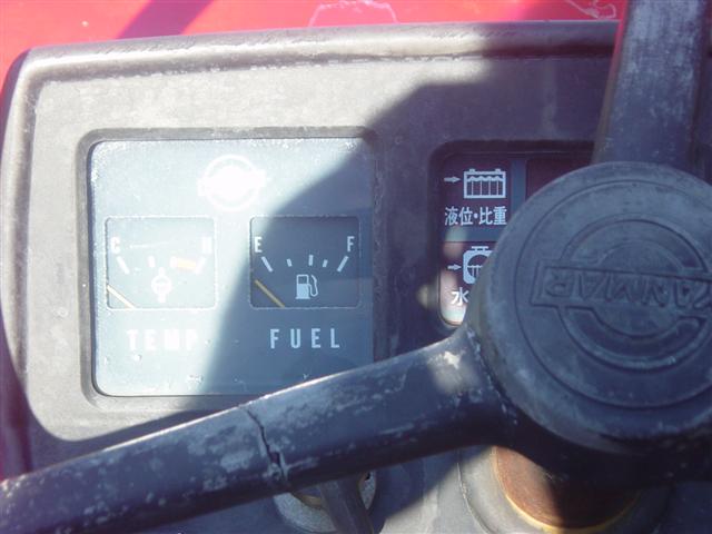

I know how to plumb one in, just don't know of a good location for an oil pressure guage. Would you even bother considering it is a BD?

Right Side Panel

Overall picture, but you can see the area around the panel pretty good.

2 Ideas come to mind. Get a gauge.. like a mini-sunpro. The come with a small bezel/ mounting bracket.. and you can just tuck it under the dash. Or you can put the gauge directly where the T-off for the sender is.. like on a IH-CUB or an ALLIS G.. they have the oil pressure gauge mounted right at the block to pick up oil pressure.
If you are running the idiot lamp T-eed off.. you will still have your dash warning.. but if you really want to know OP.. you can look over at the side of the engine and get the real pressure.. etc... No capilare tube to run either..
