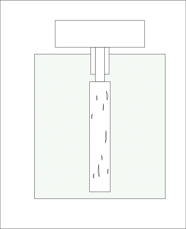

ejb-
I'm planning on the same thing for a portion of my barn - to make that end a wood shop - and keep the other end for a future concrete floor for car/tractor/vehicle in general - work...
Attached is a cross section of a post - sound the same as your project.
I decided long ago in the initial thoughts about this that PT (although nominally more) is a lot better way to go for years of life.
My plan is to actually dig some trenches that the 4x4 posts and the 2x12 beams will be sitting in... the top of the concrete pier that holds them will be well below that actual grade. One the piers are in and the posts are attached - the trenches get lined with heavy plastic to ****** the water dampness of mother earth from working its way up. From there the 2x12's will get attached to the posts... then 2x12's get laid on as joists... all PT.
Certainly the ends will be vented...
Going to run lots of electric... lots of dust collection pipes...
Then between the 2x12 joists - I'm blocking them and them placing 2" foam board on the blocking for insulation. Then the top is going to be 3/4 TG ply - the stuff that is "moisture resistant" - not PT.
VABlue - I'd be a little concerned - even with cross venting - about having 2 layers of moisture barrier... for the same reasons you don't do that in a wall...
