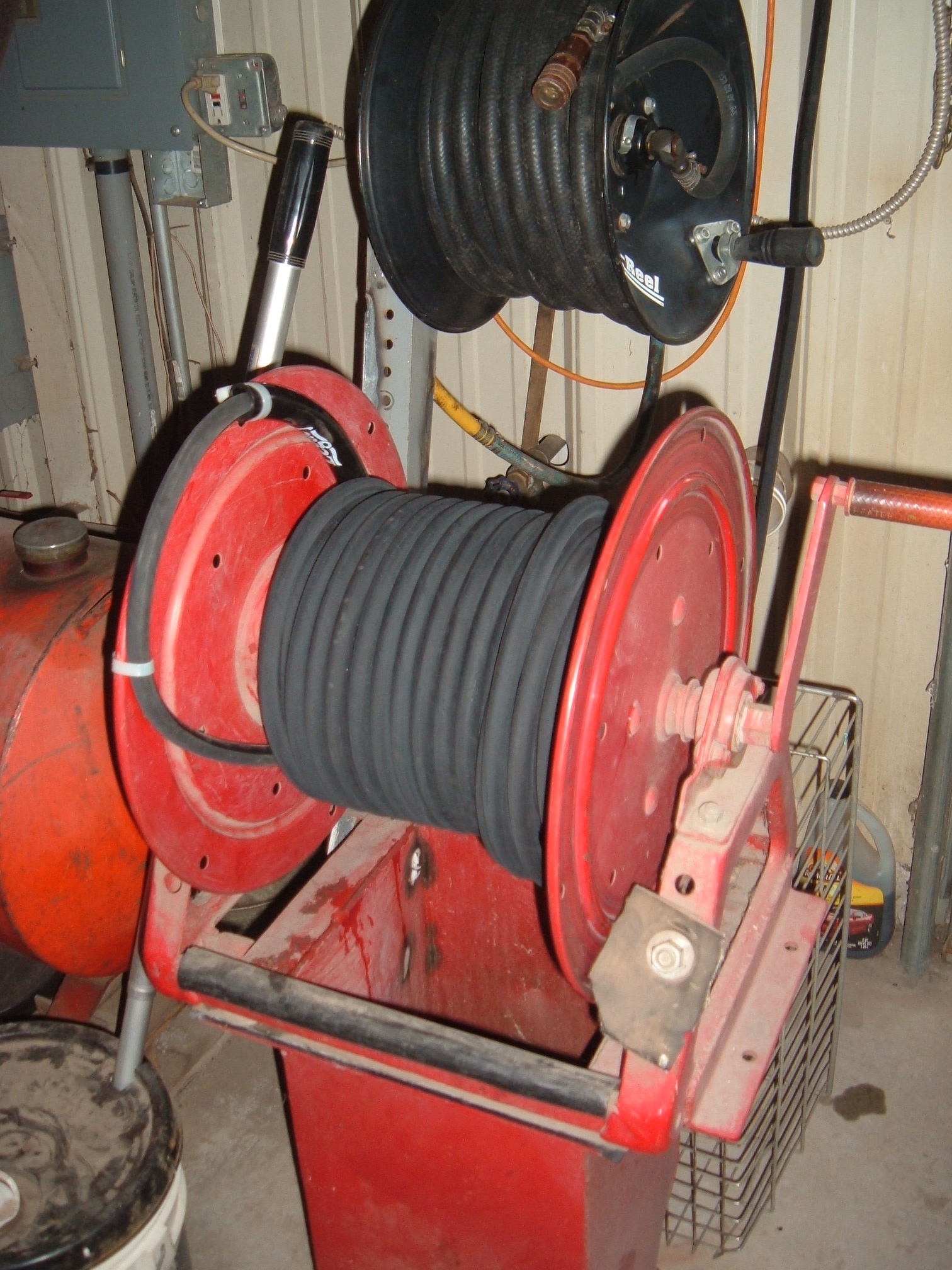

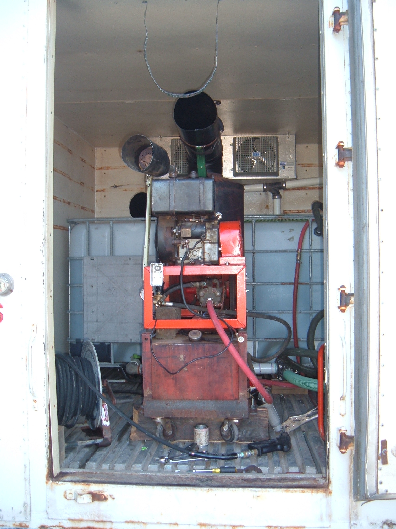

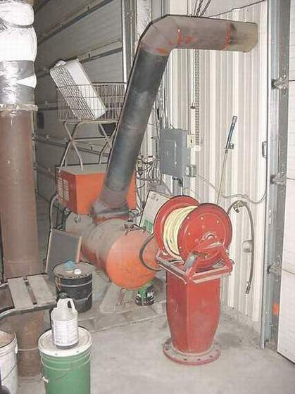

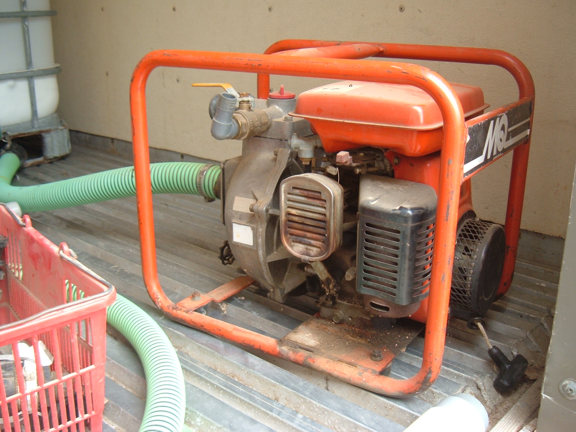

On portables, trucks we used to recirc anti freeze in a bucket. You can blow them out, can use heat which is my preference. Use 2 lamps in series though. I have one in an insulated box on a truck doubles as a fire truck but have the shop inside and heated, hose thru wall with outside controls. 5 gpm @ 200 degrees, can melt ice and clean grease. I wash a car about every day.

It does so much work and compared to the depreciation on just one new car it's nothing. If I was starting over and going to pay men would get 1 size bigger and connect to L.P. it's kind of a run what you being kind of deal though, I got it in my mid 20s and had visions of some kind of portable. I used it remote about twice, never moves. 100 ft hose.
