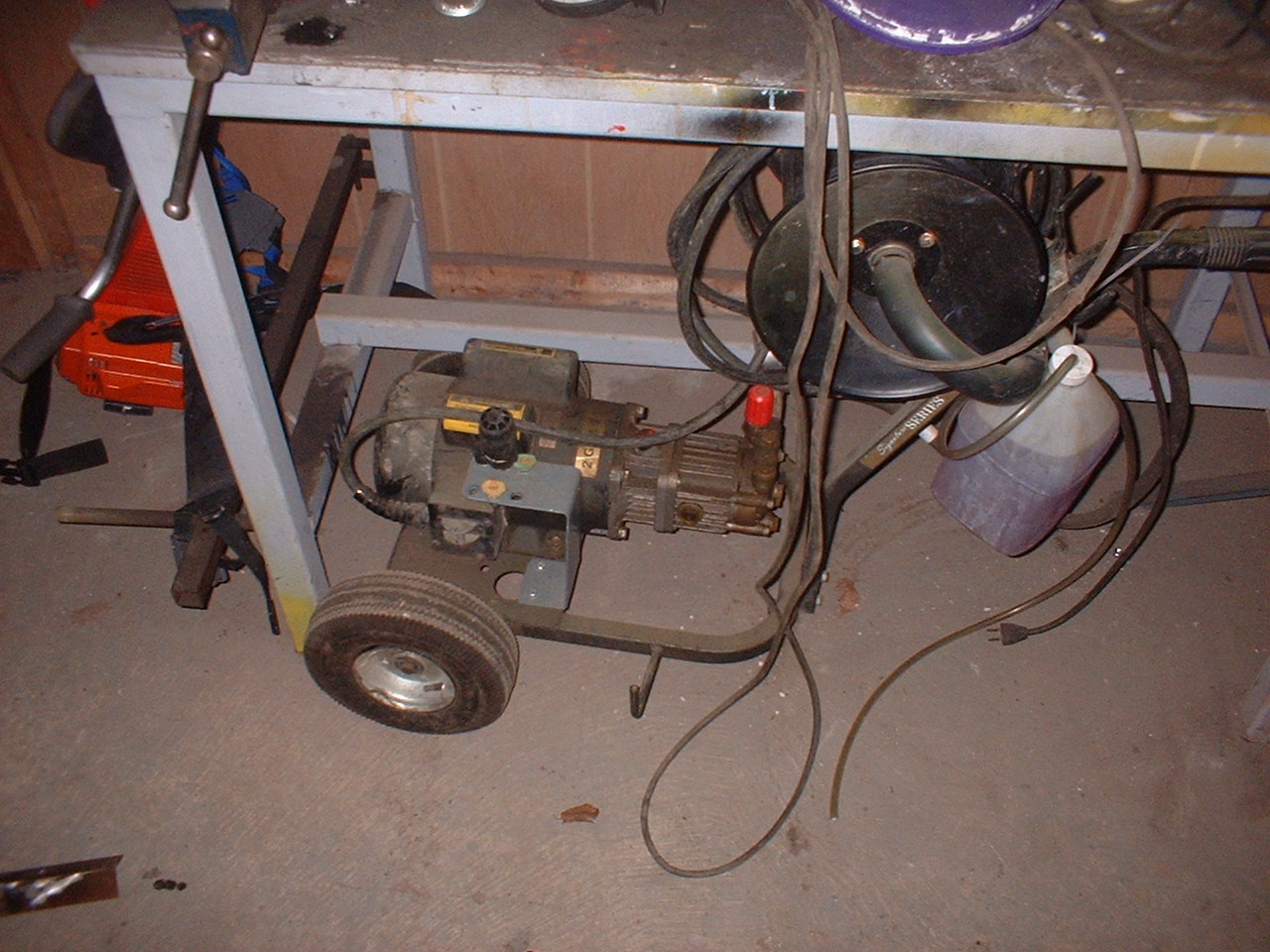

Im gonna purchase one .The hose is a bear to roll up ,and make stay put.Ive even added a rim from a car tire withsome iron bars on it,and its still a pita.Im looking at the ones in NORTHERN.Would someone who actually has one give me a thumbs up/down on what to purchase.It dont need to hold alot of hose,but needs to mount on my pressure washer,with small attachment hose,sort of like how thw air reels work. Thanks in advance

I have a 50' hose on my large pressure washer. I didn't want to spend the big dollars on a high pressure hose reel with a HP swivel since mine is not used for commercial purposes. What I did was put a quick connect at the pressure washer to connect the hose. I then found an inexpensive garden hose reel at a local box store and installed it on the washer. Now, I just unroll the hose before using the washer and then hook up the quick connect. Before rolling up the hose, I unhook the quick-connect. I have to make sure I roll out the proper amount of hose or all of it before starting, but that's easy with the hose reel. When I roll up the hose, I hold the hose with a rag in my left hand while using my right on the reel crank. That way, I clean the hose as it goes back onto the reel. Works good!
Edit: The prices of HP hose reels may have come down since I first built mine in 1997. In those days, you had to go to a pressure washer dealer. Now, every box store and Northern Tool carries PW supplies. I haven't priced a reel lately, but they were around $300 in 1997. Since I paid $400 for my whole pressure washer and refurbed it, I wasn't going to spend 3/4 of it's cost on a reel. If you can get one for 1/2 that (around $150), it might just be worth the money.

I have one. It works good. First one i had blew the seal in the swivel. THe new one hasnt had any problems in 2-3 years. Its worth the $50 or so for the convenience. I posted a pic of my setup, not very neat but you get the idea.
