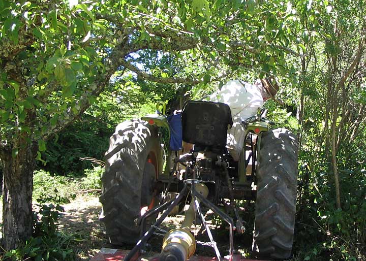

Thinking seriously about this, I should probably be downsizing now that I've completed my big projects. Now the main uses are the loader and mower and this YM240 is kinda big for mowing in a orchard - see attached. But it runs good so I'll probably keep it forever.
Maybe a 1401D is what I really need.
Thanks again for your comments!
