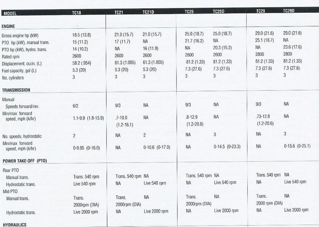

Are you sure on the Live PTO thing. My New Holland TC29D has hydro so it has live PTO. The 29 with the standard transmission does not have live PTO. All 4 x 4's from what I know don't have live PTO. Live PTO only means that you can change or alter the direction of the tractor without changing PTO speeds. Standard transmission unless it has a two stage clutch is not considered Live.
The TC30 with the Hydro option would be considered Live PTO.
specs attached
murph
