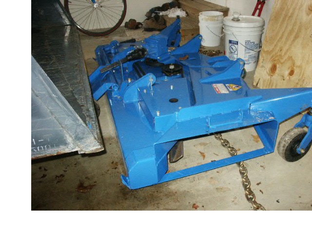

The price looks to be in the ballpark of what many of us have paid. I have the 60" MMM and it works fine, but it doesn't give you a lot of room for edge work. I picked the 60" so it would fit in my shed. Also, I noticed some scalping especially by the chute opening. I had my dealer weld a bar across the bottom of the chute. I've only mowed once this year, but it looks like it helps.

I think I will have that done. Most of my scalping comes from going up hill and then I change to a level spot. I try and lift the MMM up a bit when I hit that spot but I still get the scalping. That bar may just help.
