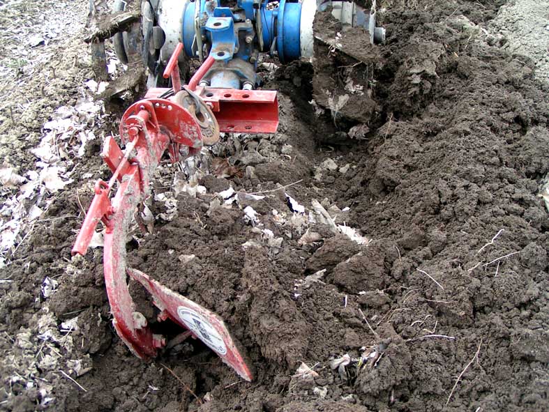

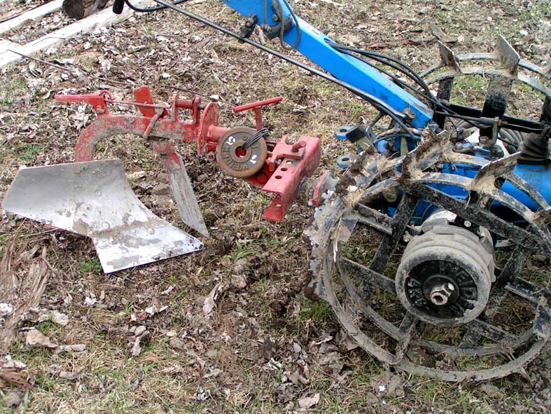

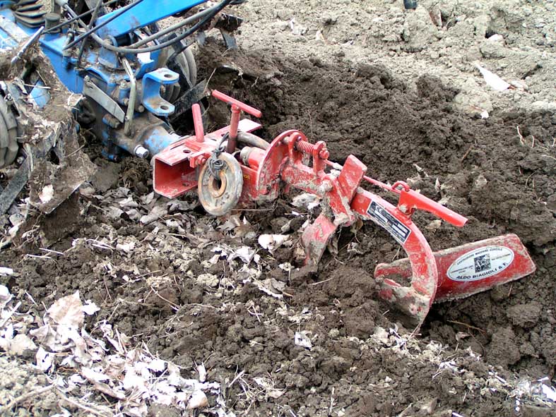

HI! Moldboard plow is a good implement. No dangerous for operator. You cannot brook tractor gears. If you hit rock wheels spins.
But Make good plowing is ART. Adjusting the moldboard plow is not easy. Need some try.
For plowing you need good traction and the best is more weights .Duals are not good. I like tire chains because self cleaning
For me. I built steel wheels with 4.5x 2 in pads. Spacing is 16 in. between or inside tire

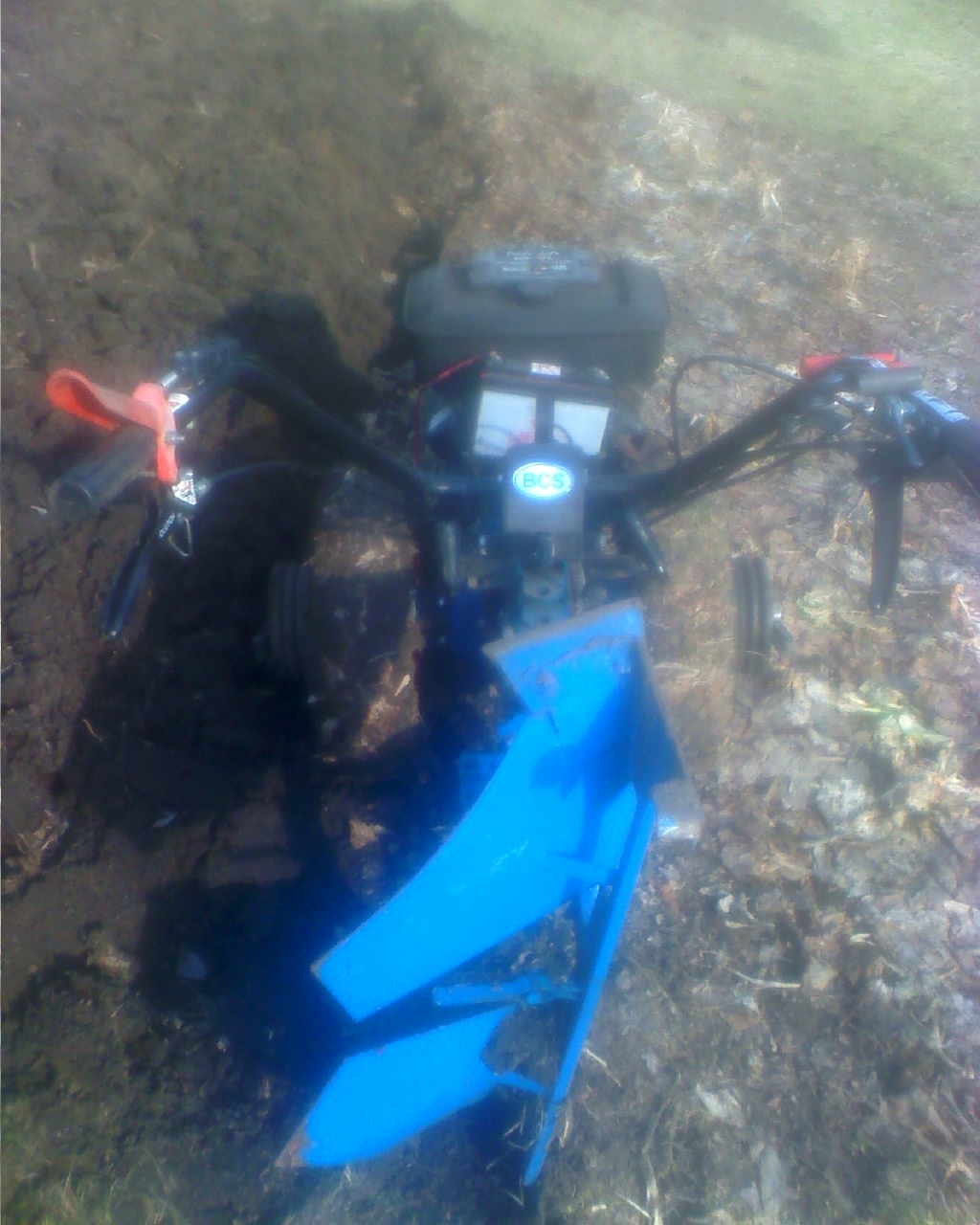

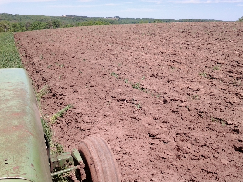

You need weight, traction, speed, and clearance to moldboard plow. A moldboard plow will never do as good a job as the rotary plow, but it will do a decent job if you fulfill those 4 requirements. This is a picture of me plowing with my 850 when it had the V-twin Briggs from March 2009. From what I remember, the plow didn't really invert the soil, it just sort of pushed it to the side. This is very mellow black dirt that had been rototilled the year previous, not hard clay I didn't have the speed or traction required. As you can see, I had old turf tires on the tractor. Speed is a big concern. When moldboard plowing my farm ground I am going 4-5 mph on a 14,000 pound tractor pulling 5-18 inch bottoms. I'll attach a picture of that from this past spring.
As far as setting up the tractor, you just need to put the plow in the hole on the toolbar that gives you the proper bite - about 10" per pass. If you have the 2-way plow, you need to have both sides set up the same -20 inches-ish inside of tire to inside of tire. Duals aren't gonna work at all because you have to be able to drop the one wheel in the furrow. It's going to be a workout, the machine will constantly want to turn into the plowed area. locking the diff will help, but your job is to keep it from turning
