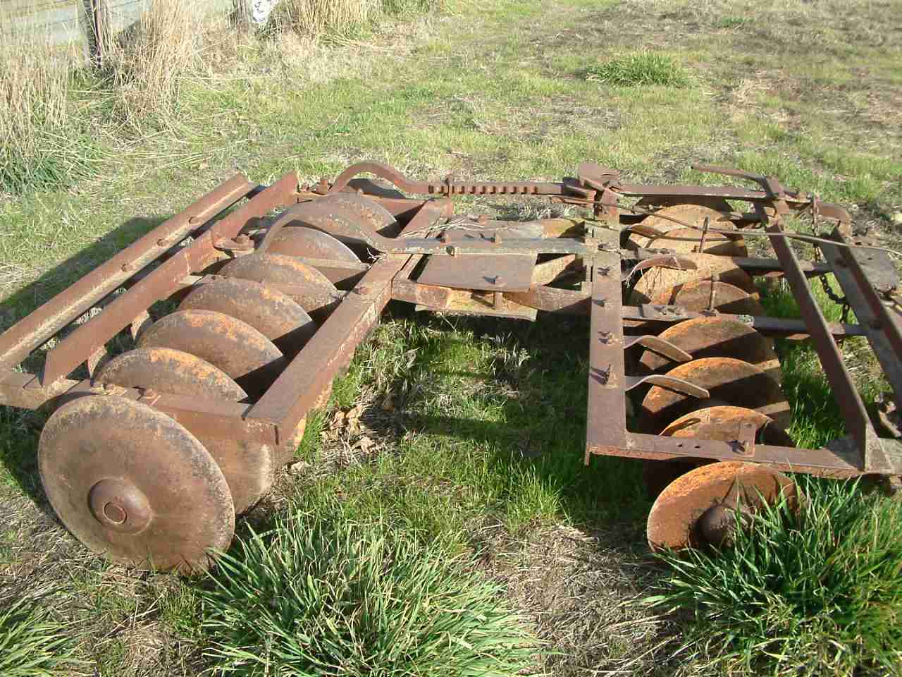

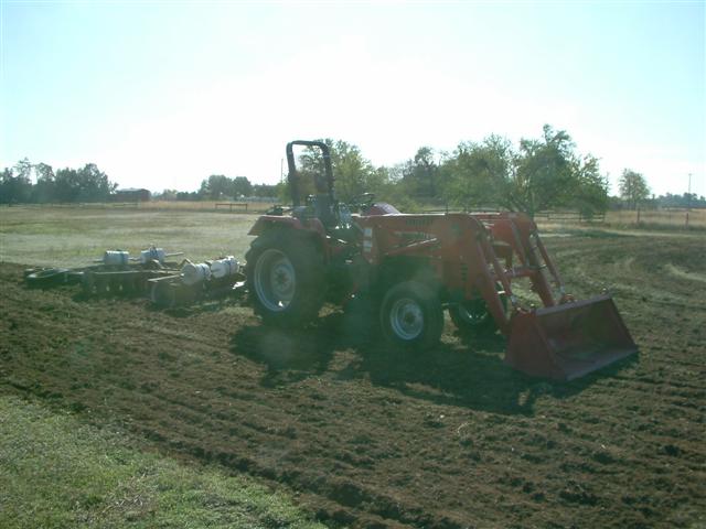

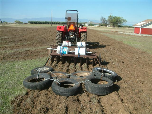

You only need to plow it once to break through the crust. The $200 solution is a combo middle buster plow/subsoiler. You'll log a bit of seat time doing 20 acres this way, but from then on your 8-ft disc should work OK. Why pay big bucks for a 3-bottom plow that you'll probably never use again?
My primary tillage is done with an old 7-ft wide Towner offset disc (a present from a neighbor). I add about 500 lb of concrete weight to get it digging properly.
Good luck.
