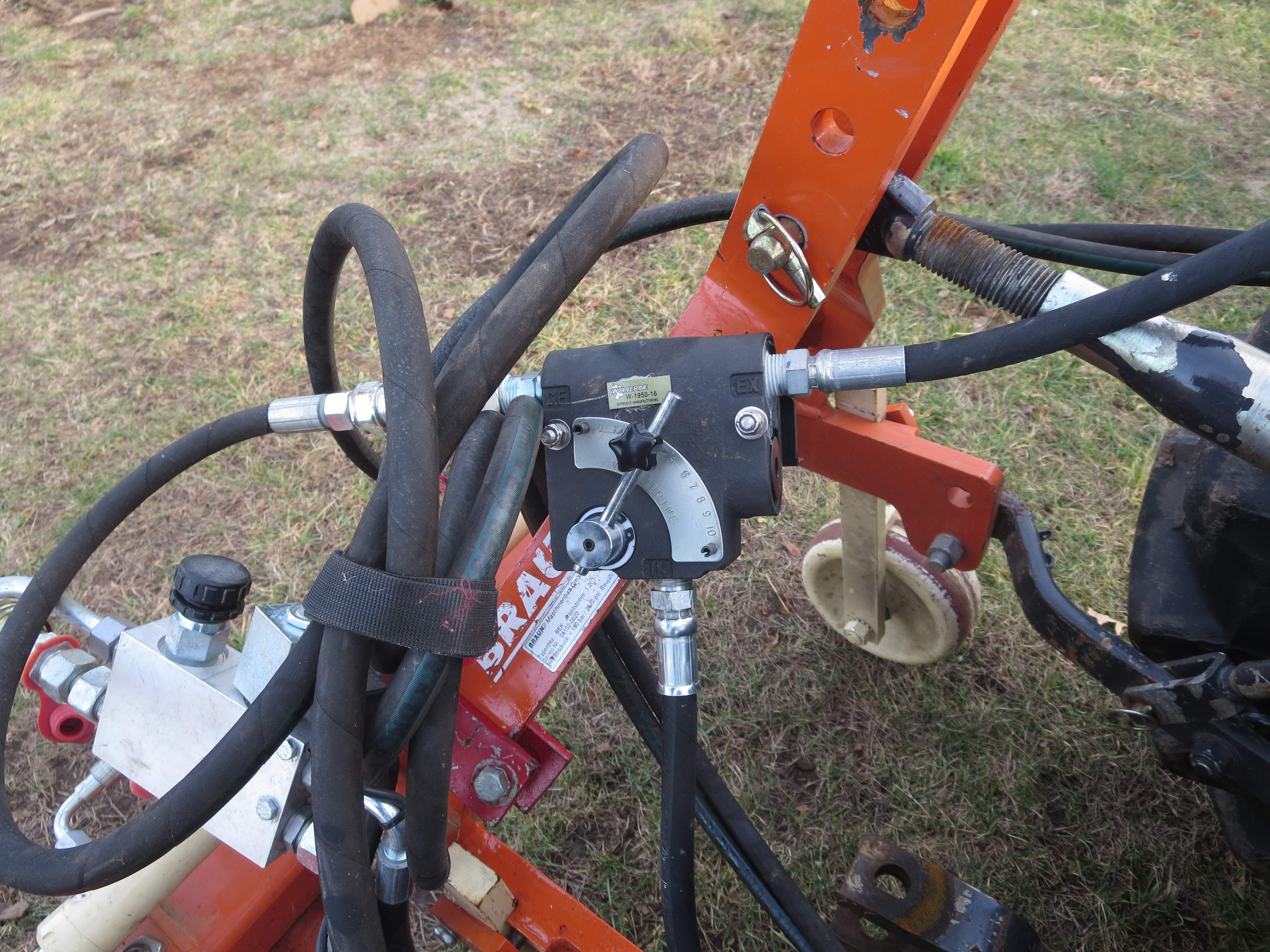

Haole:
Also, are you sure that you didn't get some "straight" pipe fittings instead of NPT, or BPT (british pipe taper)? Lemme back up - the more usual scenario, is buying valve/flow control with straight fittings which will take a taper, but for obvious reasons you can't make it seal. That has been a problem at a few jobs I had working for a british company....
Agreed what others have said, they they aren't as common, ordering the valves with straight thread and an O-ring boss, and oringed fittings is really really nice to work with. Again, a little harder to find but it makes you wonder why NPT is still the US standard....
