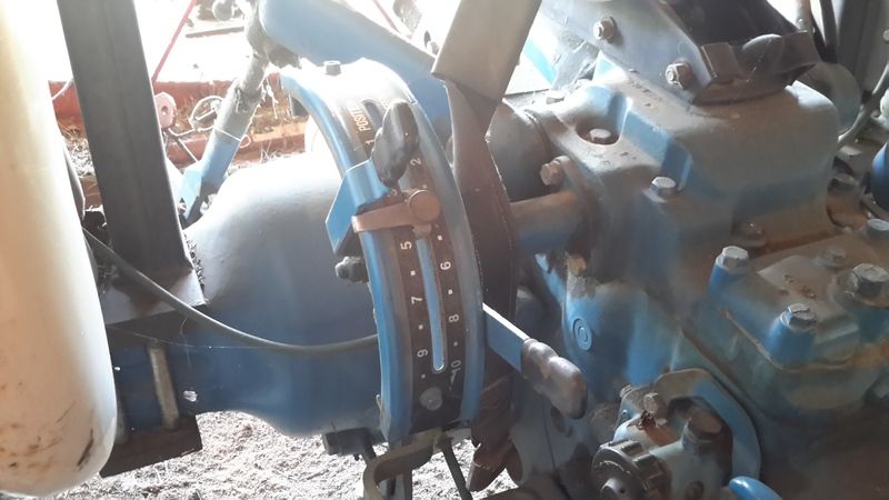

I am not sure it has Draft Coby, I am not even sure it has position control. Maybe. Some pictures would be nice. :)

<a href="http://smg.photobucket.com/user/lundy/media/20180508_151544_zpsdtrzseai.jpg.html" target="_blank"><img src="http://img.photobucket.com/albums/v302/lundy/20180508_151544_zpsdtrzseai.jpg" border="0" alt=" photo 20180508_151544_zpsdtrzseai.jpg"/></a>

It does have a Draft control. I am not sure how it works. I have pictures but am having trouble posting them. What do you all use to post pictures.

The Draft control lever is all the way down. I guess I need to move it midway. I think I have the right hydraulic oil in it. It is John Deere low viscosity hi gard transmission and hydraulic oil TY22000.
