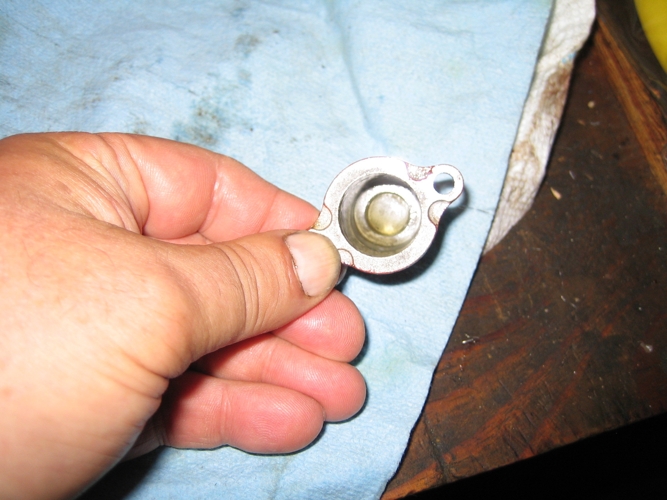

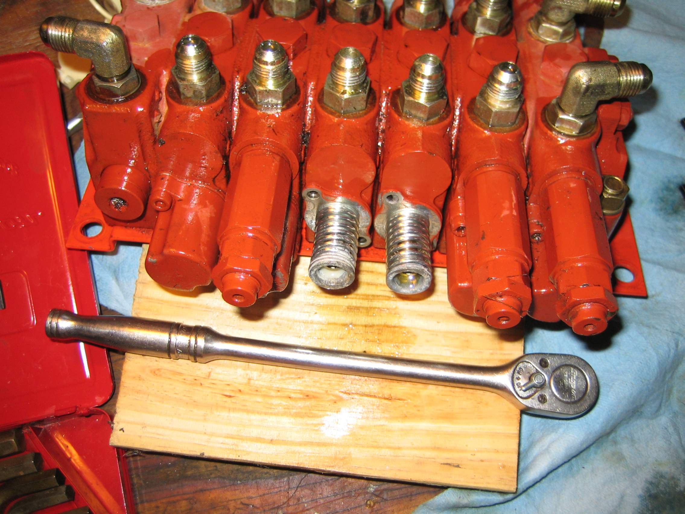

2. Removed valve body/control unit from backhoe. I first pulled the left rigger cap and was sprayed in the face with hydraulic fluid/water. I was surprised. I told you I was dangerous. The right rigger cap I wisely placed a rag over it when removing it was under pressure too. I did not remove valves, they moved freely once the caps were off. The caps were filled with a yellow cream like substance which I assume was water and fluid. The inside of the caps are corroded as well as the lower part of the spring.

007 L/rigger cup
008 R/rigger cup
009 Valve body
