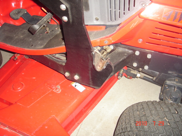

Anybody having problems hooking up 120 loader on their 1643? Main pins not wanting to line up even with rolling bucket back.

When I had similar problems on my 2310, I discovered a small amount of dirt in the lower "sockets" where the loader lower end pins rest. Clened them out, and everything fit OK then. Doesn't take much to cause an issue, perhaps just a few grains of sand. You might check that out; hope that's all it is!
I am not entirly familiar with the massey set up, but i thin it is similar to the kubota.
On mine, sometimes the cylinders get out of whack. Meaning one is extended or retracted more than the other. Usually due to parking on unlevel ground or when pulling up to the loader, not being square, and bumping one of the uprights, which causes pressure in the cylinder and the fluid goes to the other cylinder and causes it to move just a little.
To fix (at least on mine) I pull up just close enough to hook up the hoses, but still be several inches away from "docking", and press the joystick forward (lower). This bottoms out the cylinders and lets them get back in time.
