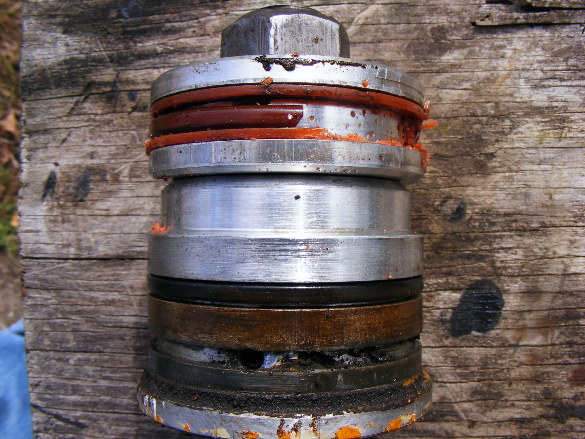

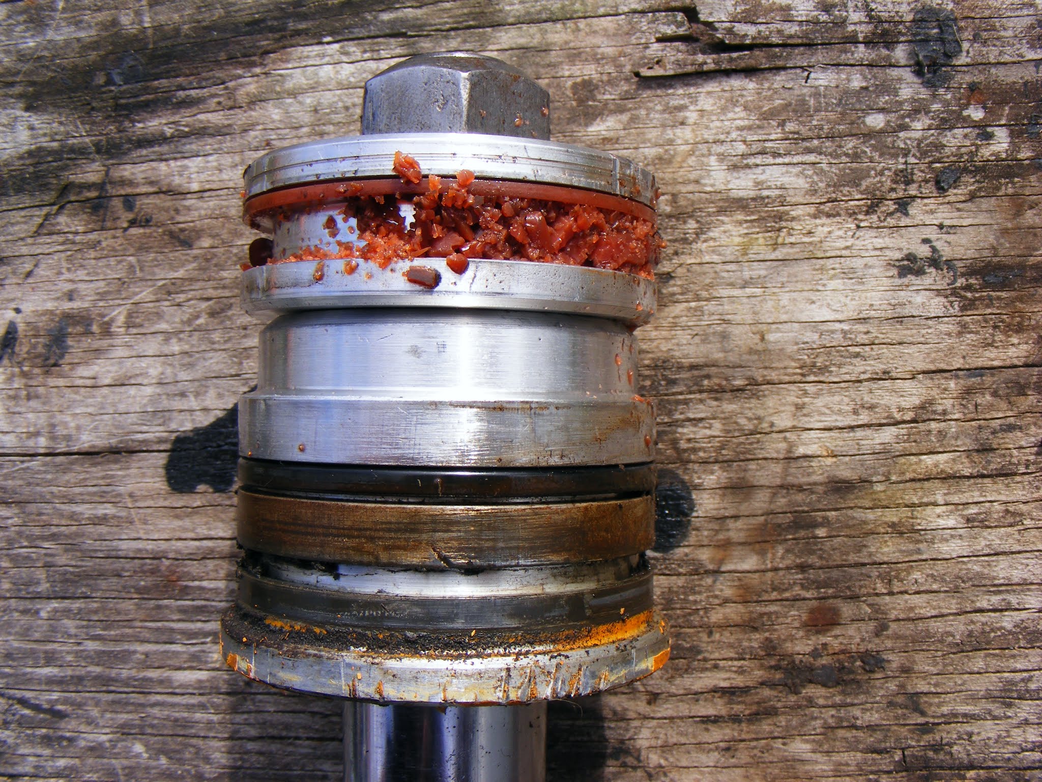

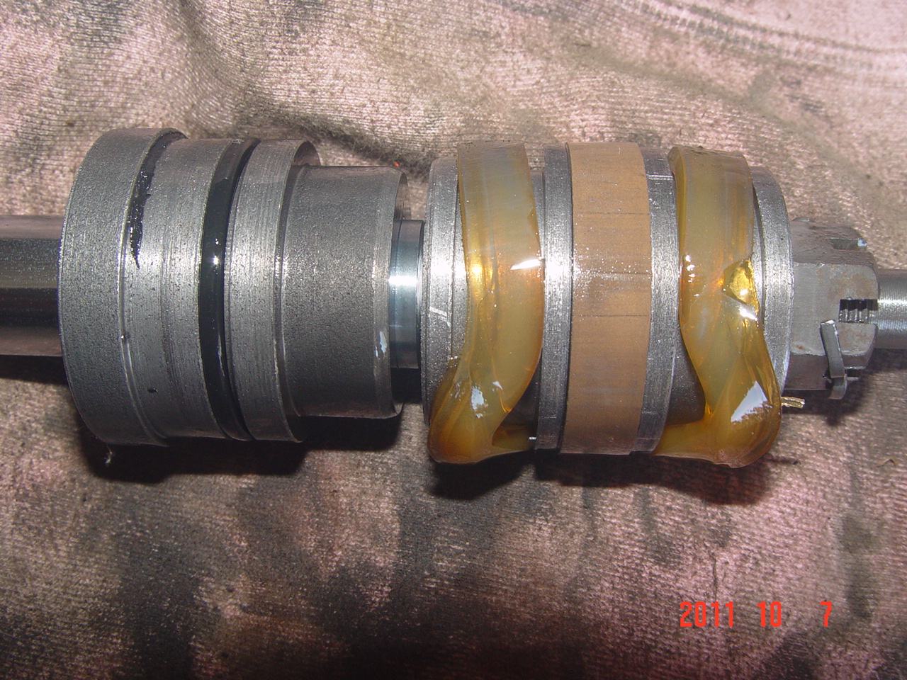

From what I can tell from all the diagrams is both sides of the pump are putting out fluid until it reaches 500 psi back pressure then it opens a unloader valve on the high volume side of the pump and it just circulates and lets the high pressure side continue working. So it sounds like that unloader/bypass valve is hanging or sticking for a fraction of time. The fact that it does work and does its job other then the delay eliminates the cylinder seals , the symptoms would be the opposite of yours, if it was bypassing the seals at 500 psi and 11 gallon a minute going up to 2500 psi and 3 gallon a minute would creep at best.The two sides of the cylinder become one with some restriction. You might pull your filter and see if there is any foreign material in it, I will attach a few pictures of my cylinder when the seals went bad , one is the power steering off the Jinma and the other is the fel cylinder from the case. DSC07328.jpgDSC07329.jpgDSCF0441.jpgDSCF0442.jpg
   / Problem with MTD 25 ton splitter - 4 second delay to 2nd stage #10
That's a nasty looking set of seals. Looks as if the Jinma one was overheated or else a real lousey set of seals.......Mike
