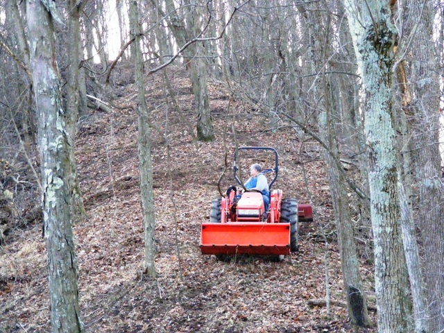

I run my R1 tires set as wide as they will go and I thought it was a bit wider than the R4s but I could be mistaken here is a pic and I will not change mine I run on the hills and I like the stability.I do a lot of FEL work, use a grapple and I don't have a problem with this configuration.
