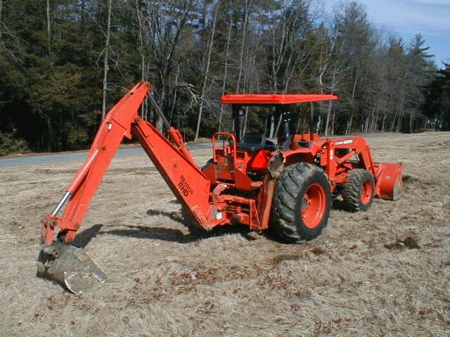

The L5450 was sold thru the mid '90s. It's rugged. This pic shows my rig with the backhoe mounted. With filled tires it's up a little over 9,000 lb. (about 2100 of it is the hoe) More details in this review and more pics and info in this thread about some pto changes I made.

Thats quite the tractor. 5 cyl.. I guess it would be hard on fuel .. I have a dyna hoe back hoe that weighs about 24,ooo pounds and that only has a 3 cyl .. Bill
   / Problems with brand new 4330 #7
k4330, that 5 cylinder DI is quite possibly easier on fuel then your 4 cylinder IDI. It's probably the best diesel Kubota has made. My 3 cylinder International loves to use the diesel. My 3 cylinder Kubota is quickly becoming a favorite. It's smooth and quiet as well as being pretty easy on the fuel. My guess is about 1 gallon per .8 hours or about 8 hours on 10 gallons. Frankly, I have not been very careful about checking even though the new intellipanel makes it soooo easy. Your 4330 is a superb tractor, my second choice.
