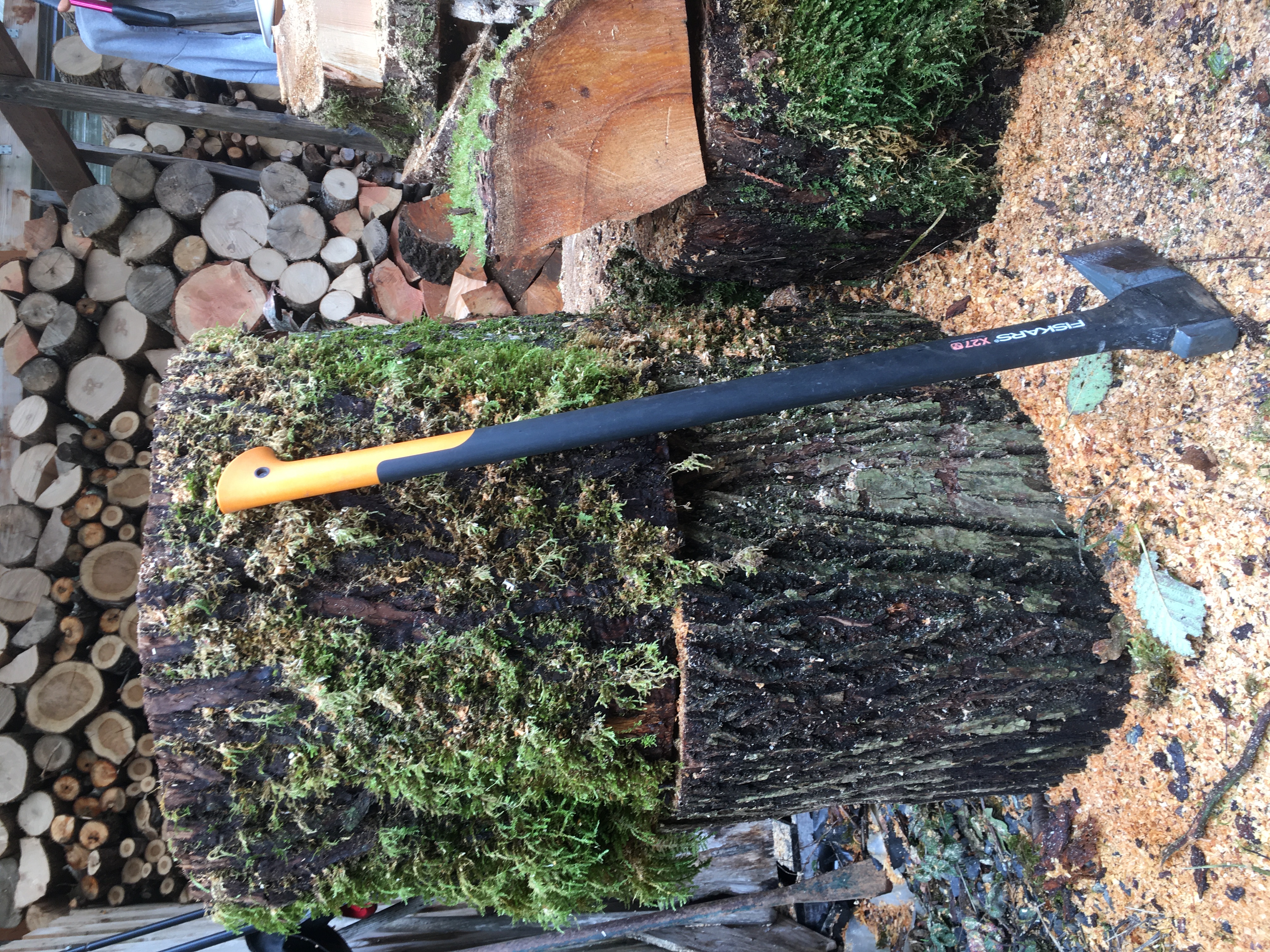

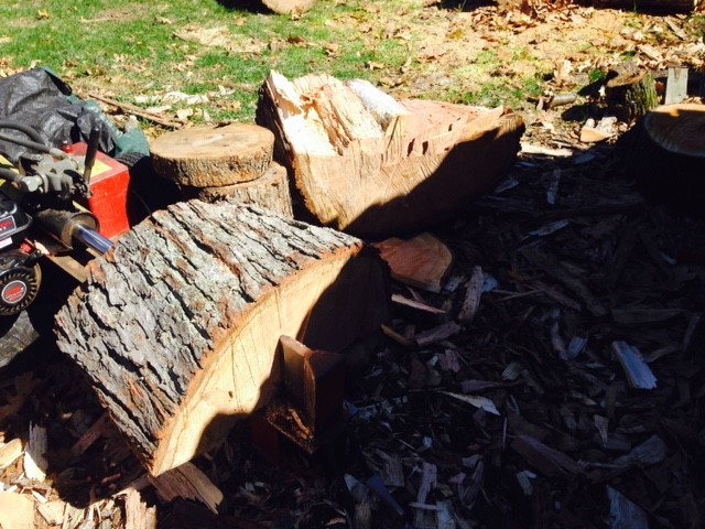

Just started processing some maple i had taken down, next to the house. Big leaf maple, about 110' too close to the house and as it turned out, one of the larger limbs was half rotted on the back side. I'm not too familiar with maple and was a little surprised it split as easy as it did, even when still green.

You might want to pull bark off some decent chunks and set dem aside fer projects as time passes. Really hard to build much from ashes.
Might want to throw some old paint onto ends of chunks you saving too.

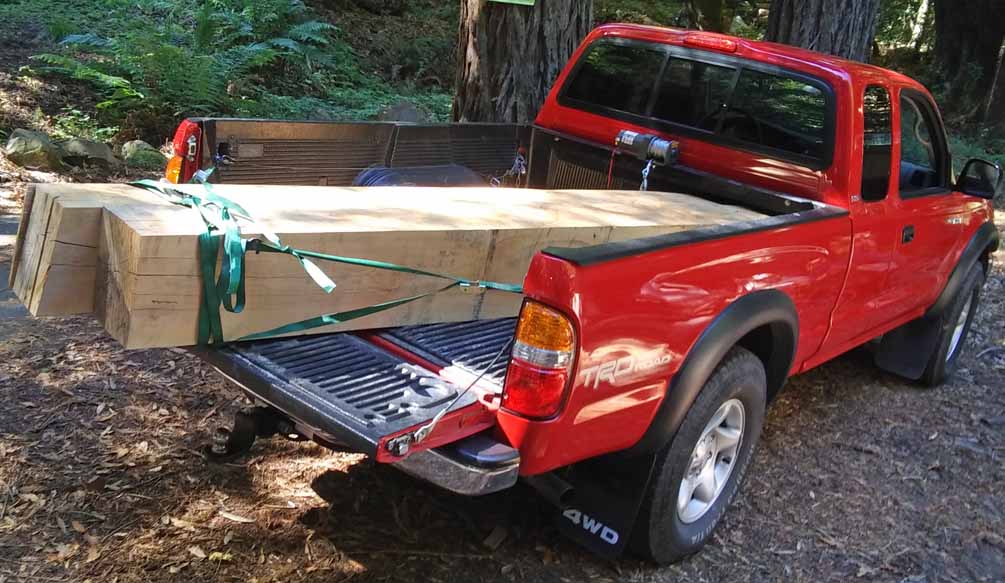

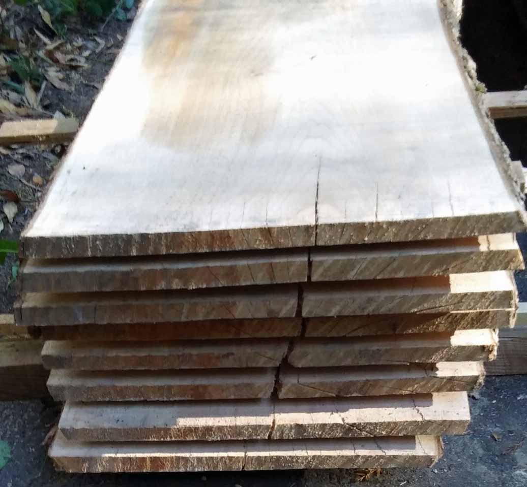

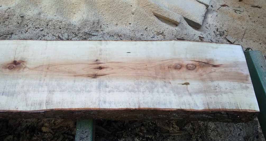

I burn a lot of BL Maple where I live. It is a soft, fast-growing maple that often falls with little warning. It is not like hard maples, like sugar maple. BL maple splits easily (wet or dry), and does not rot quickly. I recently has a 30-incher fall near my workshop, on a 100% slope.
I also mill maple logs into planks and slabs, and use them for various projects. They also make great Dutchmen.
Probably a different variety of maple than we have in New England, but I've found that our sugar maple splits quite easily when green...sometimes easier than when it's dry.

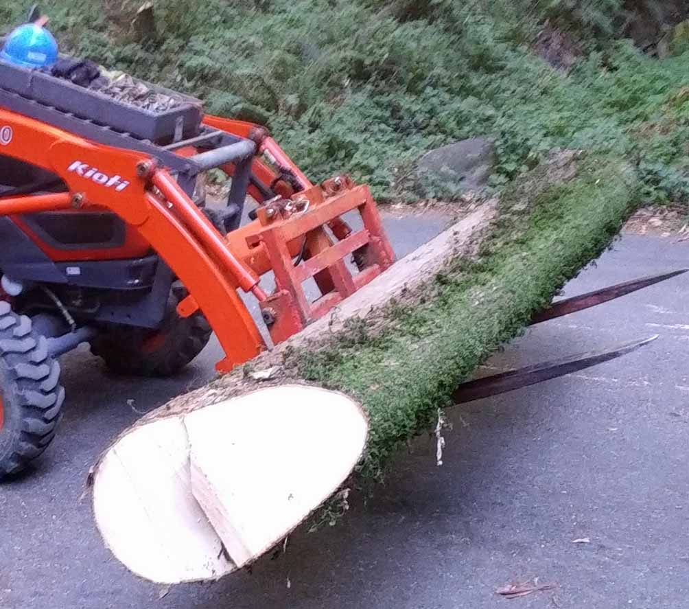

Yes, for sure i can't pick them up. I"m only guessing but tractor lift 900lb at the plate, the largest piece, not shown, would pick the back end up if i turned the least bit, but straighten out the back end would slowly go back down was still very light and bouncy, which made turning kind of interesting. The pieces shown, maybe 400lb, made tractor pretty light on the backend. I've quartered it, then i have to cut 4 - 5 inches off the length, so it fits in my stove, i can pick them up and stack it in the wood shed.

Back in April of 2017 I took a maple tree from a friend. It fell on his house, and I helped him remove it. We tried to cut it in 16-18" thick rounds. Some of the rounds were well over 36" diameter, as I couldn't cut through them with my 18" saw and I had to quarter them.
This piece was 31" in diameter. I rolled it up onto the splitter by hand and halved it. Then quartered it. Then split the quarters, etc...
I ended up with 58 pieces of firewood from that 1 round.

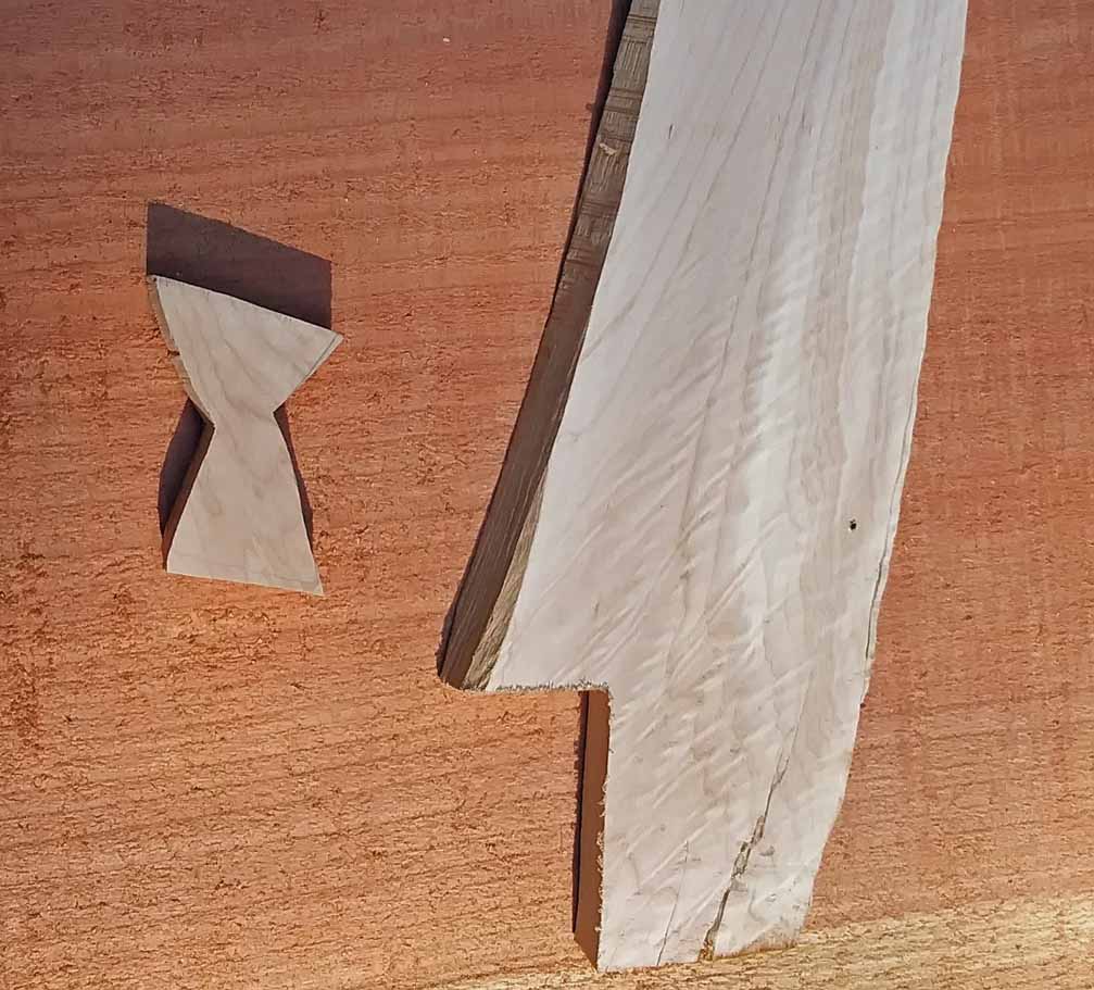

If a limb is growing at a good angle, like 45 degrees, the wood growing in compression will have a fiddleback pattern. It's much prized by local wood craftsmen.
Yes, indeed. Recently cut this dutchman from that 30-inch BL maple that fell this last summer. It had at least a 30-40-degree lean.
