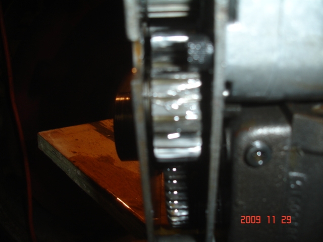

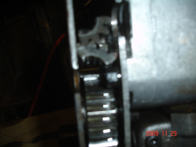

Split the 180 today to see just what is going on. Found the gear on the Aux. pump split in 3 pieces, 3-4 teeth missing on the idler gear, and the pump locked up tighter than a bulls fanny in fly time... At least the main drive gear wasn't damaged.
Apparently that's what that "crack" in the tranny was this summer, when moving it, from one barn to the other. And here I thought maybe it was one of the balls in the brake actuators got hung up... I wish....
Looks like the bushing's on the plate assembly are shot too. When removing the line to split the tractor, I laid my left hand on the aux. pump, and it kinda' rocked... I knew this wasn't going to be good... I figured there may have to be a little play in it..., but not THAT much..., LOL...
So looks like a new pump :eek:, a couple of gears, and some bushings to start.. And a real good flush job on the rear housing...!!
Just can't help but shake my head, when I see the way some of the things were designed on this tractor... Especially the aux. pump setup...

Here is a pic of the internals of my Aux pump. Not pretty... Broken gears galore, and a gouged up pump housing...
But..!! Had the main pump rebuilt, and a new Aux. pump... Also had the IPTO clutch rebuilt while in there. Did manage to get them in this evening. Hopefully by weeks end, I'll have it back together...
