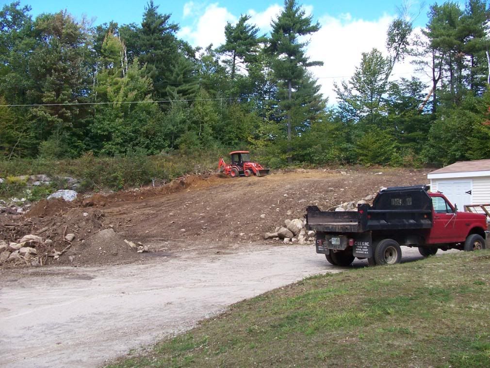

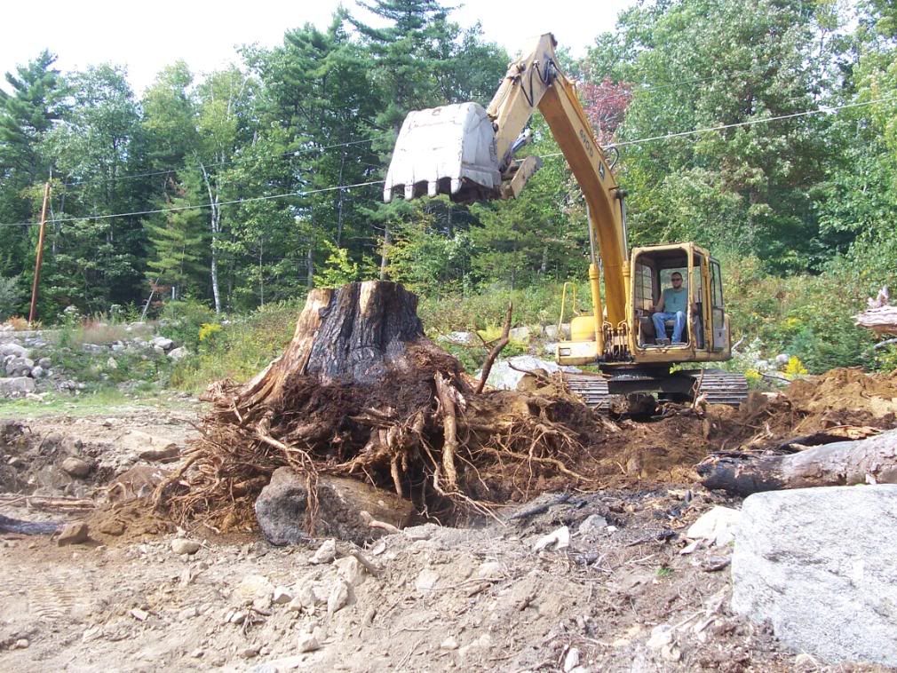

Here is what I have been up to for the past couple of years. When we bought the house brand new in 2005, the contractor had only cleared just enough land for a driveway, house, and septic. I wanted more yard to grow grass and do some landscaping. The biggest concern was two very large (36"+ diameter) pine trees that both stood over 80ft high.:eek: Those will be taken care of by a pro.
ALL PICTURES ARE THUMBNAILS, CLICK PICTURE FOR FULL SIZE IMAGE
Here are a few pictures of the yard just after we bought the house.
One big problem was that the yard was holding a lot of water and flooding so I knew I needed to clear it and grade it for drainage.
Here is what the yard looked like after 1 year of working on it with my little tractor. This picture is after all the small stuff had been cut and just one large Pine tree and a few hardwoods were left. You can use the well as reference, it was on the treeline and now is in the middle of the driveway.
The Kioti made wood clearing look like fun.:cool:
I did have a little help clearing the brush from mother nature.

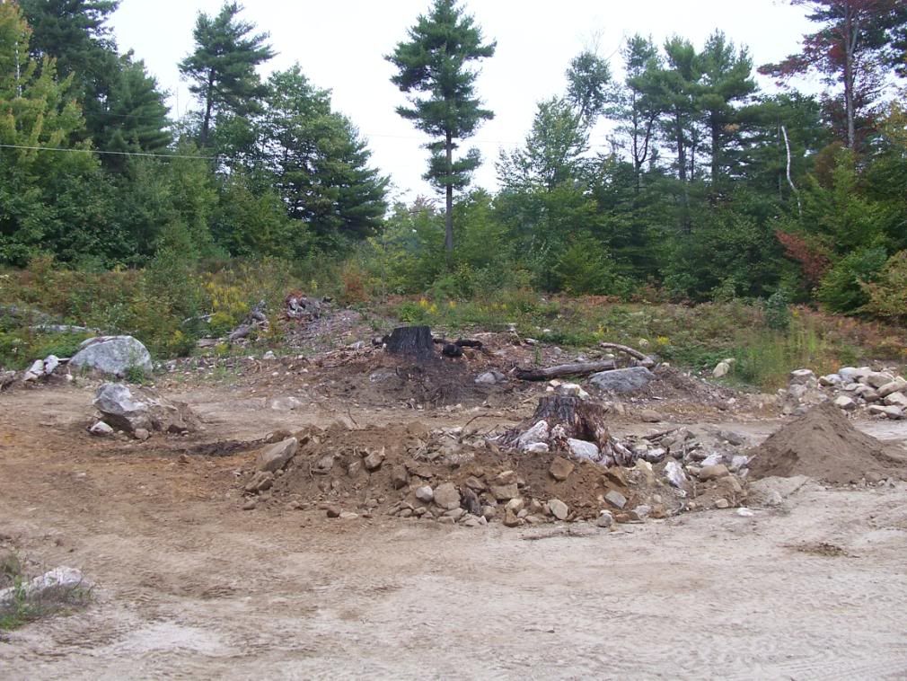

And here all that was left were the two huge pine tree stumps and a hill that was very uneven and steep, too steep for my tractor.

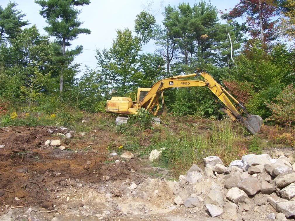

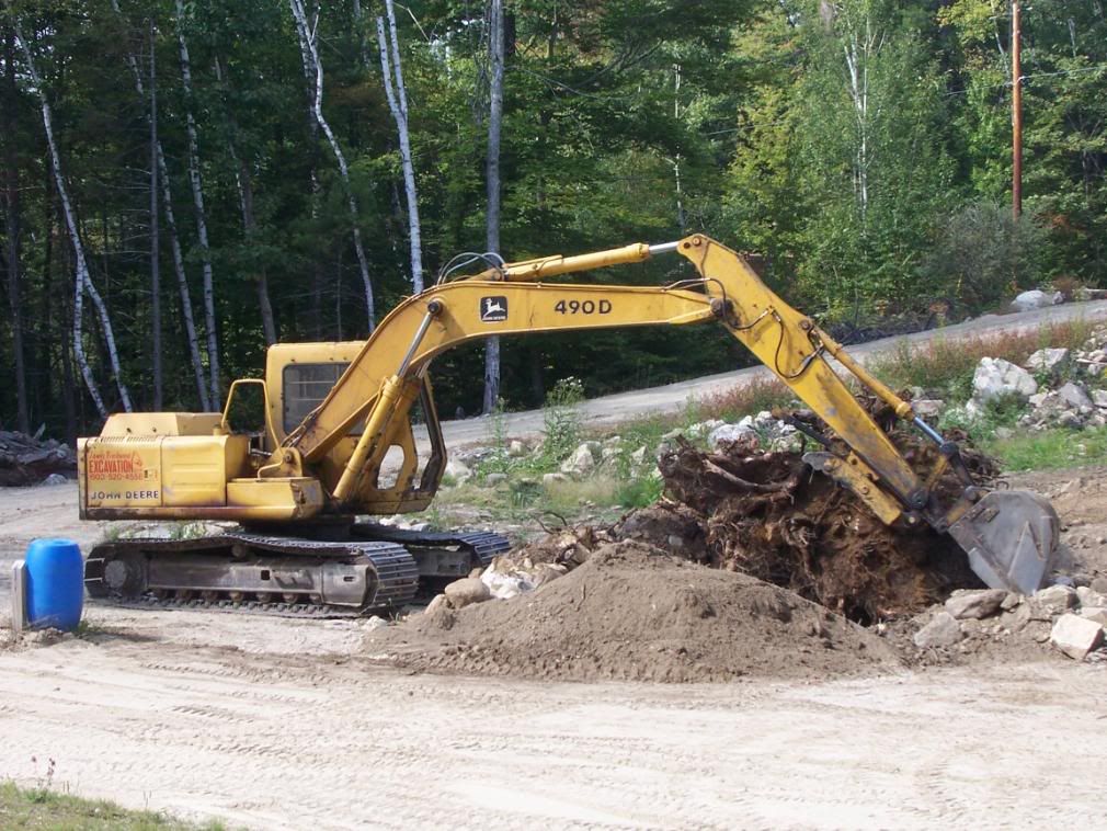

A good friend of mine brought over his excavator and made stump pulling look easy with those massive stumps.
He had fun ripping up the hill side too!
Some rocks we had to deal with.
Here is the hill side after the excavator was done and then after I cleared it up with the mighty Kioti. I am still in the process of clearing as you can see the tractor at the top. It feels incredibly stable even on such a slope.
With all that extra dirt laying around, I built a little screener with some 2x4's and chainlink fencing to sift out all the big rocks and roots. It actually worked really well.
This is pretty much what the yard looks like right now; very solid ground, good drainage, very rocky and workable slopes.
I have a boxblade to level out the rest but it does not pick up the brush and small rocks without digging into the ground. Do I need to break down and purchase a york rake for the grading or can it be done with more practice and skill with the boxblade?
