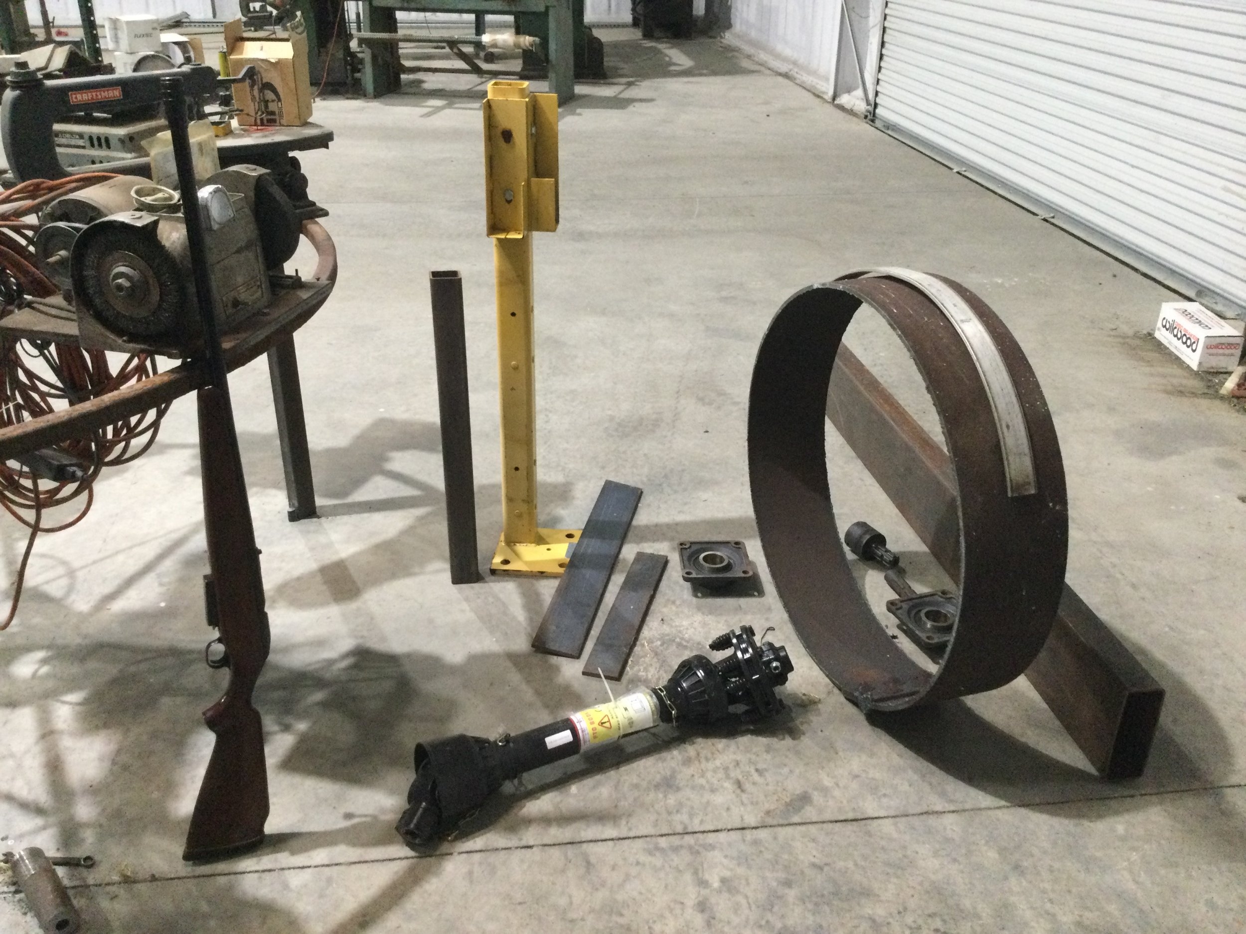

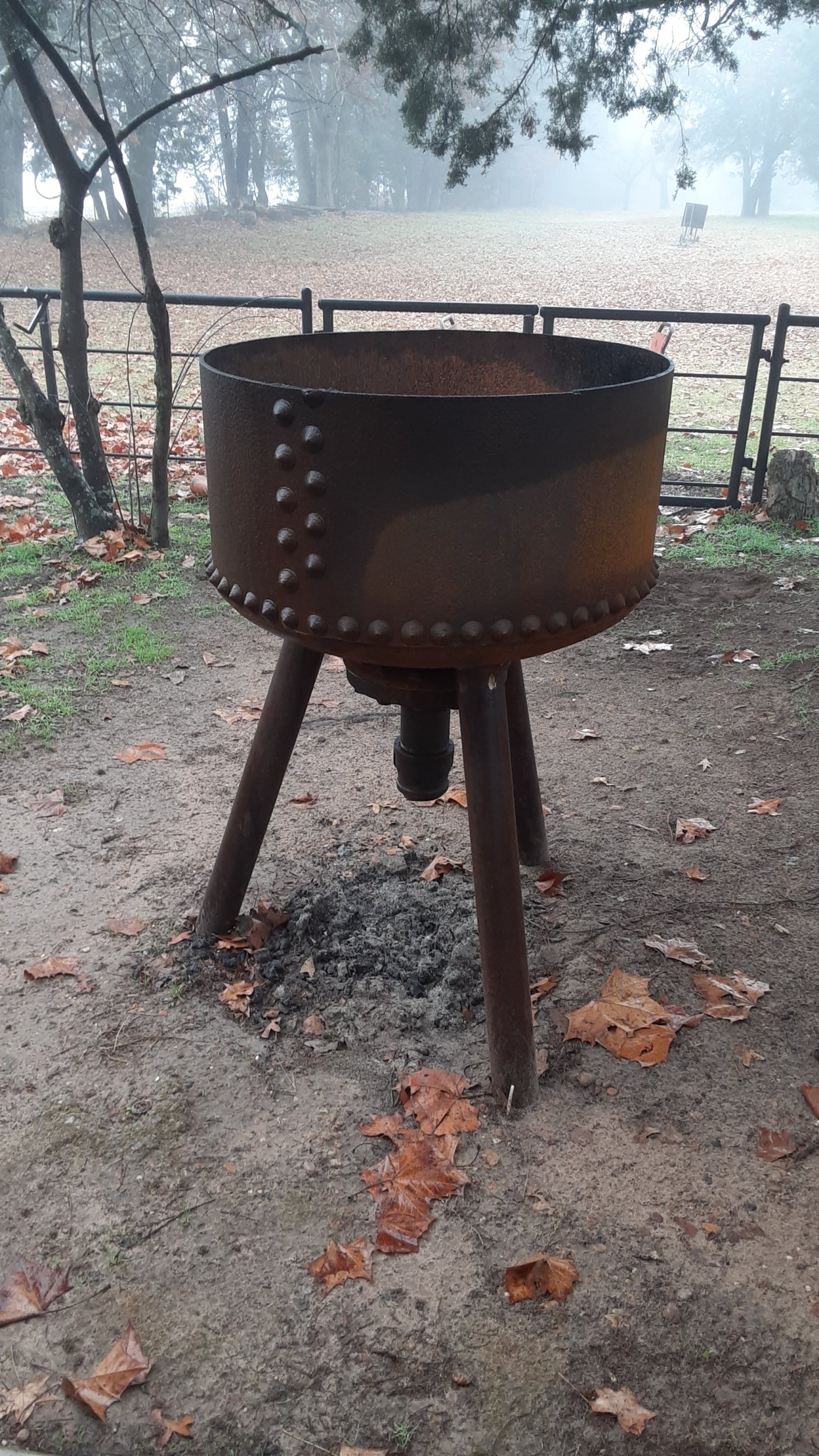

I used an 18" wide roll of sheet metal I had to go around the cylinder and line it up with itself to mark a line around it that is square, then a rolled piece of 1/4" aluminum I had as a guide. That is it on the ring I cut off, using a plasma.
I used it because my roller will only go 4" wide and the steam dome was close to what I needed and I already had it.
There was still enough of the dome left, I made an above ground "pit" myself.
