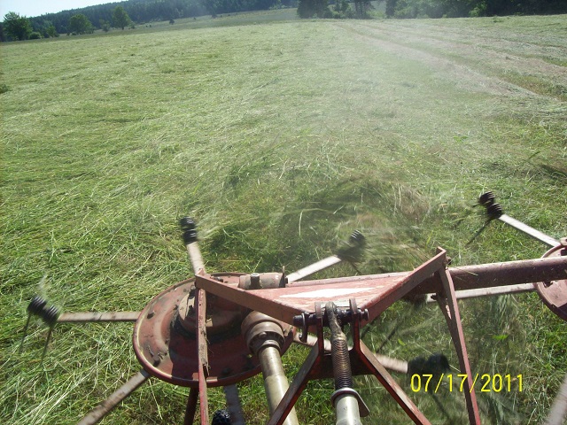

I've run a Kuhn GF22N for years, the older version of your tedder. They used to be made in 3pt or pull type, 222 only pull type now.
Are you taking TWO mower swathes at once, or straddling one windrow?
A 222 is wide enough to grab 3 swathes from a 7 foot disk mower in two passes if the mower swath wheels/boards are narrowed in. Should be easy to grab two swathes with a 2 drum mower swath. Don't worry about driving on the hay, you do that when you rake anyways.
In grass hay leaf loss isn't a big issue. I run just under PTO RPM, enough to shake out the swath.
No need for deflectors on tedder, 222 only adjusts on the tongue for tilt. I run 3pt model level side to side and tilt so tines just grabbing hay in front.
3 swathes in two passes:
   / Proper tedding operation #7
no deflector needed on a tedder. Run enough pto rpms to scattter the windrow well. Don't worry about the overlap on what hasn't been teddered yet. The whole object is to get the crop as spread out and dried ASAP. I usually liked to keep my chute on my haybines in a lil tighter if I knew I had a damp field or that I was going to tedder it the next day. The day after I mowed the field, sometime after the dew has been well burnt off, I would go back and spread the crop out as wide as possible. Don't worry about the overlap, the rake will pick it all back up.
