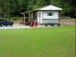

I think the rake is agreat tool. However, the area needs to be smoothed out before you can have any real success with picking rocks. I use a boxblade to smooth and then begin making passes with the rake. On the last couple of passes I adjust the angle to just skim the surface. I took some pics last week of myself raking an area I am prepping for seed. I will try to post them soon. Here is a pic of an area we already seeded a couple of weeks ago.
